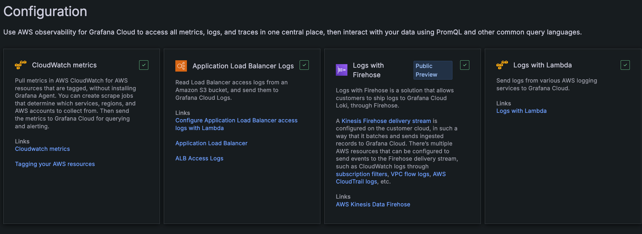

  4. At the Configuration page, find and click the Logs with Lambda tile.
    Configuration choices

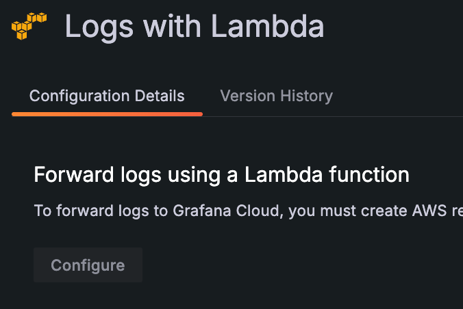

  5. Click Configure.
    **Configure** button
    Configure button
