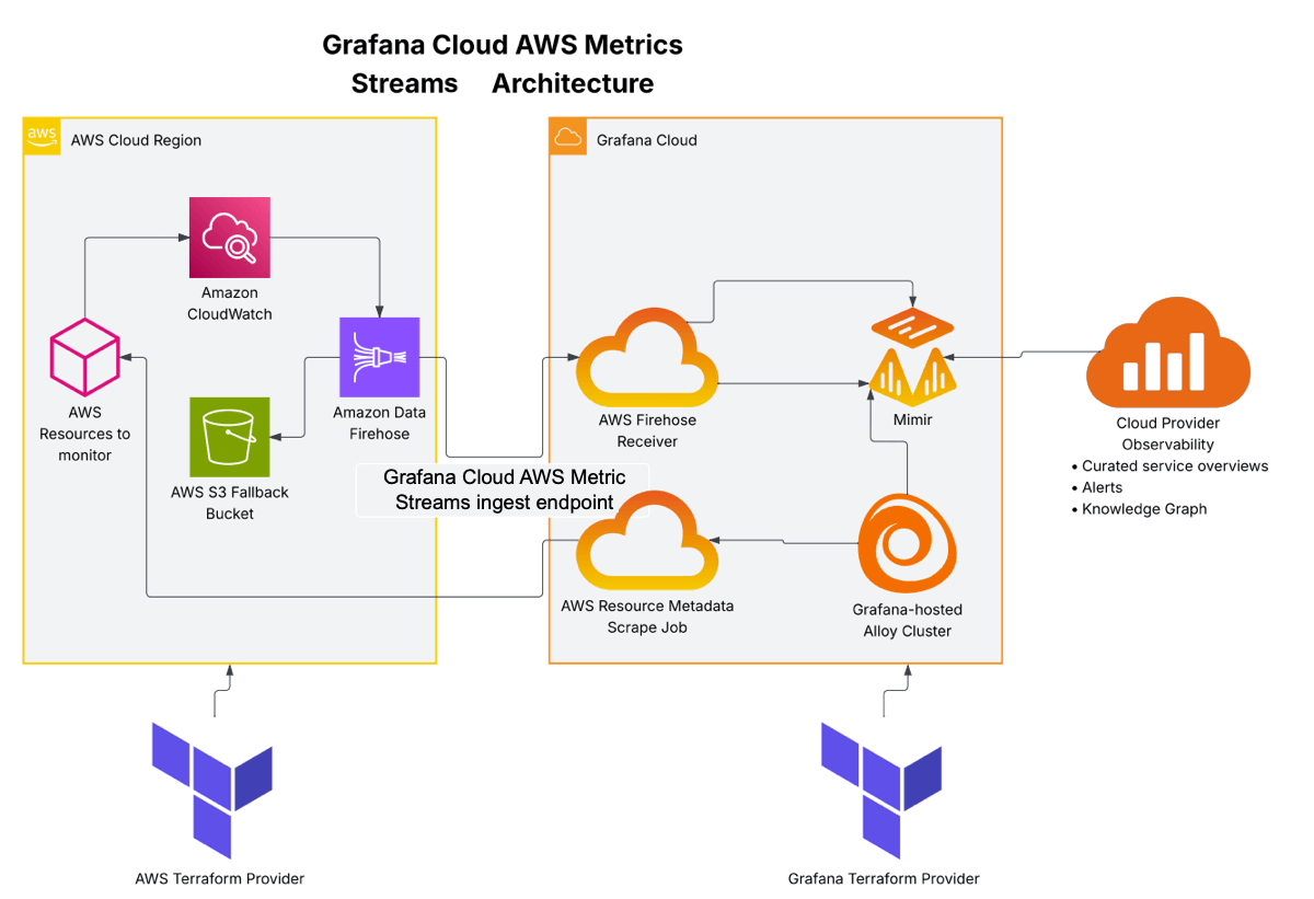

Data flow
Diagram of how AWS Metric Streams works
  1. Push raw service metrics
  2. Push filtered service metrics
  3. Backup on write failure
  4. Scrape tagged resource metadata as info metrics
  5. Collect scraped info metrics
  6. Write info metrics
  7. Read info metrics to enrich service metrics
  8. Write enriched service metrics
How it works
  1. CloudWatch continuously streams metrics to the metric stream
  2. The metric stream forwards data to Data Firehose in OpenTelemetry format
  3. Data Firehose batches and delivers metrics to your Grafana Cloud endpoint
  4. If delivery fails, Data Firehose backs up failed batches to S3
  5. The resource metadata scraper periodically fetches AWS resource tags and metadata
  6. Grafana Cloud combines metric stream data with resource metadata for rich context
