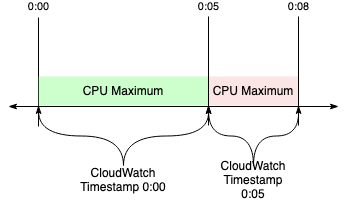

Timestamps in Grafana Cloud and CloudWatch metrics
CloudWatch metrics scrape jobs and streams set the timestamp of metrics to the time of pulling, instead of the time as reported by the metric in CloudWatch. This setting might seem counterintuitive, but its intent is to simplify the writing of alert queries. The timestamps from CloudWatch metrics always appear more delayed than they actually are.
As an example, assume you are looking at a single metric, CPU Maximum, pulled every five minutes. This leads to CloudWatch metrics pulling data with a CloudWatch period of five minutes.
CloudWatch timestamps mark the beginning of a period, not the end.
Beginning of period starts at 0:00
CloudWatch samples are visible at the beginning of a period and aggregated through the period window.
Sample aggregated through 0:08

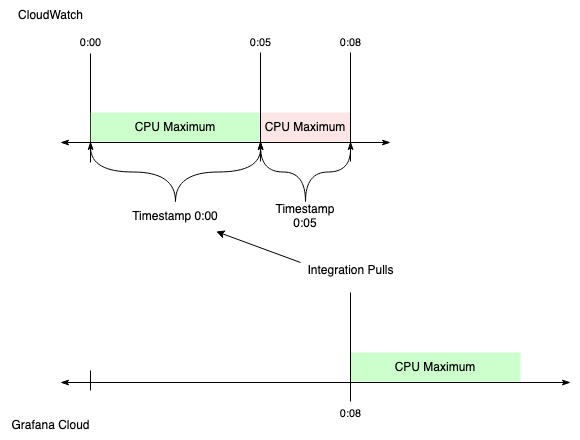

CloudWatch metrics pulls on a consistent interval, and only requests data which has been fully aggregated. This results in a Grafana Cloud timestamp of 0:08 for a metric CloudWatch stamped at 0:00.
Showing when Grafana Cloud pulls data
If the CloudWatch timestamp was used instead:
  • Metrics would appear to be eight minutes old when ingested.
  • Any alert queries written would need to consider this extra variable delay.
The pull timestamp gives the appearance of an eight-minute delay. But actually, only three minutes have passed since the value stopped being updated.
