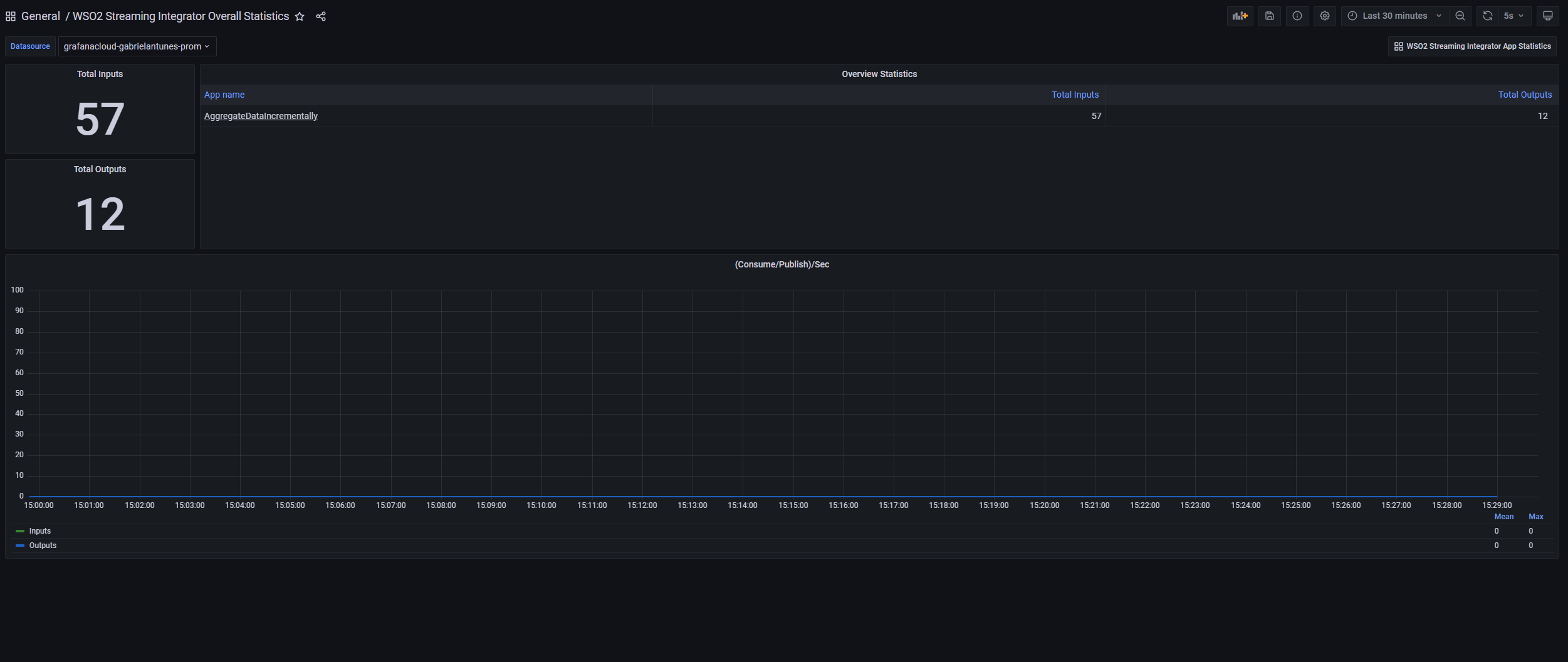

  • WSO2 Streaming Integrator Overall Statistics
WSO2 Streaming Integrator Overview

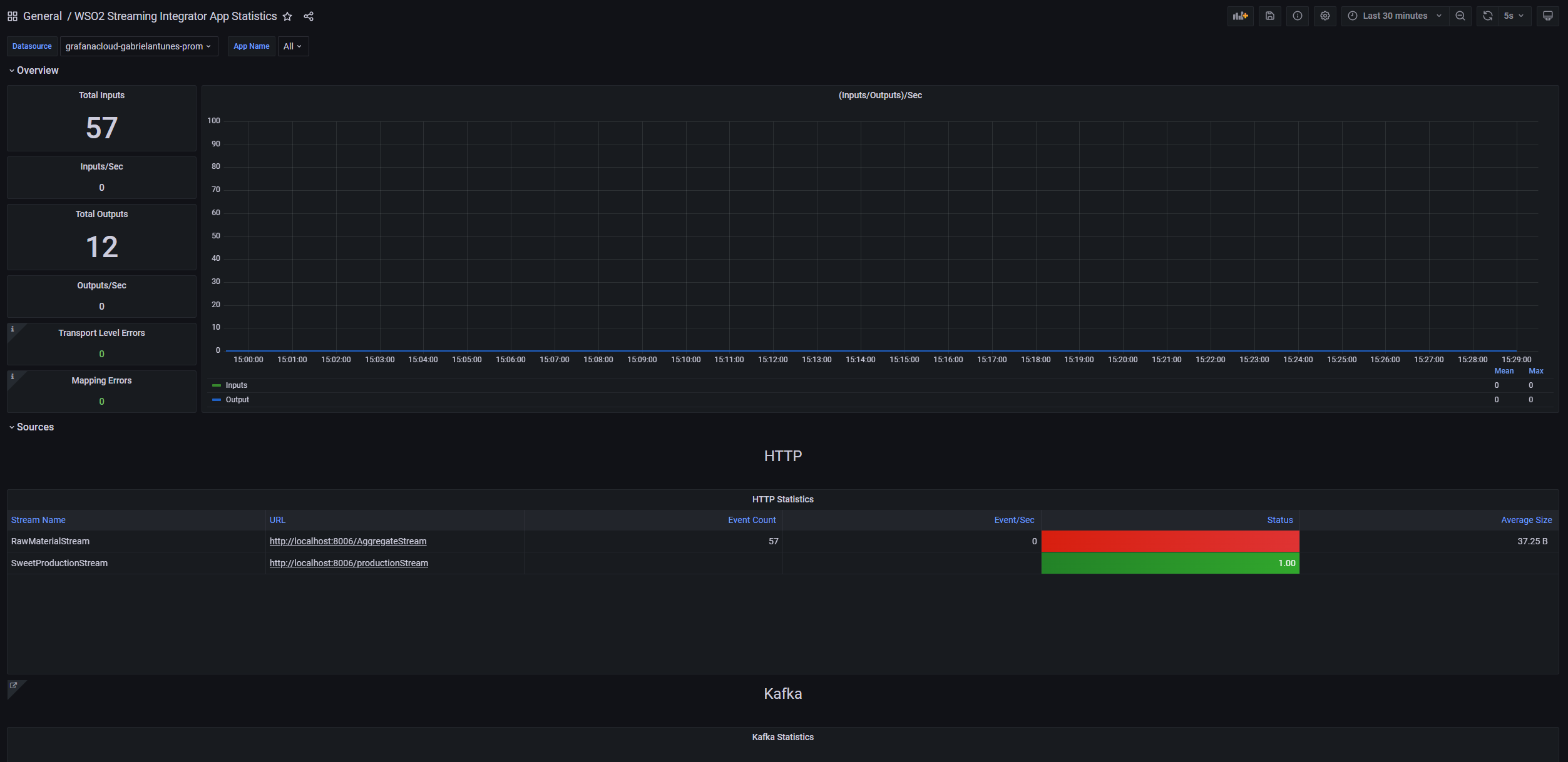

WSO2 Streaming Integrator App Overview

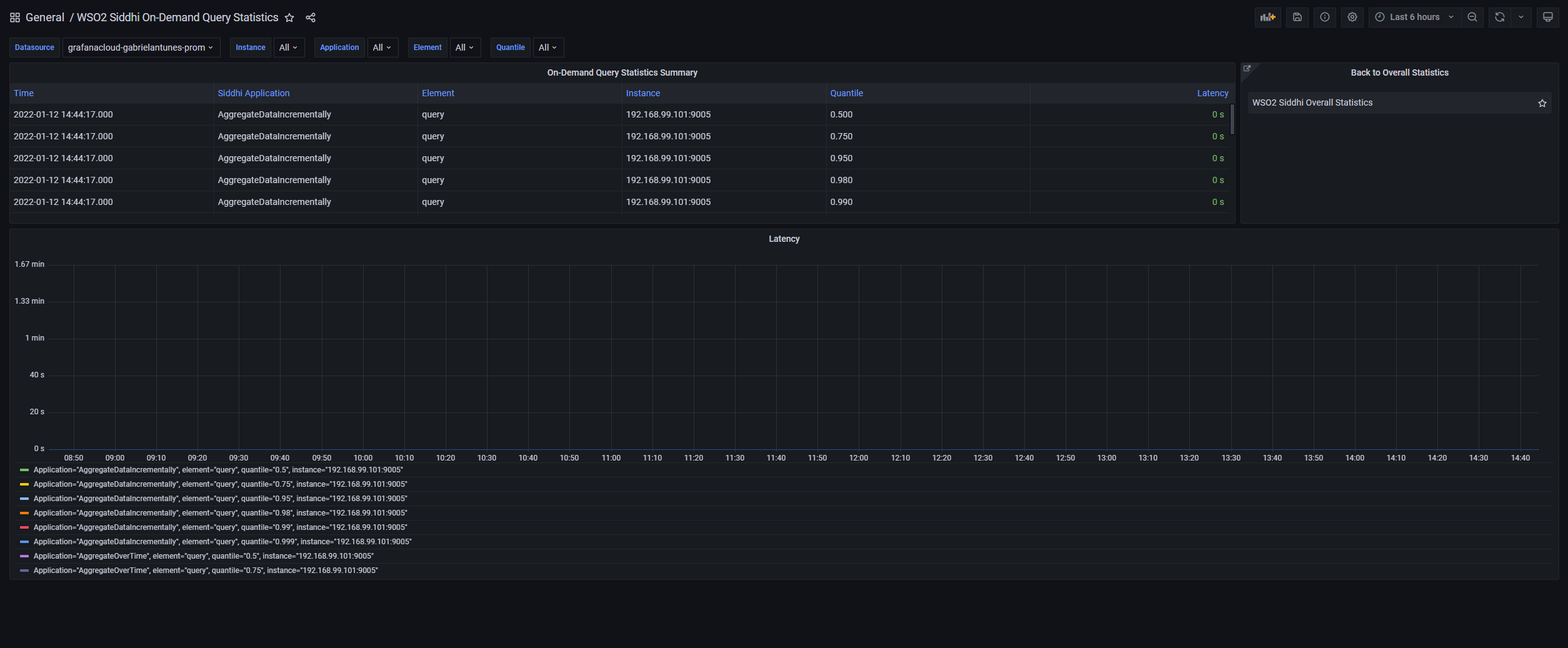

Siddhi Query Statistics
