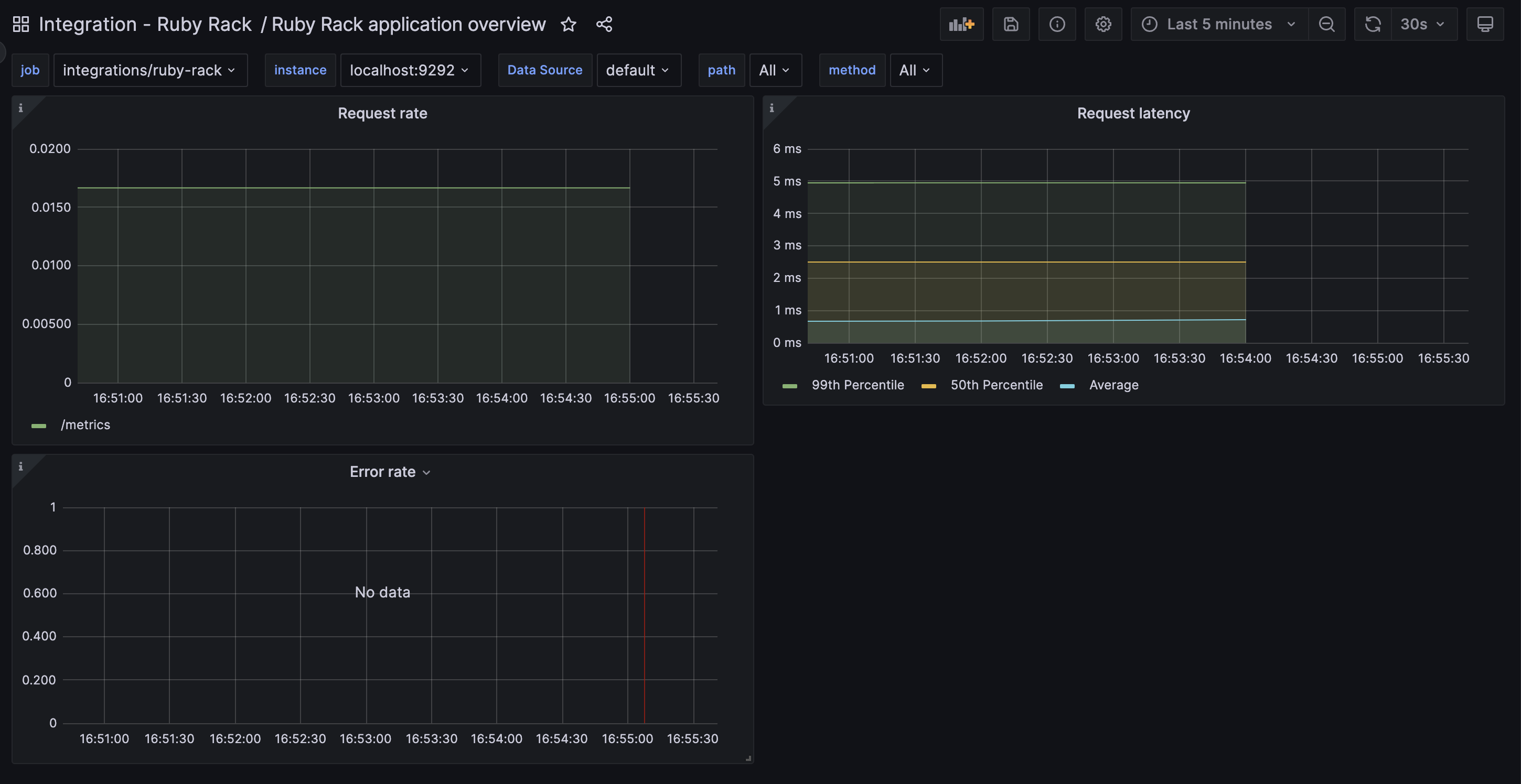

Dashboards
The Ruby Rack integration installs the following dashboards in your Grafana Cloud instance to help monitor your system.
  • Ruby Rack application overview
Ruby Rack Overview
Ruby Rack Overview
