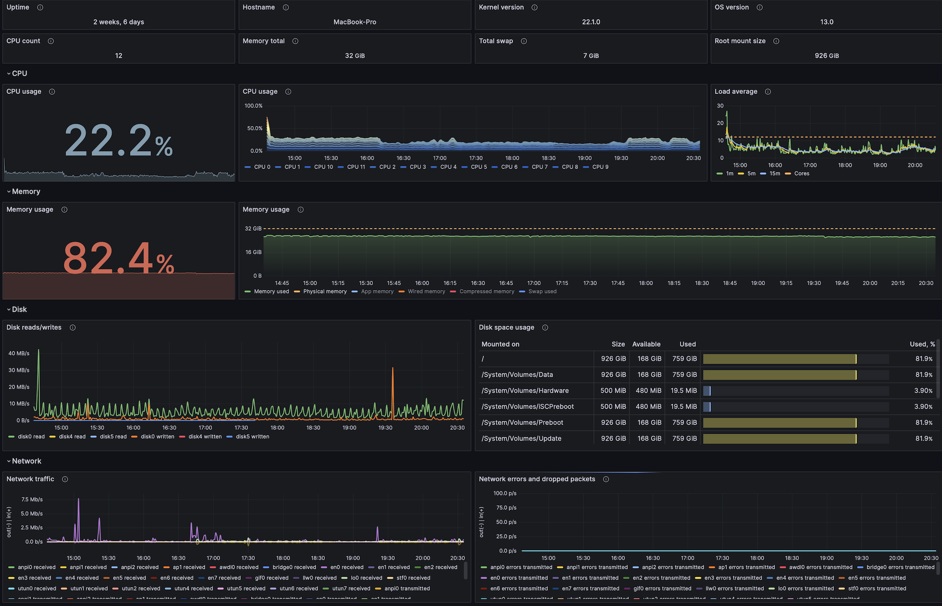

The macOS integration uses Grafana Alloy to collect metrics related to the operating system, including aspects like CPU usage, load average, memory usage, and disk and networking I/O. It also supports system logs being scraped by Alloy using promtail. An accompanying dashboard is provided to visualize these metrics and logs.
The macOS integration is based on macOS mixin, which is in fact slightly modified node-observ-lib.
This integration includes 9 useful alerts and 2 pre-built dashboards to help monitor and visualize macOS metrics and logs.

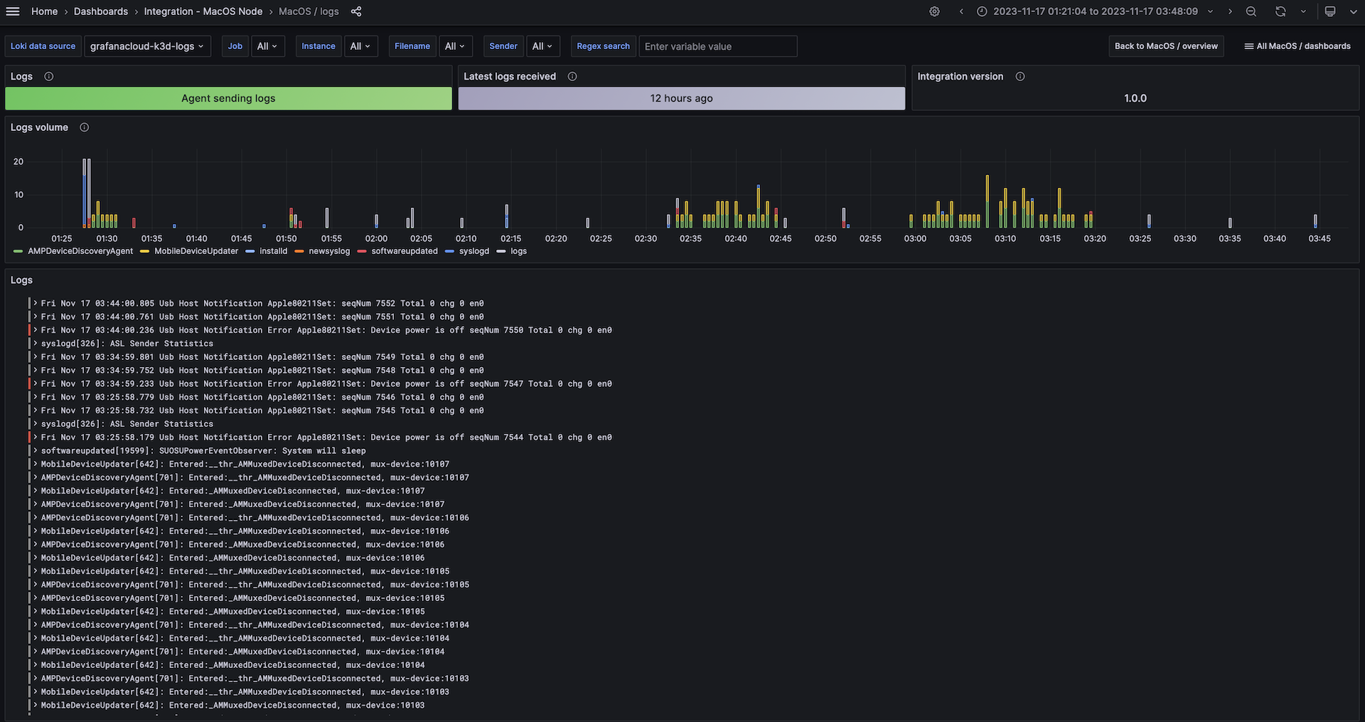

Logs snippets
darwin
local.file_match "logs_integrations_integrations_node_exporter_direct_scrape" {
path_targets = [{
__address__ = "localhost",
__path__ = "/var/log/*.log",
instance = constants.hostname,
job = "integrations/macos-node",
loki.process "logs_integrations_integrations_node_exporter_direct_scrape" {
forward_to = [loki.write.grafana_cloud_loki.receiver]
stage.multiline {
firstline = "^([\\w]{3} )?[\\w]{3} +[\\d]+ [\\d]+:[\\d]+:[\\d]+|[\\w]{4}-[\\w]{2}-[\\w]{2} [\\w]{2}:[\\w]{2}:[\\w]{2}(?:[+-][\\w]{2})?"
max_lines = 0
max_wait_time = "10s"
stage.regex {
expression = "(?P<timestamp>([\\w]{3} )?[\\w]{3} +[\\d]+ [\\d]+:[\\d]+:[\\d]+|[\\w]{4}-[\\w]{2}-[\\w]{2} [\\w]{2}:[\\w]{2}:[\\w]{2}(?:[+-][\\w]{2})?) (?P<hostname>\\S+) (?P<sender>.+?)\\[(?P<pid>\\d+)\\]:? (?P<message>(?s:.*))$"
stage.labels {
values = {
hostname = null,
pid = null,
sender = null,
stage.match {
selector = "{sender!=\"\", pid!=\"\"}"
stage.template {
source = "message"
template = "{{ .sender }}[{{ .pid }}]: {{ .message }}"
stage.label_drop {
values = ["pid"]
stage.output {
source = "message"
loki.source.file "logs_integrations_integrations_node_exporter_direct_scrape" {
targets = local.file_match.logs_integrations_integrations_node_exporter_direct_scrape.targets
forward_to = [loki.process.logs_integrations_integrations_node_exporter_direct_scrape.receiver]

Advanced logs snippets
darwin
path_targets = [{
stage.multiline {
max_lines = 0
stage.regex {
stage.labels {
values = {
hostname = null,
pid = null,
sender = null,
stage.match {
stage.template {
source = "message"
stage.label_drop {
values = ["pid"]
stage.output {
source = "message"
To monitor your macOS instance logs, you will use a combination of the following components:
local.file_match defines where to find the log file to be scraped. Change the following properties according to your environment:
__address__
: The macOS instance address__path__
: The path to the log file.instance
label:constants.hostname
sets theinstance
label to your Grafana Alloy server hostname. If that is not suitable, change it to a value uniquely identifies this macOS instance. Make sure this label value is the same for all telemetry data collected for this instance.
loki.process defines how to process logs before sending it to Loki.
loki.source.file sends logs to Loki.

Dashboards
The macOS integration installs the following dashboards in your Grafana Cloud instance to help monitor your system.
- MacOS / logs
- MacOS / overview
MacOS overview
MacOS logs
