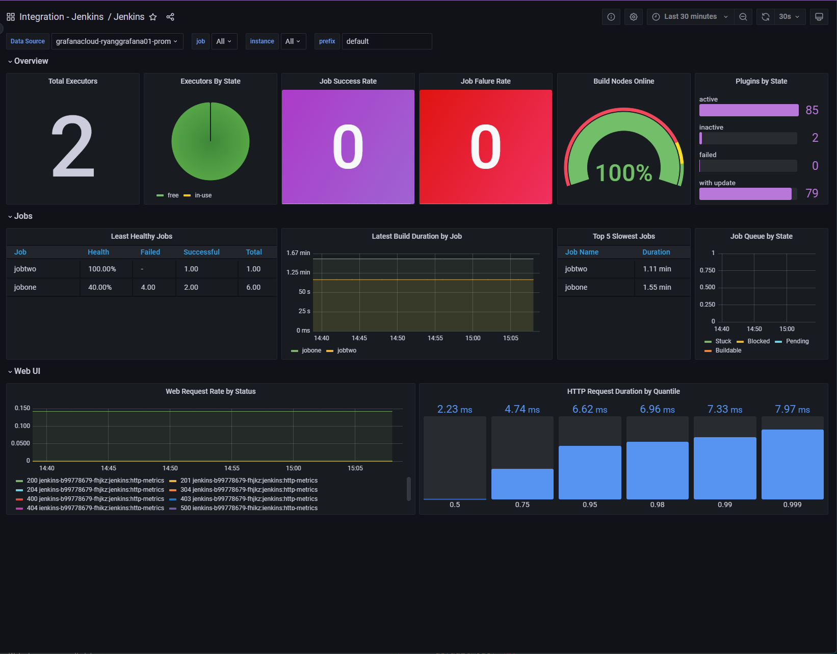

Dashboards
The Jenkins integration installs the following dashboards in your Grafana Cloud instance to help monitor your system.
- Jenkins
Jenkins overview dashboard
