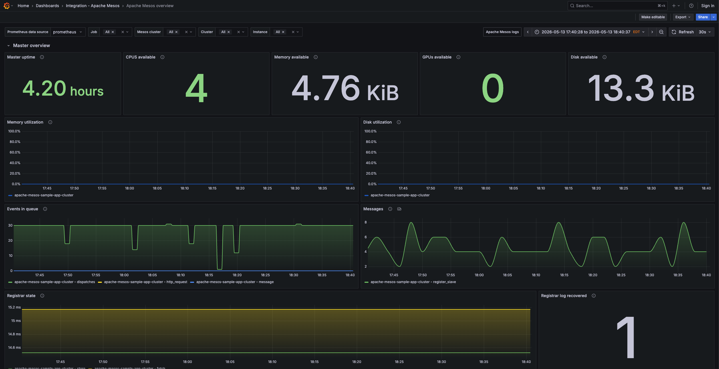

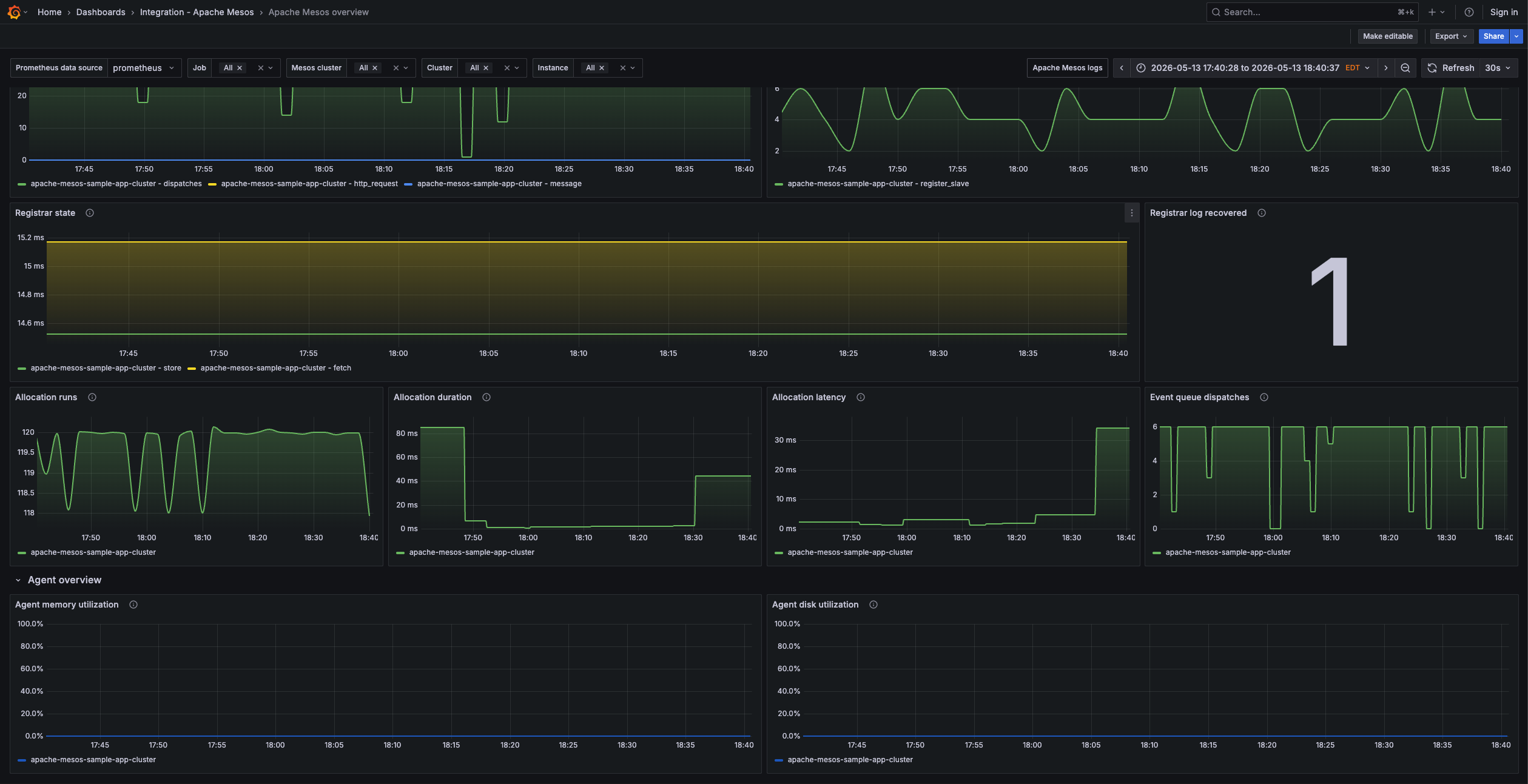

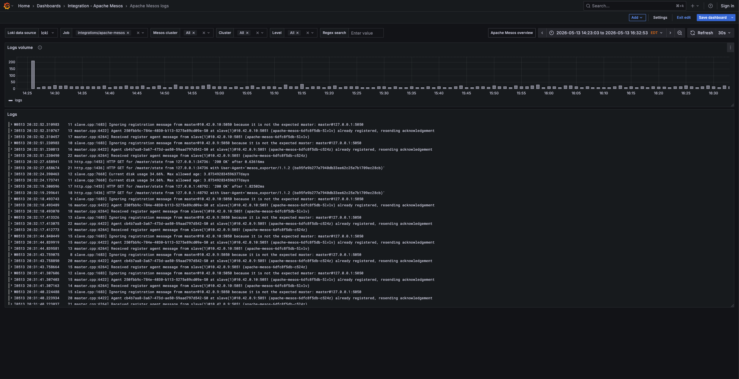

The Apache Mesos integration installs the following dashboards in your Grafana Cloud instance to help monitor your system.
- Apache Mesos logs
- Apache Mesos overview
Apache Mesos overview dashboard part 1
Apache Mesos overview dashboard part 2
Apache Mesos logs dashboard
