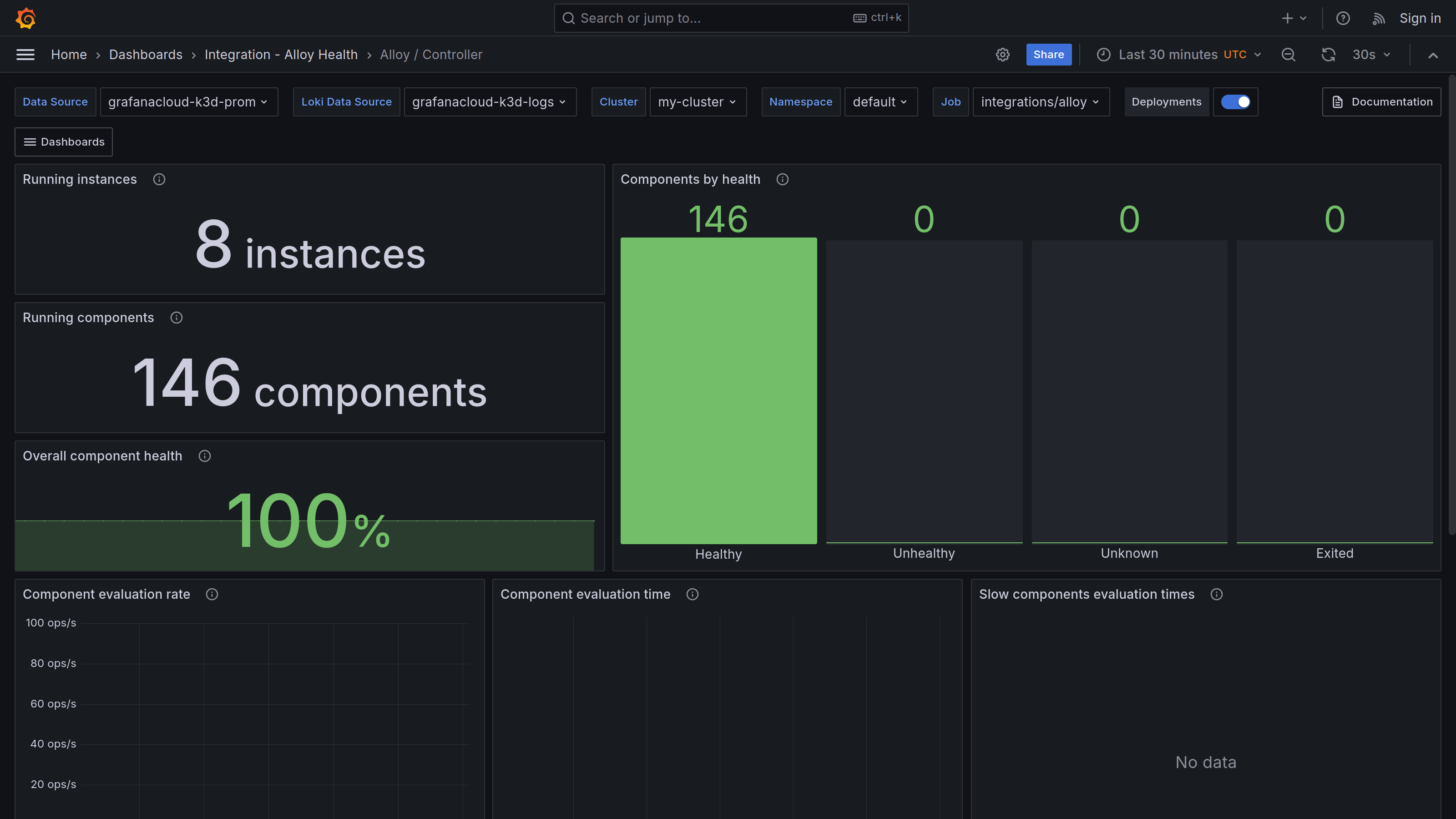

Dashboards
The Alloy Health integration installs the following dashboards in your Grafana Cloud instance to help monitor your system.
  • Alloy / Cluster Node
  • Alloy / Cluster Overview
  • Alloy / Controller
  • Alloy / Logs Overview
  • Alloy / Loki Components
  • Alloy / OpenTelemetry
  • Alloy / Prometheus Components
  • Alloy / Resources

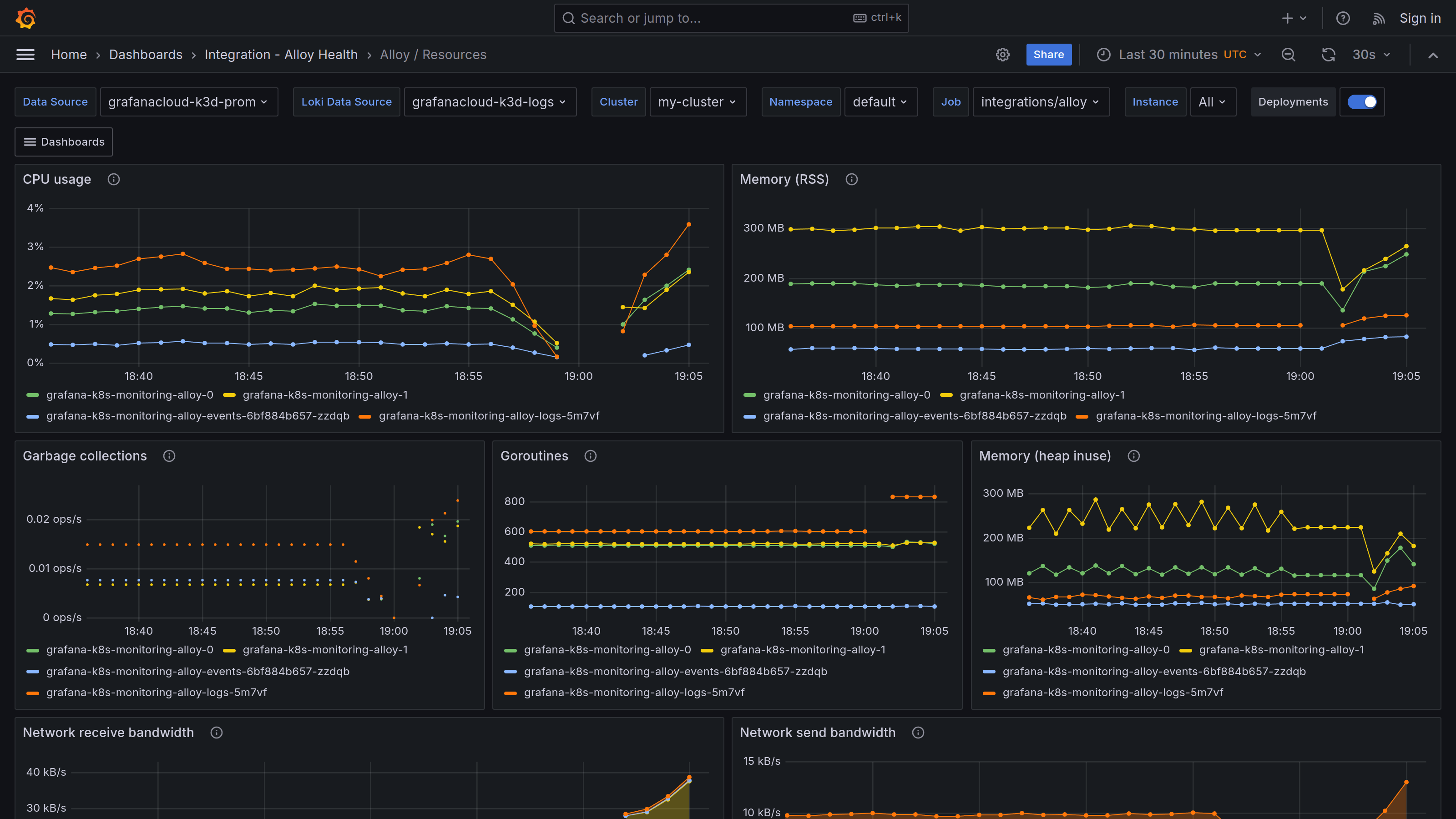

Alloy resources usage overview

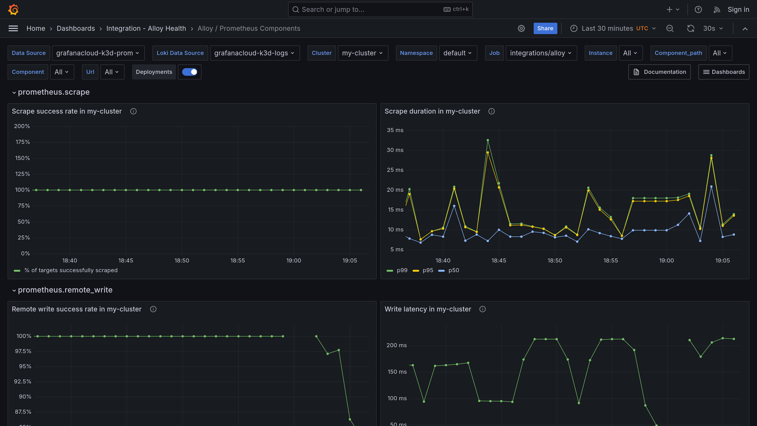

Prometheus related components overview
Overall components overview
