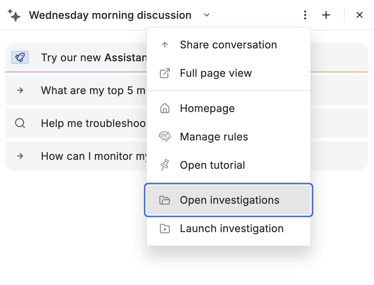

Start an investigation

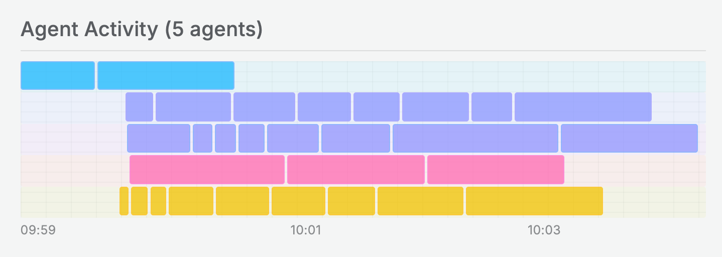

Start in Workspace and describe what you want to investigate. The Assistant gathers evidence, tests hypotheses, and writes a report while you follow progress in the conversation.
  1. Open Assistant Workspace.
  2. Start a conversation and switch the mode to Investigation.
  3. Choose a private scope or add Grafana teams that need access.

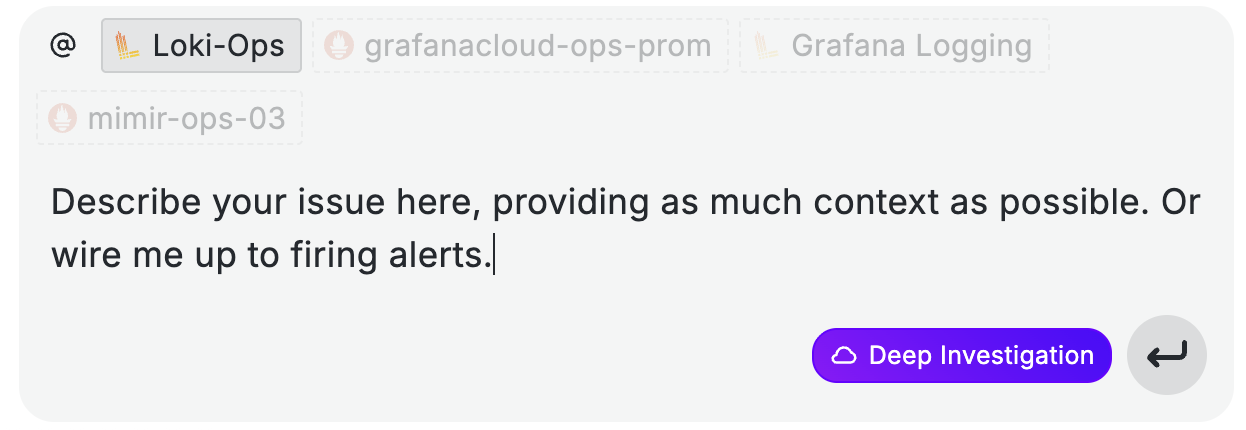

  5. Send your problem statement. Add an image, for example, a chart screenshot, when it helps explain the issue.
Include specific services and a time range, for example:
Payment latency increased between 10:00 and 10:30 UTC today. Investigate @payment-cluster and check for database locks.
You can also ask the Assistant to check public provider status pages for outages that might explain your symptoms, for example:
Did AWS or Google Cloud report any outages in the last 24 hours that could explain our checkout latency?
You can also switch to Investigation in Assistant chat before sending your first prompt, then continue in Workspace. You can change the tier for later turns; a higher tier doesn’t guarantee a correct answer or a faster investigation. Investigations respect your stack’s monthly usage limits. For details, refer to Understand Grafana Assistant pricing and usage.

Interact with a running investigation
Ask questions or redirect the investigation while it works. You don’t need to start another investigation.
