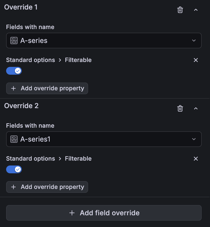

To enable this functionality, you need to add an override for every field by which you want to filter. In the override:
  • Select a field name.
  • Add the Standard options > Cross-filter override property.
  • Enable the Cross-filter switch to allow viewers to update dashboard filters by interacting with the panel.
You can also do this programmatically by returning the data frame with the appropriate filterable property on the desired fields.
For provisioned dashboards, Cross-filter uses the JSON property ID filterable. For example, add the following override to the panel’s fieldConfig.overrides array to enable filtering from the service field:
JSON
  "matcher": { "id": "byName", "options": "service" },
  "properties": [{ "id": "filterable", "value": true }]
Replace service with the name of the field you want to filter by. This requires a supported visualization and data source support for dashboard filters. The standard filterable property updates dashboard filters.
