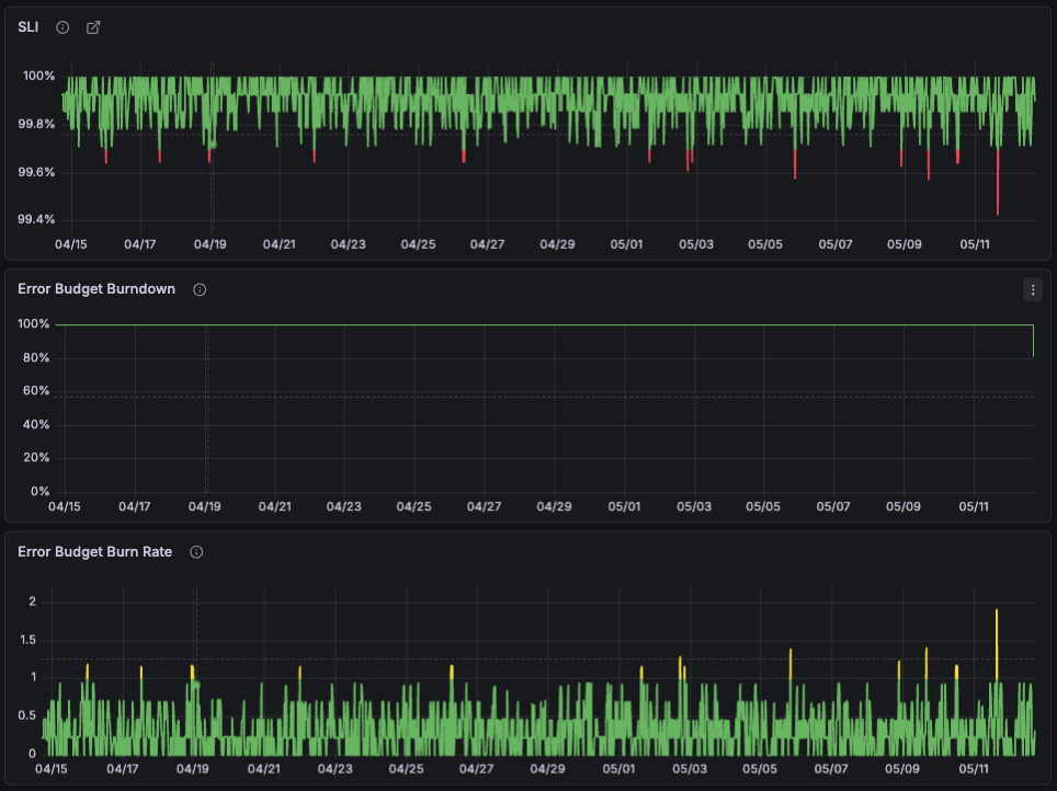

The error budget is not updated
The Error Budget Burndown, Remaining Error Budget stat, and SLI stat panels might not display accurate values until the first SLO time window has elapsed.
These panels query recorded metrics (grafana_slo_*) that are initialized when you create the SLO. Recording rules collect data only from the time the SLO is created and do not backfill historical data. As a result, the panels report fully accurate results only after the recording rules have collected data for the entire SLO time window.
For example, for a 7-day SLO, the Error Budget Burndown panel can stay flat during the first 7 days after creation, even though the SLI and Error Budget Burn Rate panels already indicate that the error budget is being consumed.
Screenshot of the error budget burndown not being updated
