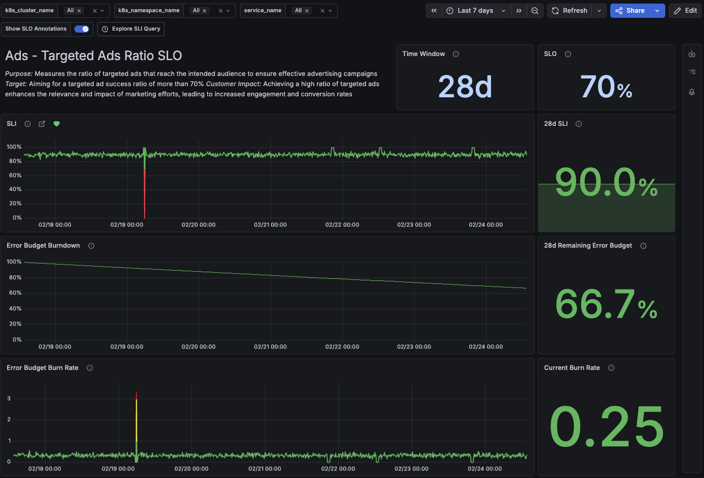

At the top of the dashboard, you can review the SLO configuration, including its name, description, time window, and objective.
Screenshot of the SLO dashboard in Grafana Cloud

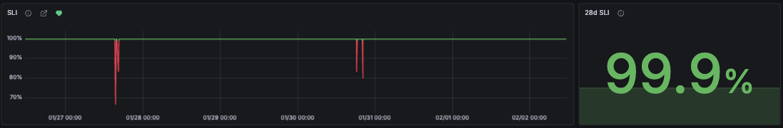

The SLI panel shows how the SLI value changes over time for the selected time range. The chart reflects the period currently selected in the time picker.
When the SLI drops below the SLO objective, the chart highlights these intervals in red to quickly identify when the SLO was not met.
SLI chart and stat panel showing current and historical SLI values
On the right side, the SLI stat panel displays the average SLI value over the entire SLO time window, expressed as a percentage. The panel name reflects the SLO time window (for example, 28d SLI).
The stat panel value depends on the selected time range and is calculated based on the To timestamp, querying the interval [To − SLO time window, To].

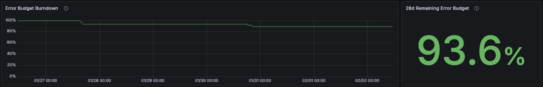

The Error Budget Burndown panel shows how the remaining error budget changes over the selected time range.
The Error Budget Burndown panel calculates the error budget over the selected time range. This allows you to zoom in on specific periods to analyze how the error budget was consumed during that interval. Note the following:
  • The selected time range can be shorter than the SLO time window. In this case, the values shown in the panel may not be representative of the full SLO evaluation period.
  • For new SLOs, the panel shows a gap for time before the SLO was created. That period is not included in the error budget calculation.
On the right side, the Remaining Error Budget stat panel calculates the remaining error budget over the SLO time window.
  • Selecting a shorter time range does not change the SLO time window used by the stat panel.
  • The value is calculated using the To timestamp of the selected time range, querying the interval [To − SLO time window, To].

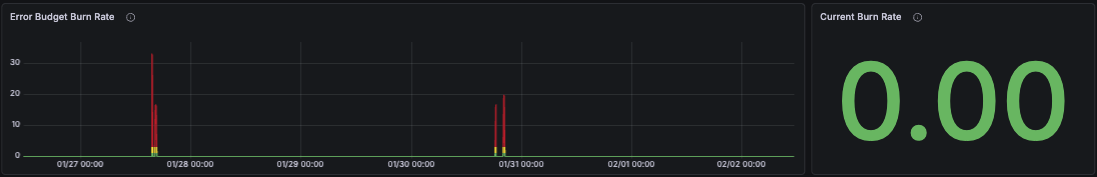

The burn rate metric indicates how quickly the error budget is being consumed. A burn rate of 1 means that, at the current error rate, the error budget would be fully consumed over the SLO time window.
The Error Budget Burn Rate panel shows how the burn rate changes over time for the selected time range.
Error budget burn rate chart and current burn rate stat panel
This chart uses different colors to represent various burn rate levels. It helps identify periods of elevated burn that may indicate incidents or abnormal behavior.
On the right side, the Current Burn Rate stat panel displays the error budget burn rate calculated at the To timestamp of the selected time range. This value represents the burn rate at that point in time.

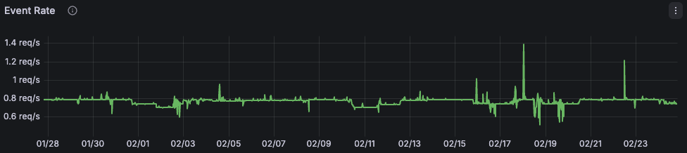

The Event rate chart is shown only for event-based SLIs and display the rate at which events are evaluated over the selected time range.
Event rate chart for event-based SLOs
Analyzing the event rate can help interpret SLO performance.
In event-based SLIs, each event contributes equally to error budget consumption across the entire SLO time window.
For example, a high-traffic period with a low error ratio can consume the error budget faster than a low-traffic period with a higher error ratio.
Because event-based SLOs are directly affected by event volume, the event rate provides important context for understanding error budget consumption. When used together with the error budget panels, the event rate chart helps explain why the error budget is consumed more quickly during specific high-traffic periods. Hovering over any of these charts allows you to correlate changes in traffic with changes in error budget consumption.

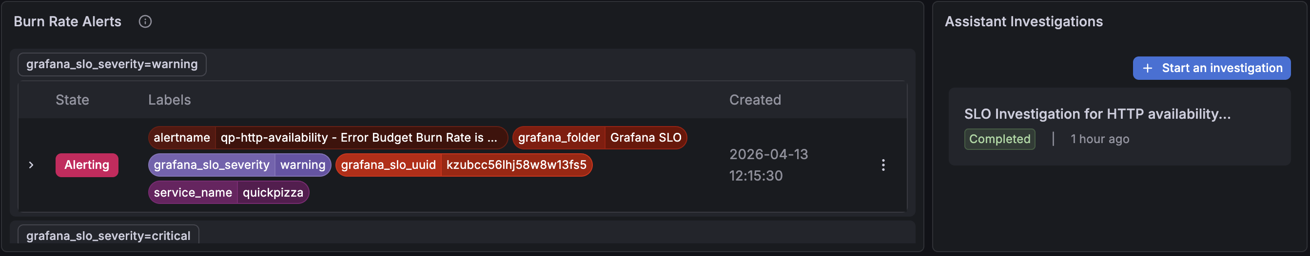

When SLO alert rules are enabled, the SLO dashboard displays the Burn Rate Alerts panel, which shows the state of fast-burn and slow-burn alerts. On the right side, you can find assistant investigations triggered by SLO alerts or started manually with Start an investigation.
The SLO dashboard showing the state of burn-rate alerts and investigations

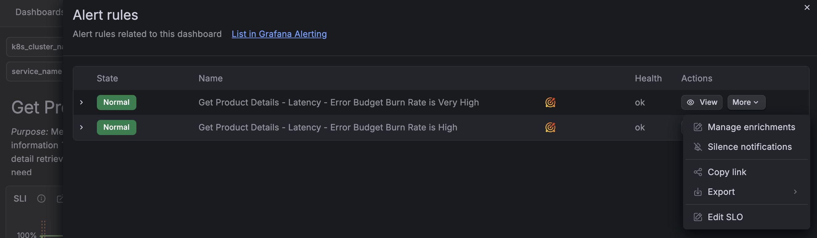

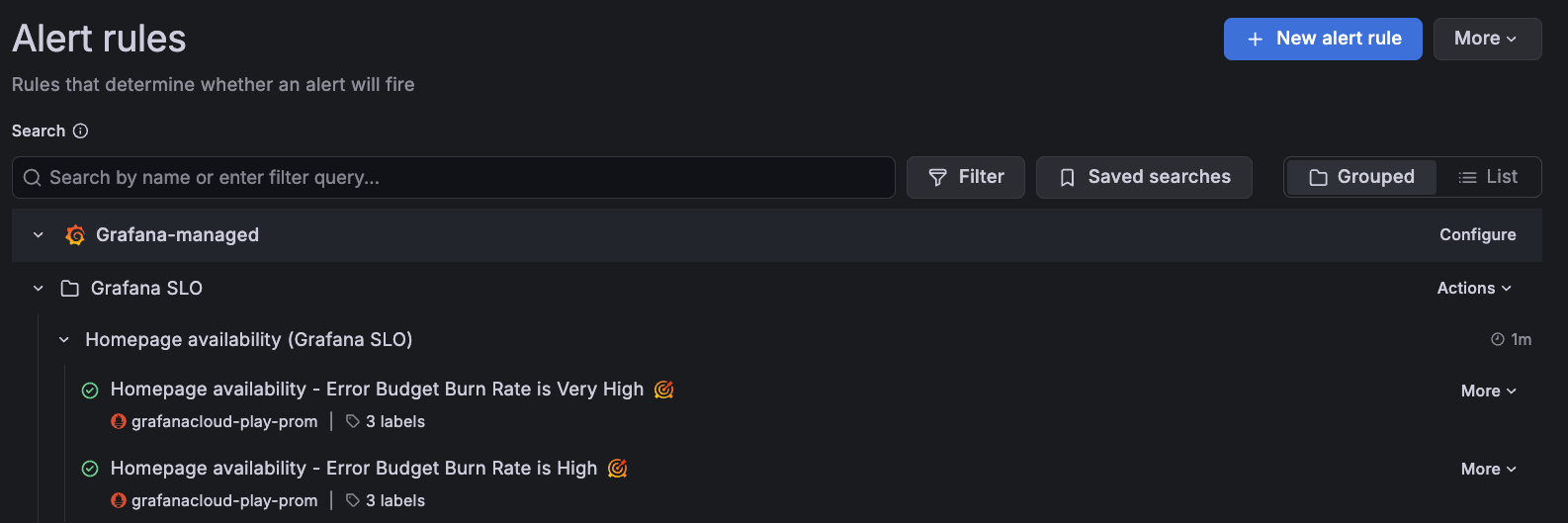

You can also find the SLO alert rules in the Alert rules view under the selected SLO folder in Grafana Alerting.
Alert rules list in Grafana Alerting displaying SLO alert rules
