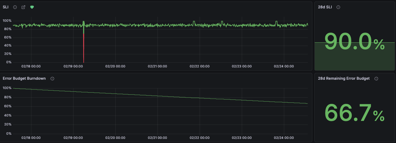

Service level indicator and error budget performance
Defining the SLO objective aligns the team around a shared target and determines when accumulated degradation is severe enough to require action. This is frequently the hardest part. Expect a few iterations before the objective reflects reality.

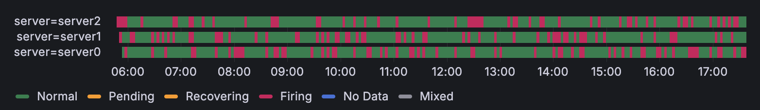

The alert fires and resolves without human intervention, a pattern commonly referred to as flapping.
Alert instance states for a flapping alert
Alerting best practices recommend tuning away flapping alerts by tweaking alert rule settings to avoid detecting short spikes and transient issues. Tuning reduces noise, but can remove the signal entirely.
Alert instance states after mitigating flapping behavior
In this case, the flapping alert has surfaced a reliability issue. Individual firings look harmless, but the accumulated degradation over time impacts users. A threshold-based alert can mask these errors.

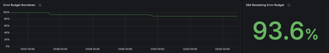

The SLO error budget captures this pattern. Each transient failure consumes a fraction of the budget, making cumulative impact visible over the SLO window.
Error budget burndown
This pattern isn’t limited to flapping alerts. Any alert with acceptable transient failures faces the same tradeoff: tune for less noise and lose visibility, or keep the alert and learn to ignore it.
Tracking reliability signals in dashboards and alerting on long evaluation periods can be the solution. SLOs are the better fit: the error budget doesn’t reset and tracks every failure within the SLO window.
