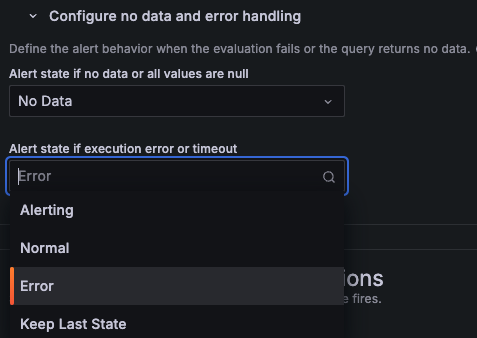

Handle query errors in Grafana Alerting
Not all connectivity issues come from targets going offline. Sometimes, the alert rule fails when querying its target. These aren’t availability problems—they’re query execution errors: maybe the data source timed out, the network dropped, or the query was invalid.
These errors lead to broken alerts. But they come from a different part of the stack: between the alert rule and the data source, not between the data source (for example, Prometheus) and its target.
This difference matters. Availability issues are typically handled using metrics like up
or probe_success
but execution errors require a different setup.
Grafana Alerting has built-in handling for execution errors, regardless of the data source. That includes Prometheus, and others like Graphite, InfluxDB, PostgreSQL, etc. By default, Grafana Alerting automatically handles query errors so you don’t miss critical failures. When an alert rule fails to execute, Grafana fires a special DatasourceError
alert.
You can configure this behavior depending on how critical the alert is and on whether you already have other alerts detecting the issue. In Configure no data and error handling, click Alert state if execution error or timeout, and choose the desired option for the alert:
Error (default): Triggers a separate
DatasourceError
alert. This default ensures alert rules always inform about query errors but can create noise.Alerting: Treats the error as if the alert condition is firing. Grafana transitions all existing instances for that rule to the
Alerting
state.Normal: Ignores the query error and transitions all alert instances to the
Normal
state. This is useful if the error isn’t critical or if you already have other alerts detecting connectivity issues.Keep Last State: Keeps the previous state until the query succeeds again. Suitable for unstable environments to avoid flapping alerts.
This applies even when alert rules query Prometheus itself—not just external data sources.
