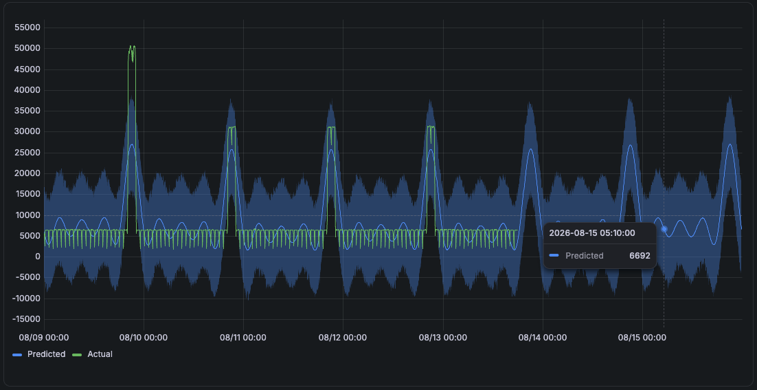

The traffic forecast in this example tracks the total number of HTTP requests per minute:
promql
sum(rate(http_requests_total[$__rate_interval]) * 60)
Traffic often follows recurring patterns, such as daily or weekly usage cycles. Forecasting request volume can help you understand seasonal demand, identify unusual changes, and anticipate periods of higher or lower traffic.
A screenshot of the request rate forecast.
This example also demonstrates that a useful forecast doesn’t always need an alert. An unexpected increase or decrease in traffic isn’t necessarily a problem by itself. If a traffic change degrades the system, alerts based on symptoms such as latency or errors can detect the impact.
Use the traffic forecast as additional context to understand demand patterns and determine whether an unexpected change requires further investigation.

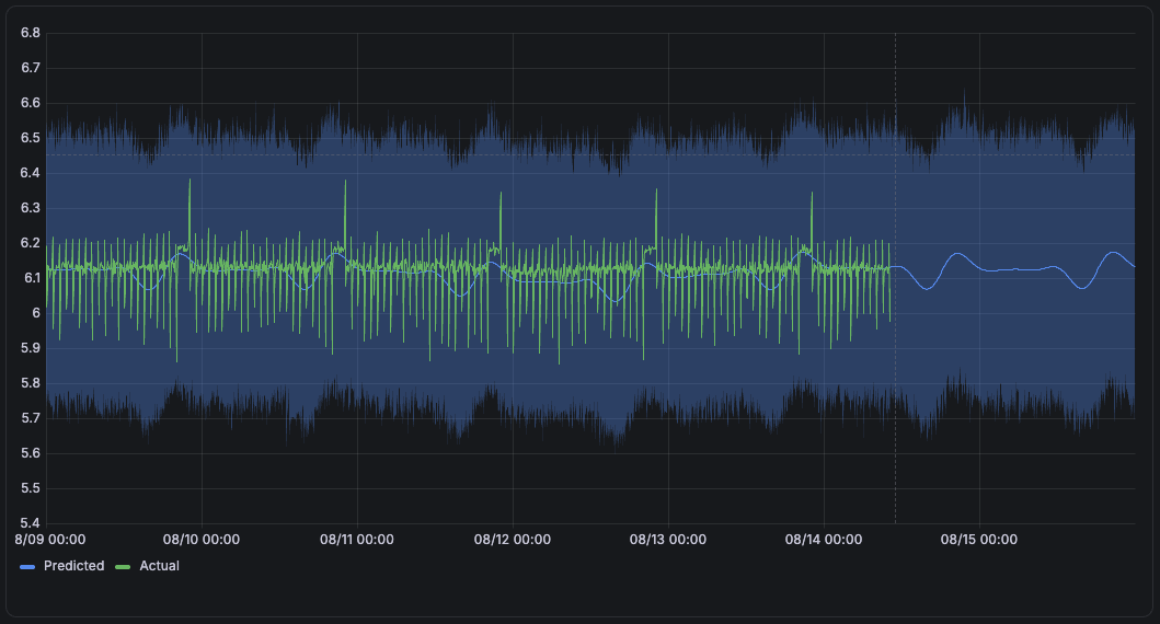

A screenshot of a success ratio forecast.
In the demo application, the ratio represents the percentage of incoming HTTP requests that produce a successful recommendation.
A sustained decrease can indicate that the recommendation service is producing fewer recommendations than expected, even when the overall request rate remains normal. This makes the ratio useful for detecting changes in application behavior that are not visible from traffic volume alone.

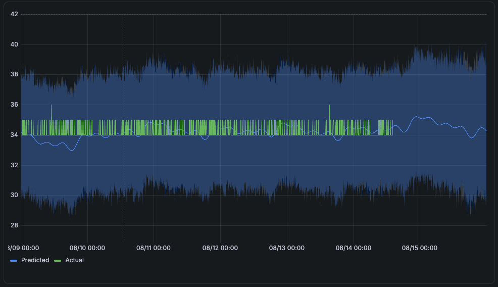

Forecast database utilization
This forecast tracks PostgreSQL connection usage as a percentage of the configured connection limit.
promql
100 * sum(pg_stat_activity_count)
sum(pg_settings_max_connections)
A screenshot of a DB utilization forecast.

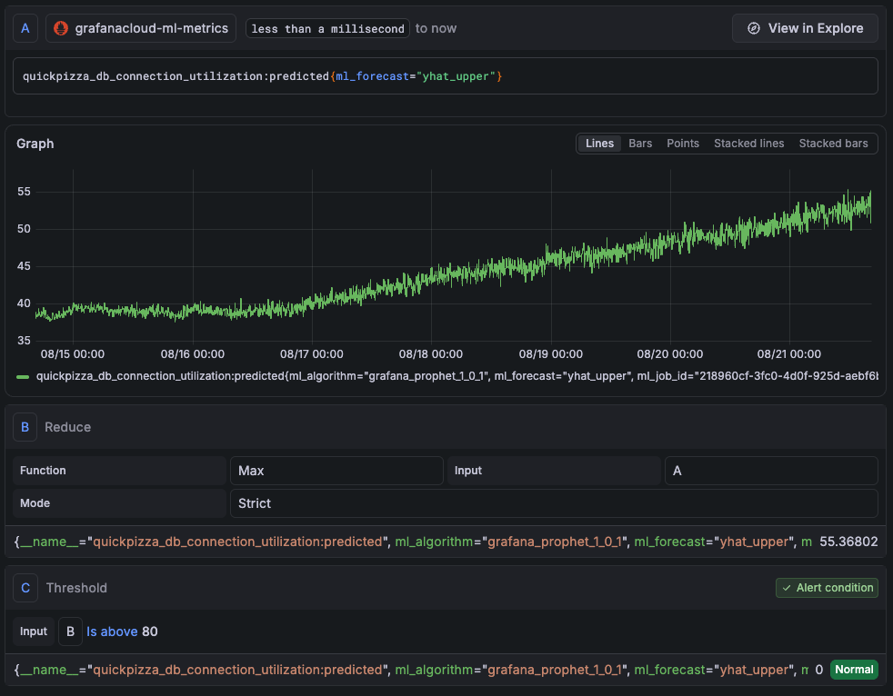

This example demonstrates capacity planning for a bounded resource. Instead of waiting until connection utilization reaches a critical threshold, you can use the forecast to detect if the database is expected to reach that threshold in the future.
  1. The forecast uses 30 days of training data, which provides up to 15 days of future forecasted data.
  2. The alert queries the forecast over the next 7 days.
A screenshot of a DB utilization alert forecast.
In this example, the alert queries the upper forecast bound over the next 7 days and returns its maximum value. The alert fires if the upper forecast bound is expected to exceed 80% at any point during the seven-day window.
maximum `yhat_upper` over the next 7 days > 80%
The alert queries the upper forecast bound (:predicted{ml_forecast="yhat_upper"}) to account for prediction uncertainty.

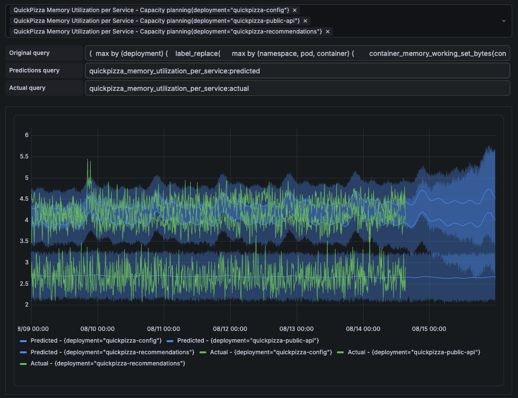

Forecast memory utilization per service
This forecast predicts memory utilization across multiple Kubernetes Deployments.
This is a multidimensional forecast: a single forecast definition produces a separate forecast for each dimension ({deployment="$service-name"}).
Each forecasted series represents memory utilization for a particular service (Kubernetes Deployment) and is independent of the other services.
A screenshot of a multidimensional memory utilization forecast.

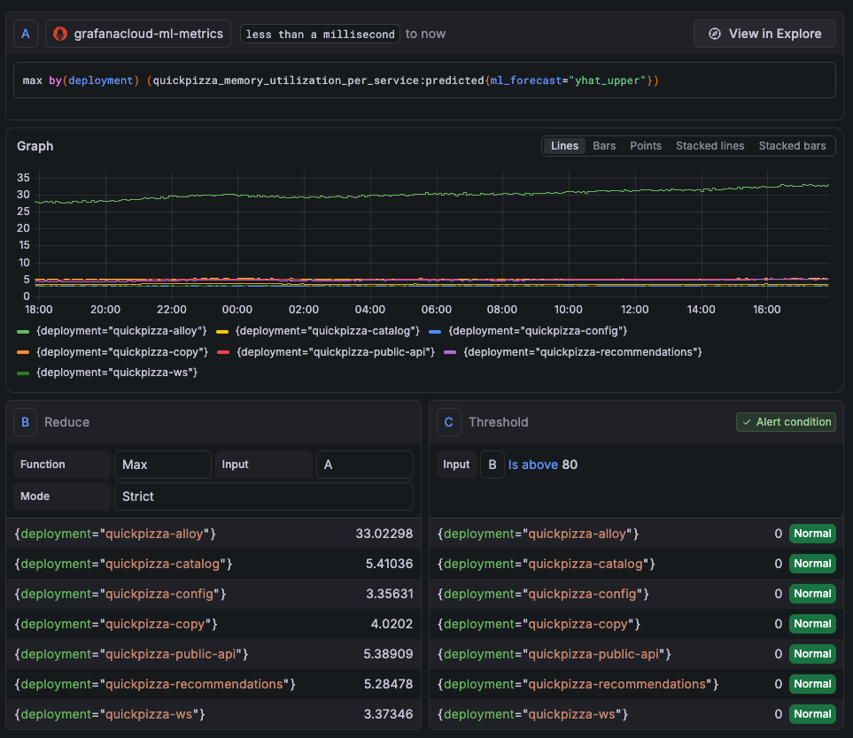

The main difference from the previous example is that this is a multidimensional forecast. A separate forecast is created for each dimension ({deployment="$service-name"}).
The alert rule is also multidimensional, so each service produces a separate alert instance. Each alert instance is associated with a particular service and evaluates that service’s independent forecast.
A screenshot of a multidimensional alert rule for future memory capacity.
This pattern lets you monitor future capacity across multiple services with a single multidimensional forecast.
