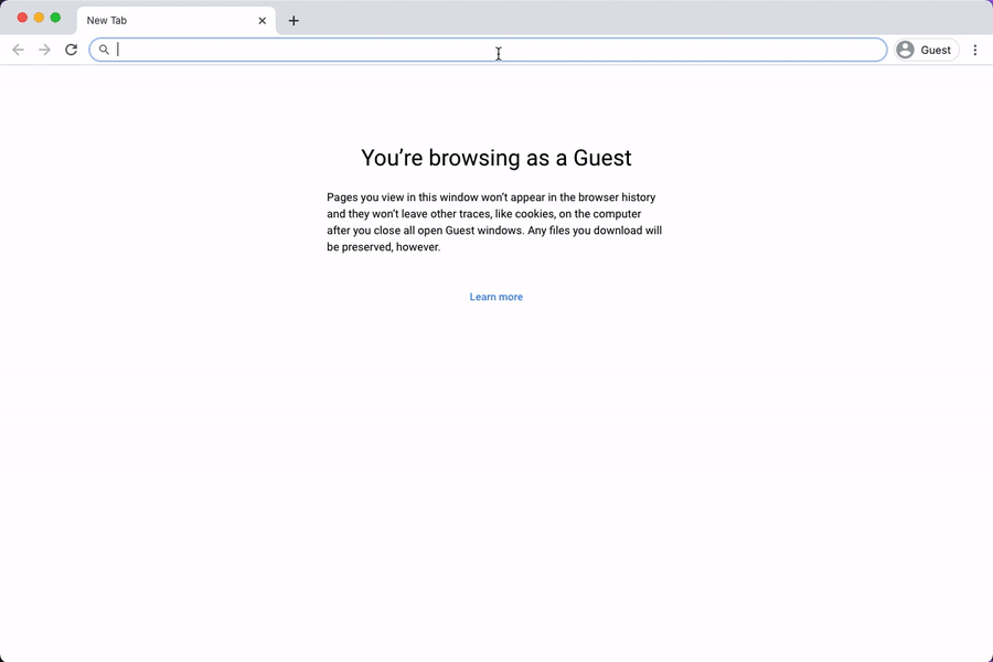

Then you can navigate to the minio admin console using your browser. The login credentials are the same as those set above, minio and minio123.
minio-in-browser
