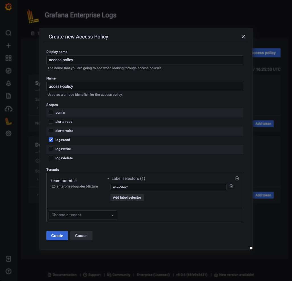

  1. Click the Create access policy button.
  2. Fill in the Display name field with the access policy name.
  3. Select the logs:read scope.
  4. Select a tenant.
  5. Click the Add label selector button and add a label selector.
  6. Click the Create button.

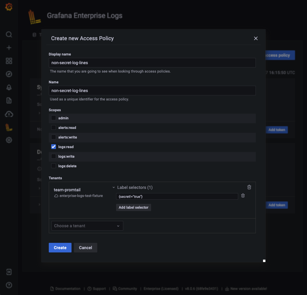

Exclude a label
One common use case for creating an LBAC policy is to exclude logs that have a specific label. For example, you can create a label policy that excludes all log lines with the label secret=true by adding a selector with secret!="true" when you create an access policy:

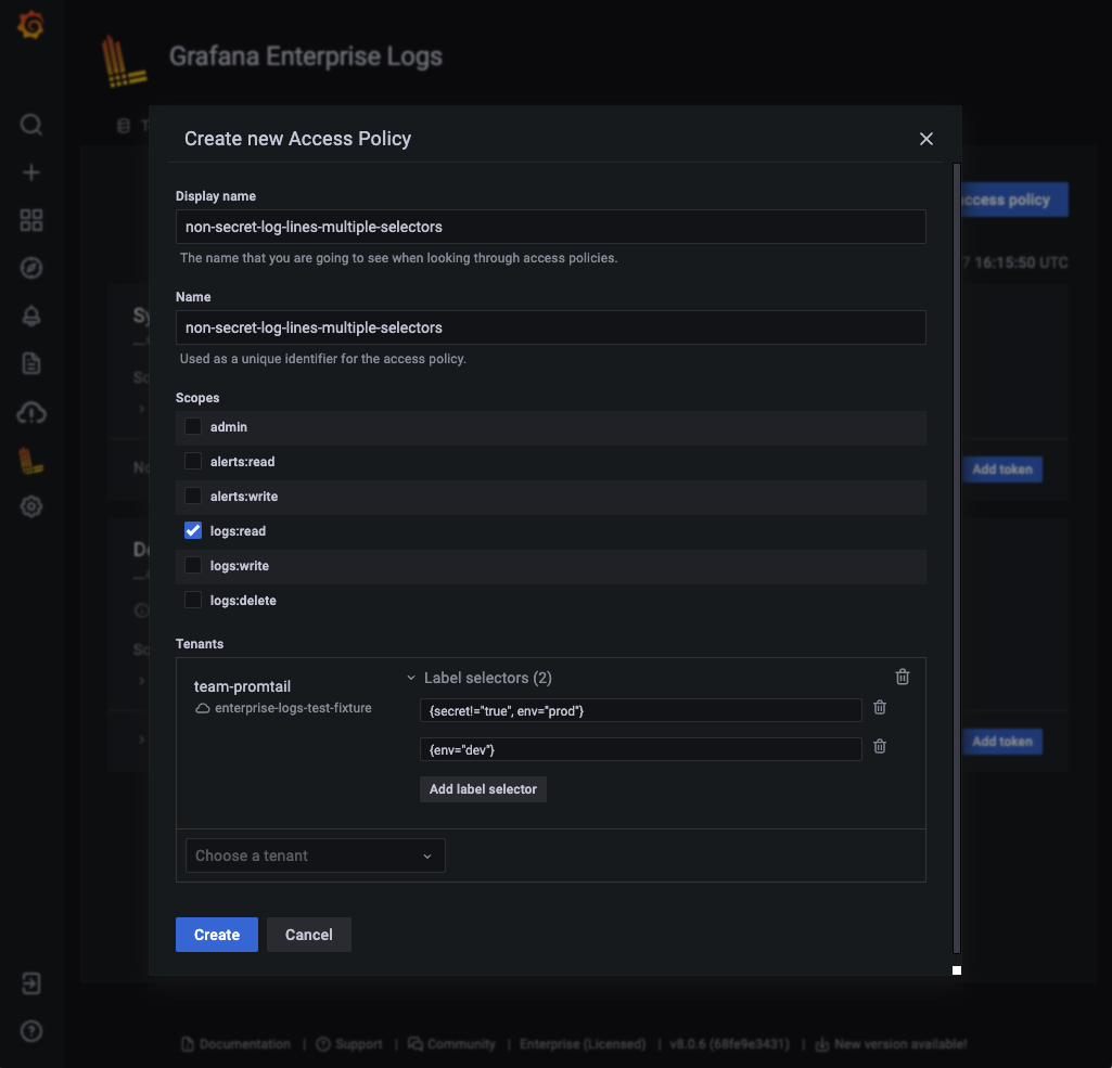

Use multiple selectors
To create a policy that allows someone to access the production and development environments and excludes logs with the label secret=true in the production environment, use multiple selectors.
Create multiple selectors
The selectors {secret!="true", env="prod"} and {env="dev"} enforce the policy:
  • The selector {secret!="true", env="prod"} matches and returns log lines from the production environment that do not have the secret: true label.
  • The selector {env="dev"} matches and returns log lines from the development environment, even if they have the secret: true label.
