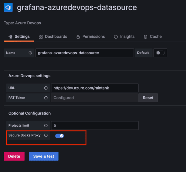

On the frontend, we need to add a feature toggle to enable or disable PDC.
Add an attribute enableSecureSocksProxy?: boolean; to the configuration interface usually defined in src/types.ts like below:
export interface MyDataSourceOptions extends DataSourceJsonData {
path?: string;
// add this line
Then add an option to components/ConfigEditor.tsx to be able to control this value with a toggle. It requires adding a few checks to make sure that:
  • the feature toggle secureSocksDSProxyEnabled is set
  • Grafana version is greater than 10.0.0
For example, here is how it’s done in Infinity data source:

PDC toggle option in data source configuration screen
