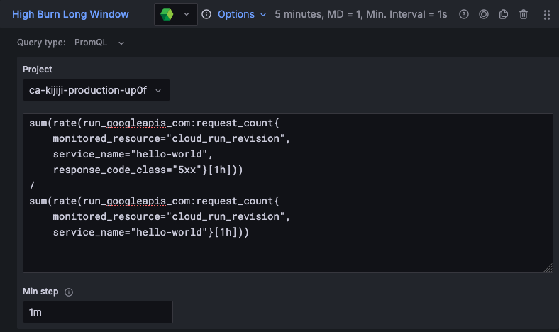

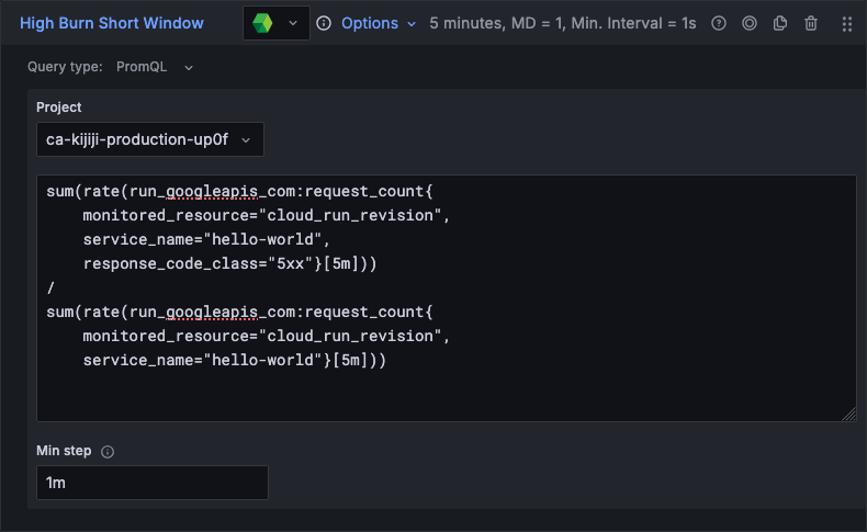

Below, we show what a Grafana-managed, multi-window, multi-burn-rate alert looks like. This is a single alert shown in multiple screenshots because it’s too big to show in a single image. The alert has four queries: one for each window, and one expression that brings all four queries together and sets thresholds.
First, are the high-burn queries:
A screenshot of a high burn, long window alert.
A screenshot of a high burn, short window alert.

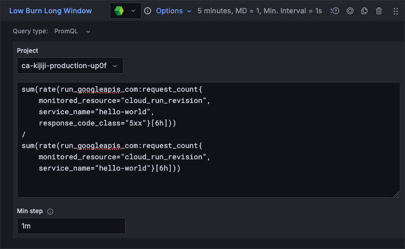

Next are the low-burn queries:
A screenshot of a low burn, long window alert.
