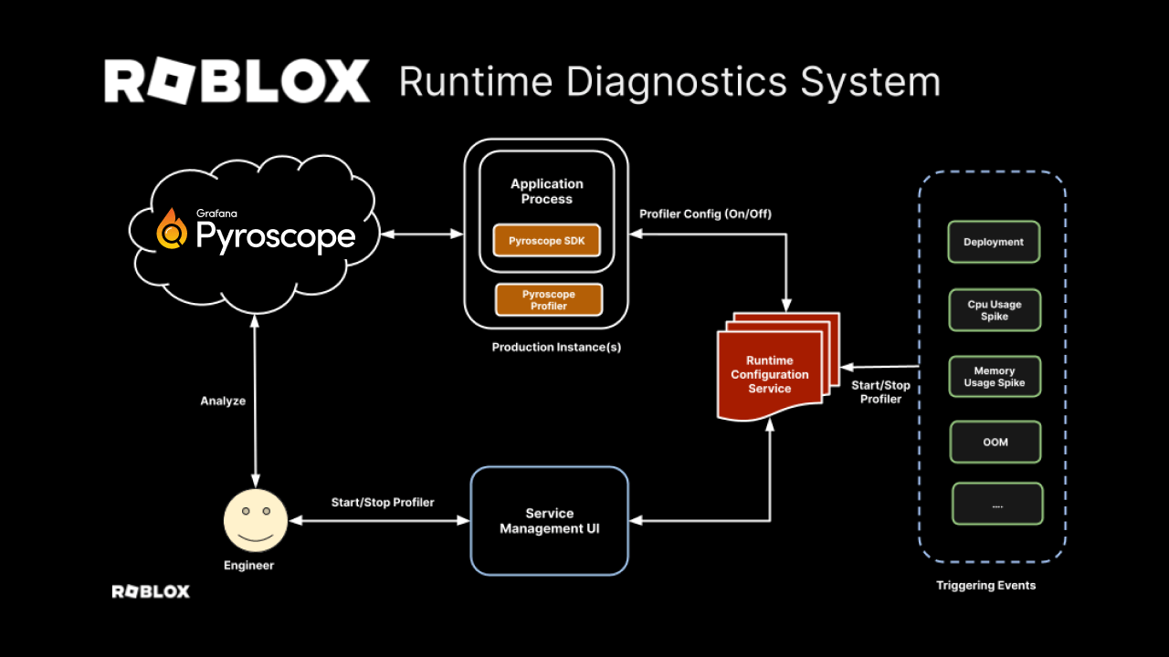

“We baked the Profiler into our container-based image. Our service framework continuously monitors our runtime configuration service to listen to when we need to provide which instances for how long, or when to turn them off,” Jiao said. “Once they get the signal, they actually call the Pyroscope SDK to dynamically control the Profiler.”
Roblox engineers use an internal web-based UI to update the runtime configuration, and all profiling data is uploaded into Grafana Cloud Profiles, Jiao added.
Looking ahead, the team plans to advance this system further by adopting what Jiao called event-based profiling. In this model, a service-critical event — such as a new deployment, or a CPU or memory issue — immediately and automatically triggers profiling.
A diagram of Roblox's runtime diagnostics system.
Jiao said he views Roblox’s current on-demand profiling system, as well as event-based profiling, as “stepping stones” towards eventually implementing continuous profiling — a modern and highly scalable profiling approach for production environments.
