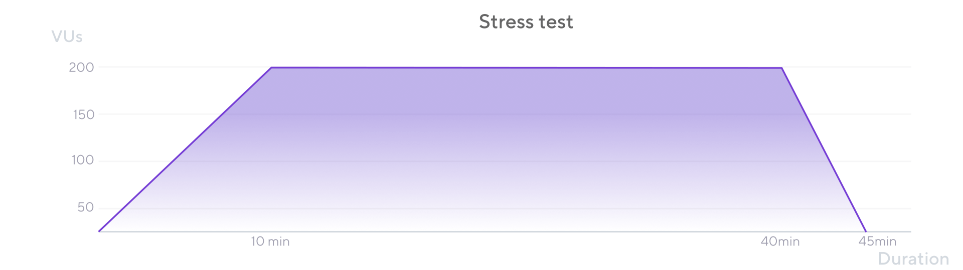

The VU or throughput chart of a stress test looks similar to this:
Stress test chart in Grafana k6.
Note that similar to the average-load test, the stress test starts at 0 but increases beyond the point tested in the average-load type. The ramp-up and ramp-down periods are longer to allow for a more realistic response.
