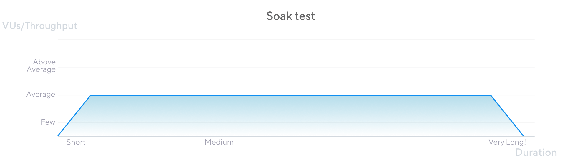

Soak testing is another variation of load testing that is similar to the average-load test. It focuses on extended periods, analyzing the following:
  • The system’s degradation of performance and resource consumption over extended periods.
  • The system’s availability and stability during extended periods.
The soak test differs from an average-load test in test duration. In a soak test, the peak load duration (usually an average amount) extends several hours or even days. Though the duration is considerably longer, the ramp-up and ramp-down periods of a soak test are the same as an average-load test.
Soak test chart in Grafana k6.
In some testing conversation, a soak test might be called an endurance, constant high load, or stamina test.

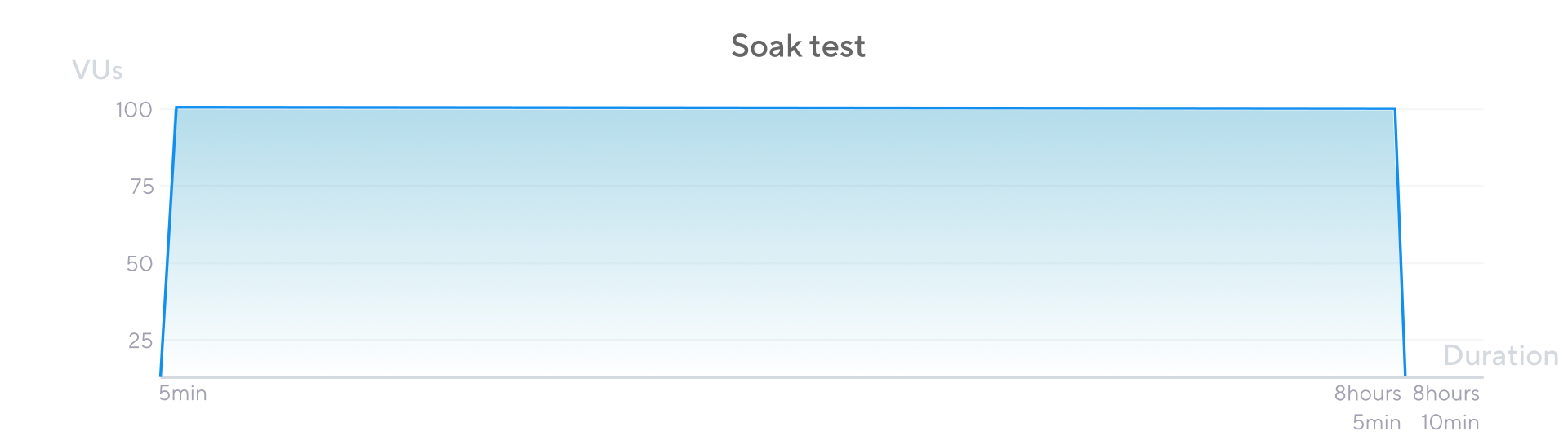

Configure the load duration in the options object:
JavaScript
import http from 'k6/http';
import { sleep } from 'k6';
export const options = {
  // Key configurations for Soak test in this section
  stages: [
    { duration: '5m', target: 100 }, // traffic ramp-up from 1 to 100 users over 5 minutes.
    { duration: '8h', target: 100 }, // stay at 100 users for 8 hours!!!
    { duration: '5m', target: 0 }, // ramp-down to 0 users
export default () => {
  const urlRes = http.get('https://test-api.k6.io');
  sleep(1);
  // MORE STEPS
  // Here you can have more steps or complex script
  // Step1
  // Step2
  // etc.
For more complex behavior, you can refer to more load testing examples in our k6 documentation.
Notice that, as in an average-load test, peak load plateaus at 100 VUs. The difference in a soak test is in duration. In this soak, peak load maintains for eight hours rather than a few minutes.
