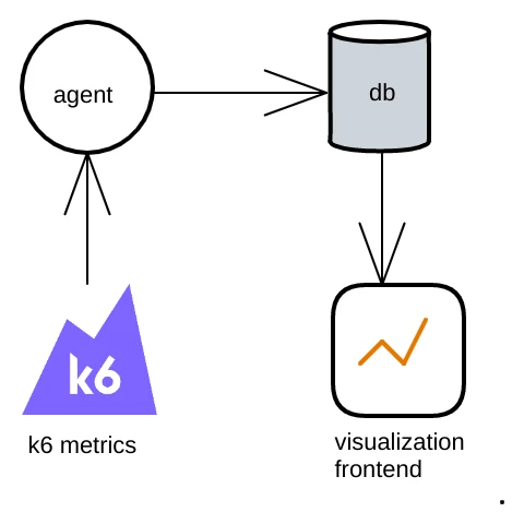

Thus, you can choose the structure and frontend that fits your workflow. For example, in this diagram of a generic workflow:
  1. k6 outputs metrics in some format and sends the metrics to an agent that can receive that format.
  2. The agent forwards the metrics to be stored in a database.
  3. The frontend queries the database and visualizes the output.
A diagram shows a flow from k6 metrics to an agent to a database to a visualization frontend

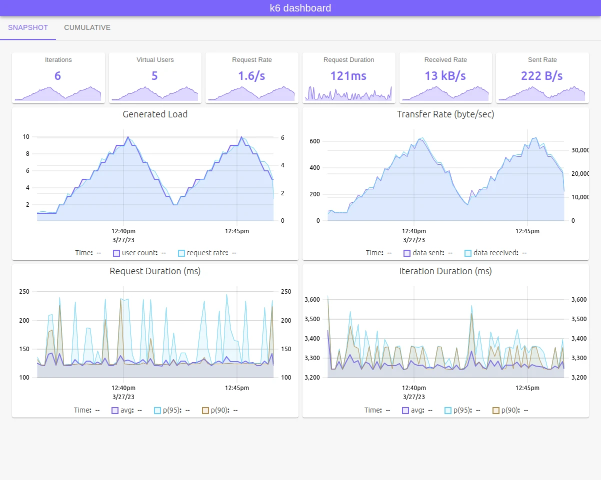

Server-sent events with xk6-dashboard.
For the first visualization, we want to highlight a great community project, xk6-dashboard. The dashboard runs a local web server that visualizes metrics as the test runs.
A screenshot of an xk6 dashboard
You can use it as you would use any extension:
  1. Download xk6:
go install go.k6.io/xk6/cmd/xk6@latest
  1. Build the binary:
xk6 build --with github.com/szkiba/xk6-dashboard@latest
  1. Run the test with the custom binary, using dashboard as the argument for --out.
./k6 run --out dashboard script.js
  1. Visit the dashboard on your localhost and view results as they appear. The default is http://127.0.0.1:5665/
For the latest instructions, visit the xk6-dashboard repository. If you want to make your own visualization tool, the source code for the xk6-dashboard may serve as inspiration.

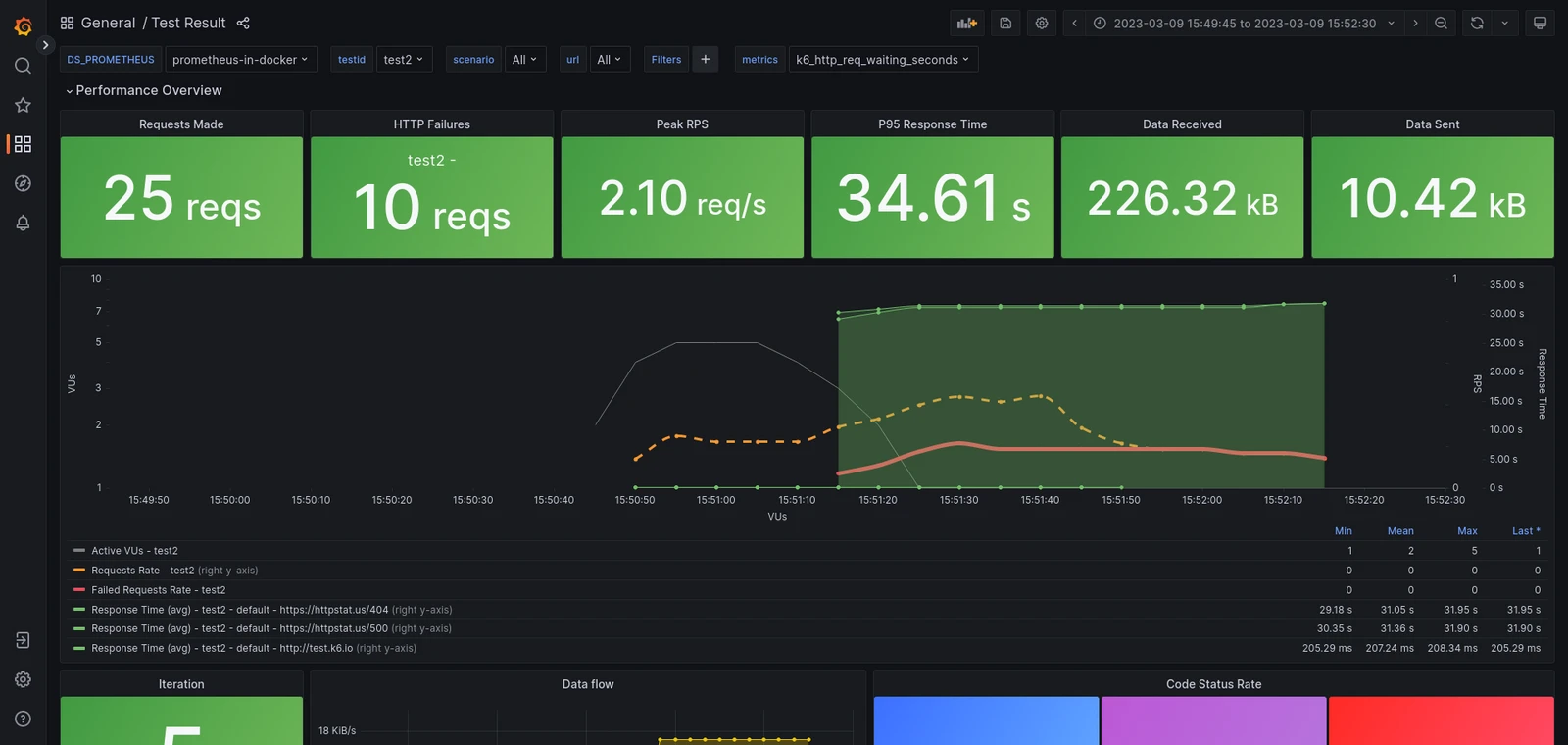

For visualization, one option is with Grafana — either Grafana Cloud or in a self-hosted instance.
A screenshot of test results visualized in Grafana
For detailed instructions about sending metrics in remote-write and visualizing data, refer to the k6 documentation about Prometheus remote-write.

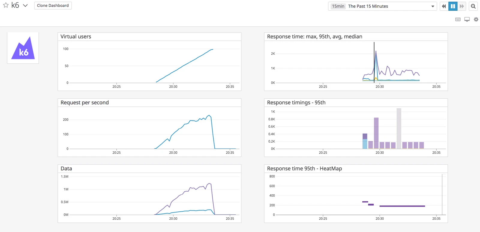

Datadog
A screenshot of Datadog metrics visualized in k6

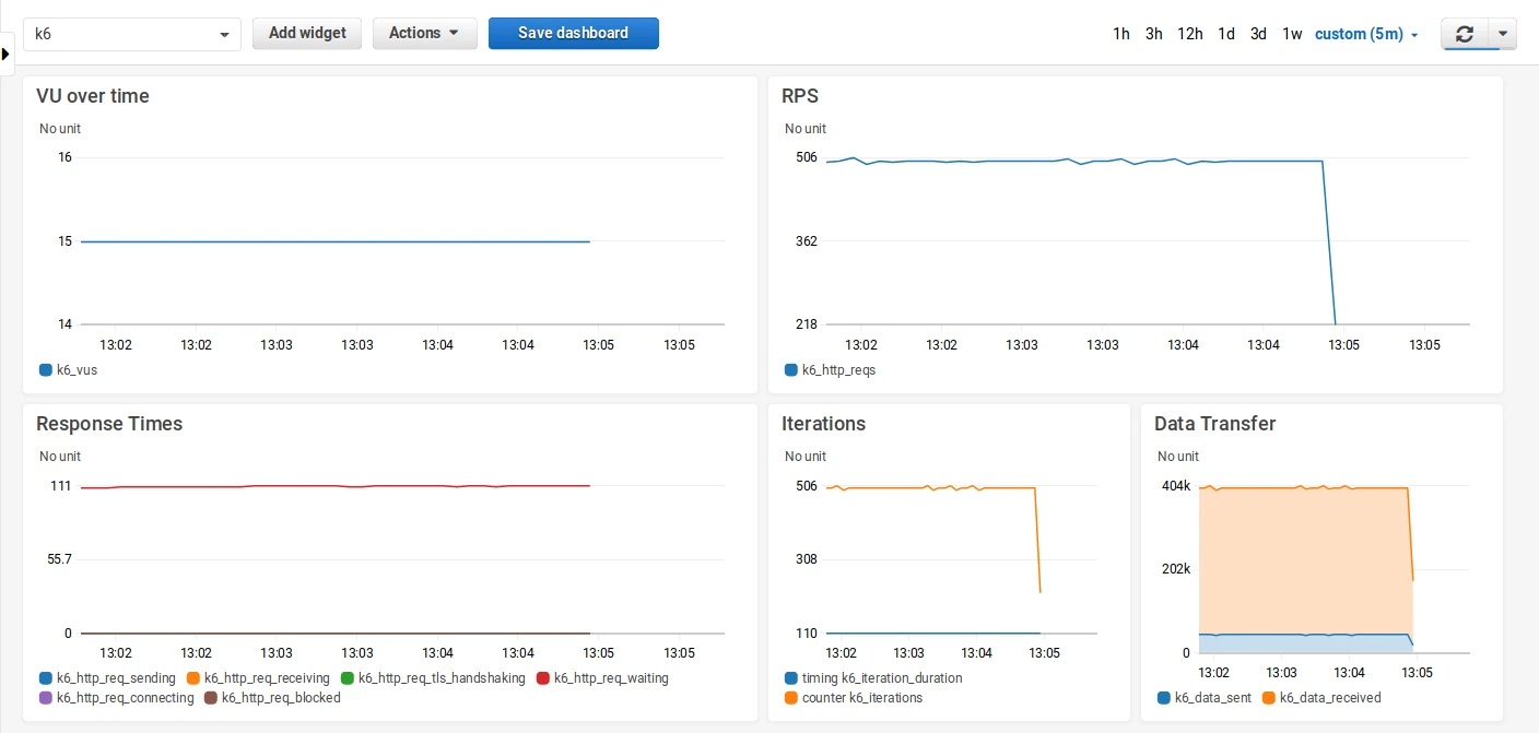

Amazon CloudWatch
A screenshot of CloudWatch metrics visualized in k6

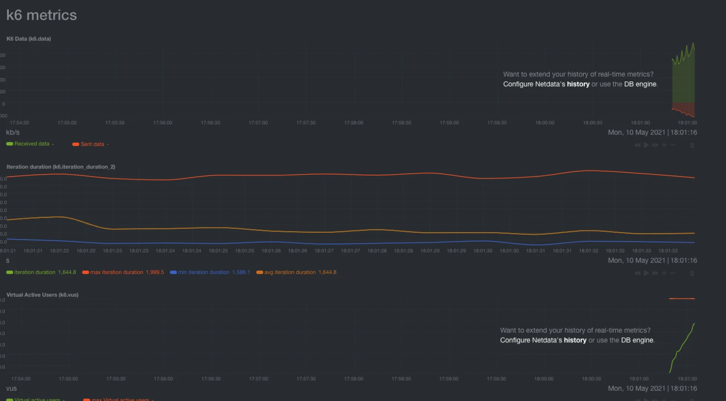

Netdata
A screenshot of Netdata metrics visualized in k6
For statsD–specific options, refer to StatsD in the k6 docs.

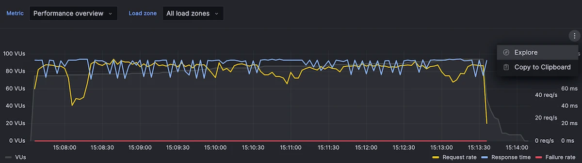

There are a host of load testing tools and other offerings you can use to track performance. Of course, we must mention our own managed service that comes with Grafana Cloud. With the Grafana Cloud k6 app, you can run k6 scripts from your own computer, then visualize results alongside everything in your Grafana Cloud instance.
A screenshot of metrics visualized in Grafana Cloud k6
Besides the flexibility, Grafana Cloud k6 has some default visualizations with key metrics. What’s more, you can incorporate the results with other dashboards, which means you can correlate results with other observability data.
To learn more, read the documentation for Grafana Cloud k6.
