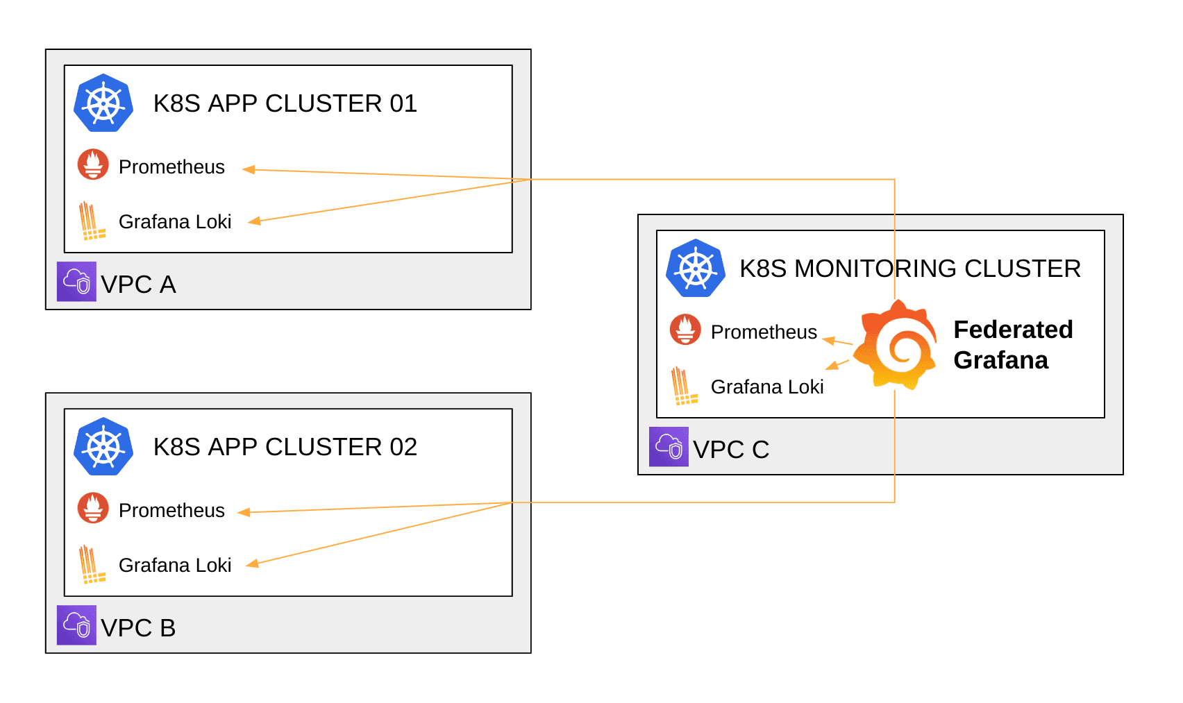

We manage several Kubernetes clusters, but for convenience, we are using a single federated Grafana instance that queries all our clusters using AWS’ VPC peering. Grafana makes it easy for us to gather and visualize all our metrics in a single place. For each cluster, we have two Grafana data sources — one for the Prometheus metrics, and one for the logs from Grafana Loki. Our technical squads use this Grafana instance to develop, test, and operate our technical stack. This includes part of our cloud infrastructure that relies on Amazon CloudWatch metrics, but our main components remain applications running on Kubernetes.
An architectural diagram shows Powder's Kubernetes monitoring cluster as well as two Kubernetes application clusters.

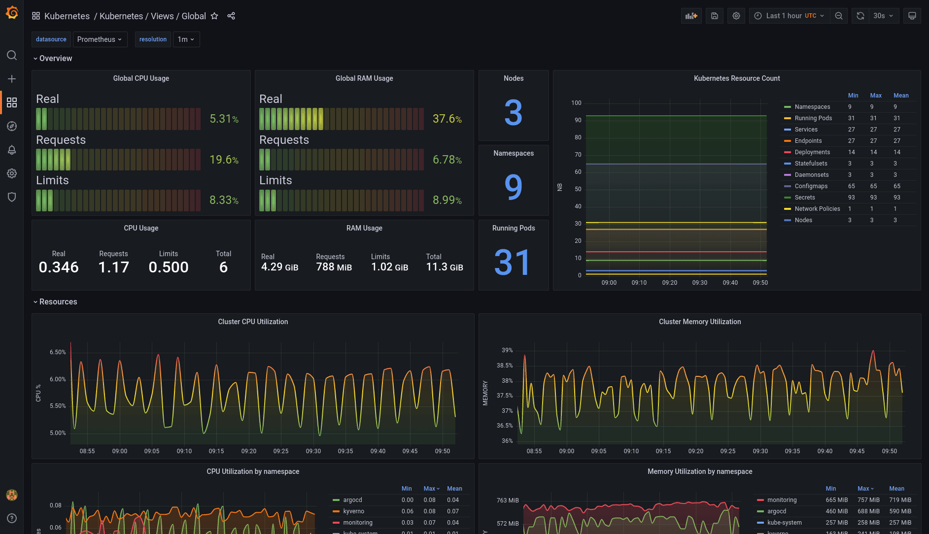

A screenshot of the global view from dotdc/grafana-dashboards-kubernetes.
Here’s the list of changes since the original article:
  • Updated the global view to show real, requests and limits resource usage

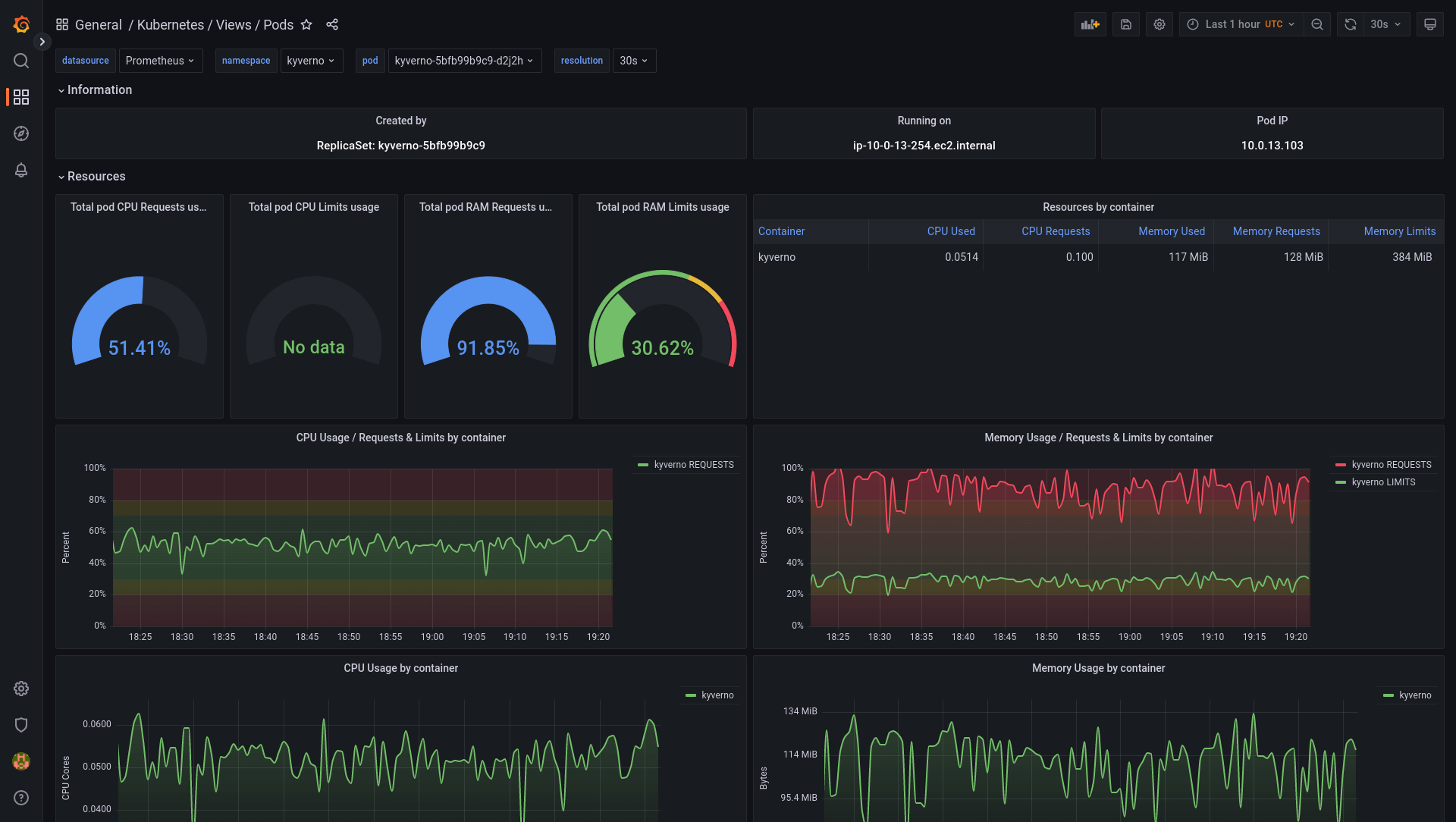

  • The pods view has been re-imagined to ease container resource sizing (requests, limits)
  • Dashboards can now be deployed as an ArgoCD application, on top of the existing installation methods
  • Data links between the nodes dashboard and the pods dashboard
  • Fixed display errors when using the Grafana light theme
  • Various other fixes and enhancements
These were made possible thanks to the project contributors: reefland,mashun4ek, kongfei605, vladimir-babichev, SuperQ, miracle2k,k1rk, William-LP, clementnuss, germetist, and geekofalltrades.
Screenshot of the pods view from dotdc/grafana-dashboards-kubernetes
