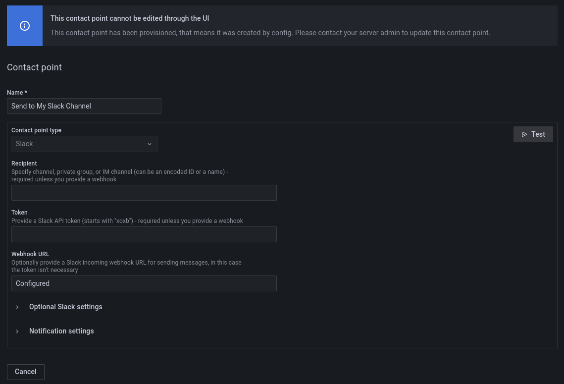

After running terraform apply, you can go to the Grafana UI and check the details of our contact point. Since the resource was provisioned through Terraform, it will appear locked in the UI. This helps you make sure that your Alerting stack always stays in sync with your code.
We can also use the Test button to verify that the contact point is working correctly.

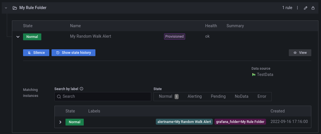

The alert will then appear under the alert rules panel. Here, you can see whether or not the rule is firing. You can also see a visualization of each of the rule’s query stages.

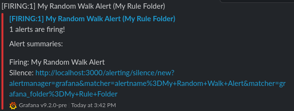

When our alert fires, Grafana will route a notification through the policy we defined earlier.
Since we configured that policy to send alert notifications to our Slack contact point, Grafana’s embedded Alertmanager will automatically post a message to our Slack channel!
