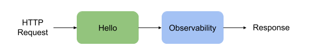

Very exciting! Let me first introduce the wonderfully simple Spring Boot application, Hello Observability.
Intro to the Spring Boot application
The Hello Observability application is extremely simple. It mainly contains one Java class HelloObservabilityBootApp, which contains two methods that can serve HTTP requests.

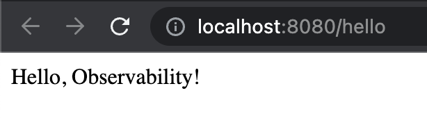

You can then run the application directly and access it here: http://localhost:8080/hello. Very simple application, indeed!
java -jar target/*.jar

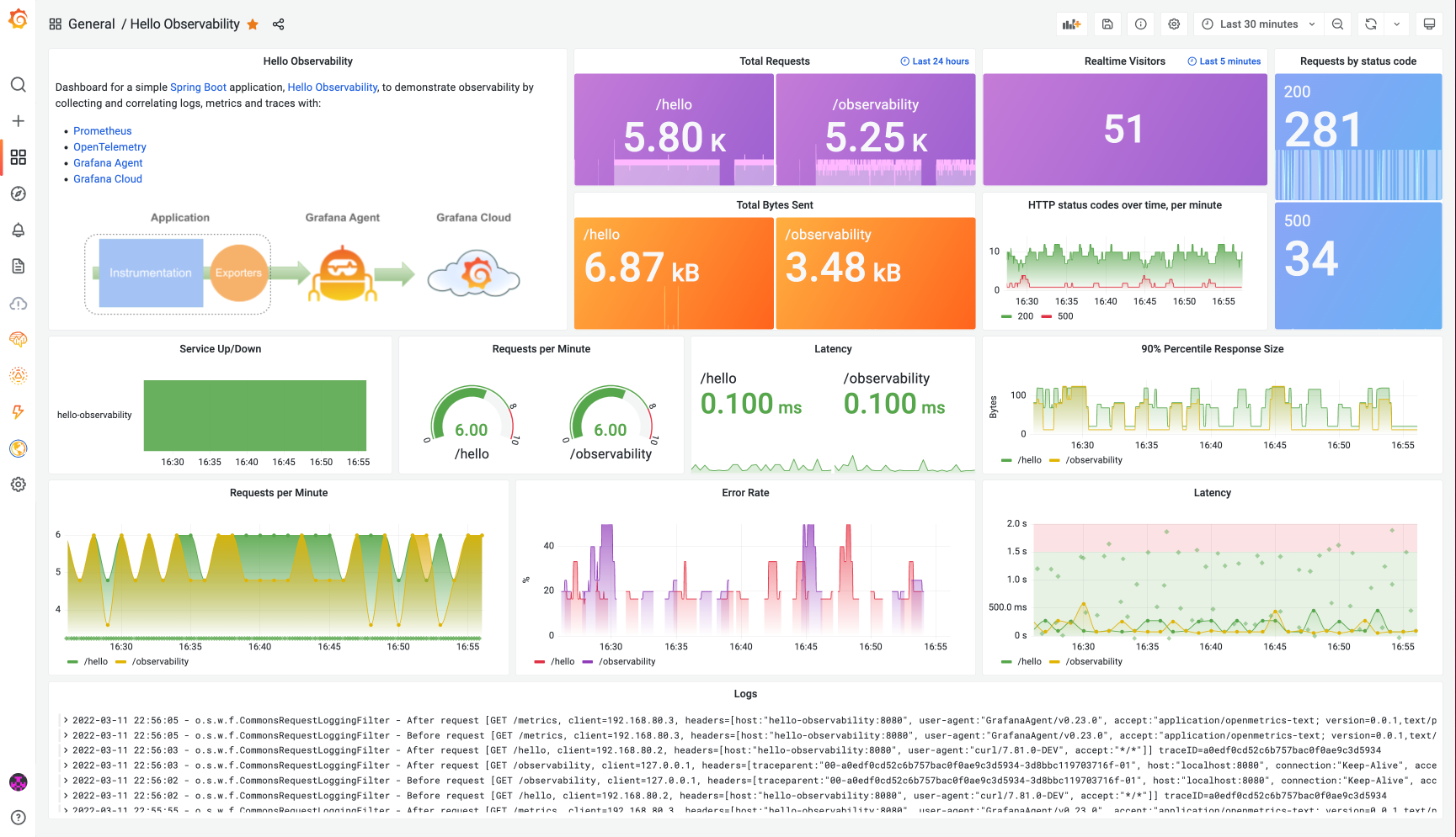

After all the containers are up, you can access the application here: http://localhost:8080/hello,  and Grafana here: http://localhost:3000. A dashboard called Hello Observability is also pre-loaded.
Spring Boot application in Grafana Cloud: Grafana dashboard of Spring Boot application

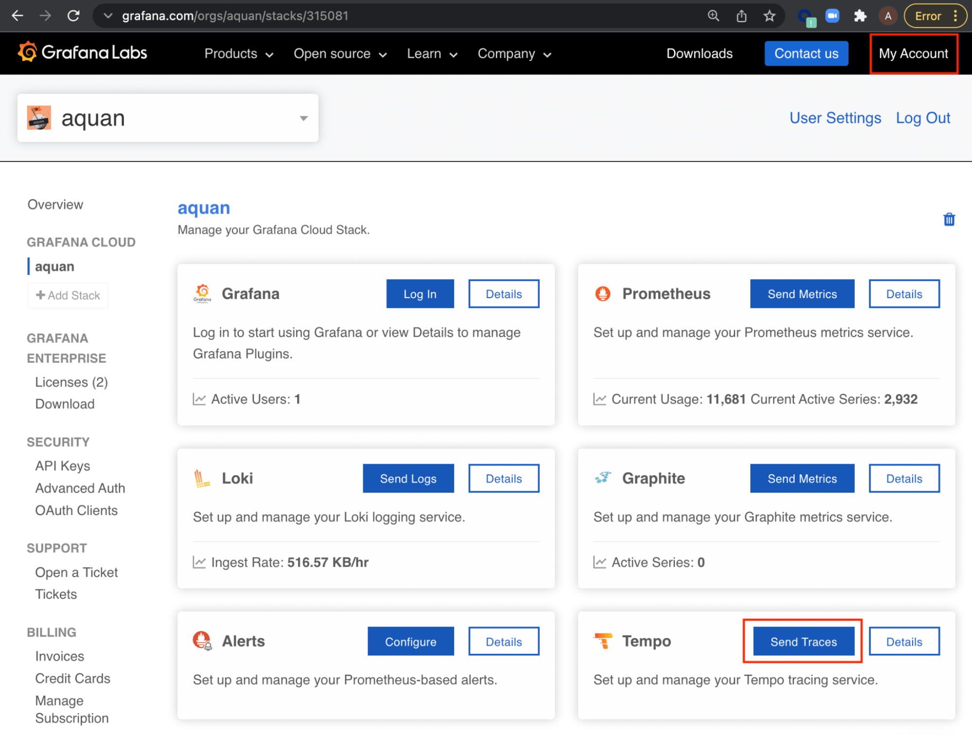

To send logs, metrics, and traces to Grafana Cloud, we need to gather our Grafana Cloud connection information for Loki, Prometheus, and Tempo, so that we can configure our Agent accordingly. That’s what we will do next.
Connect Grafana Cloud Traces
Grafana Cloud Traces is the fully-managed, highly-scalable, and cost-effective distributed tracing system based on Grafana Tempo. That’s where our traces will go.

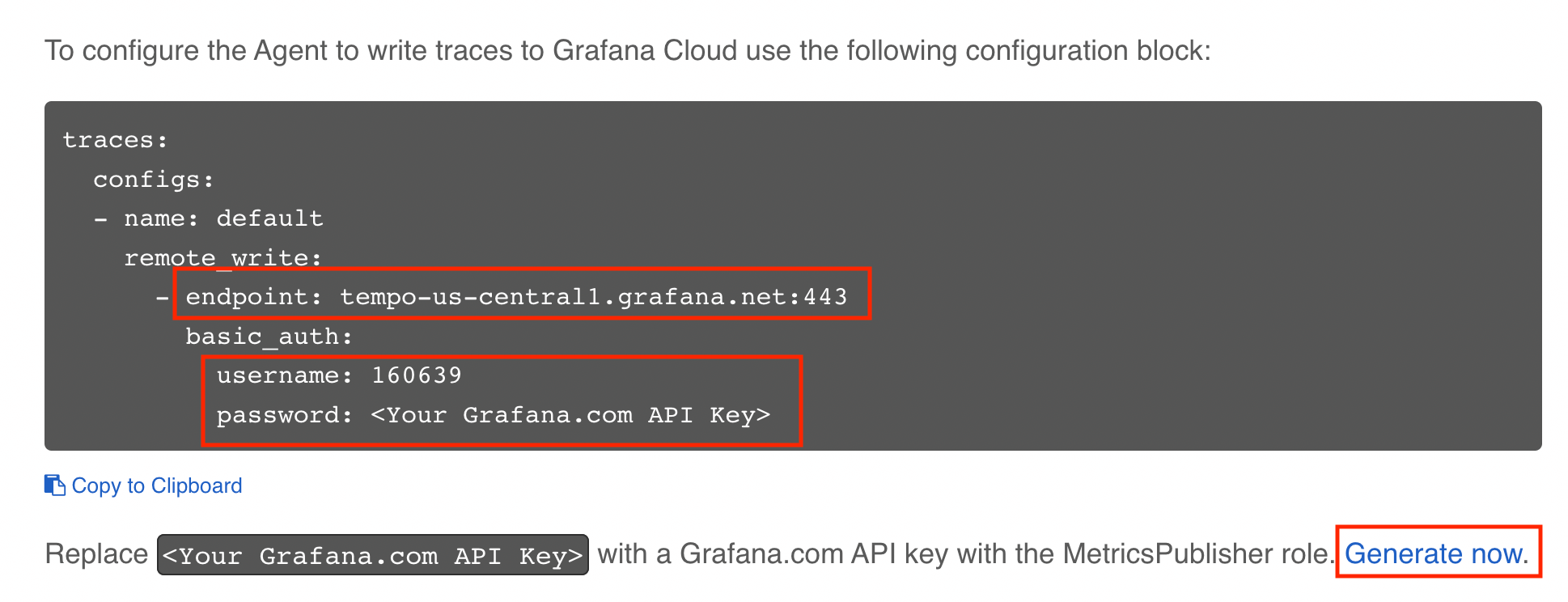

Tempo connection information includes endpoint URL and user credentials. Navigate to grafana.com and login. Make sure you select the right account from the account dropdown. My account name is aquan. Click on My Account, then Send Traces in the Tempo section.
Spring Boot application in Grafana Cloud: Grafana Cloud UI to configure traces with Grafana Tempo
You should see something like the screenshot below, with information about the endpoint and user credentials. You can generate a new API Key by clicking on the Generate now link or navigate to the Security → API Keys section.

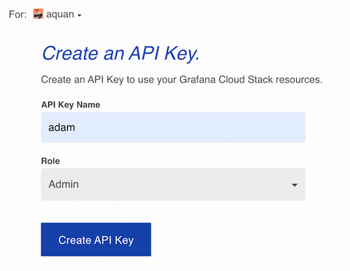

Either way, the API Key creation screens look like below. (No worry about me exposing my API Key. It’s already deleted.)
Spring Boot application in Grafana Cloud: create API key
Spring Boot application in Grafana Cloud: API token created UI

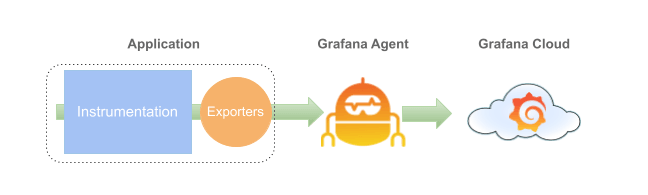

Grafana Agent is an all-in-one agent for collecting metrics, logs, and traces. It removes the need to install more than one piece of software by including common integrations for monitoring out of the box. Grafana Agent makes it easy to send telemetry data and is the preferred telemetry collector for sending metrics, logs, and trace data to the opinionated Grafana observability stack, both on-prem and in Grafana Cloud.
Spring Boot application in Grafana Cloud: diagram of how Grafana Agent works in the stack
All the agent configuration information is inside the agent.yaml file. Let’s see exactly how the agent is configured.

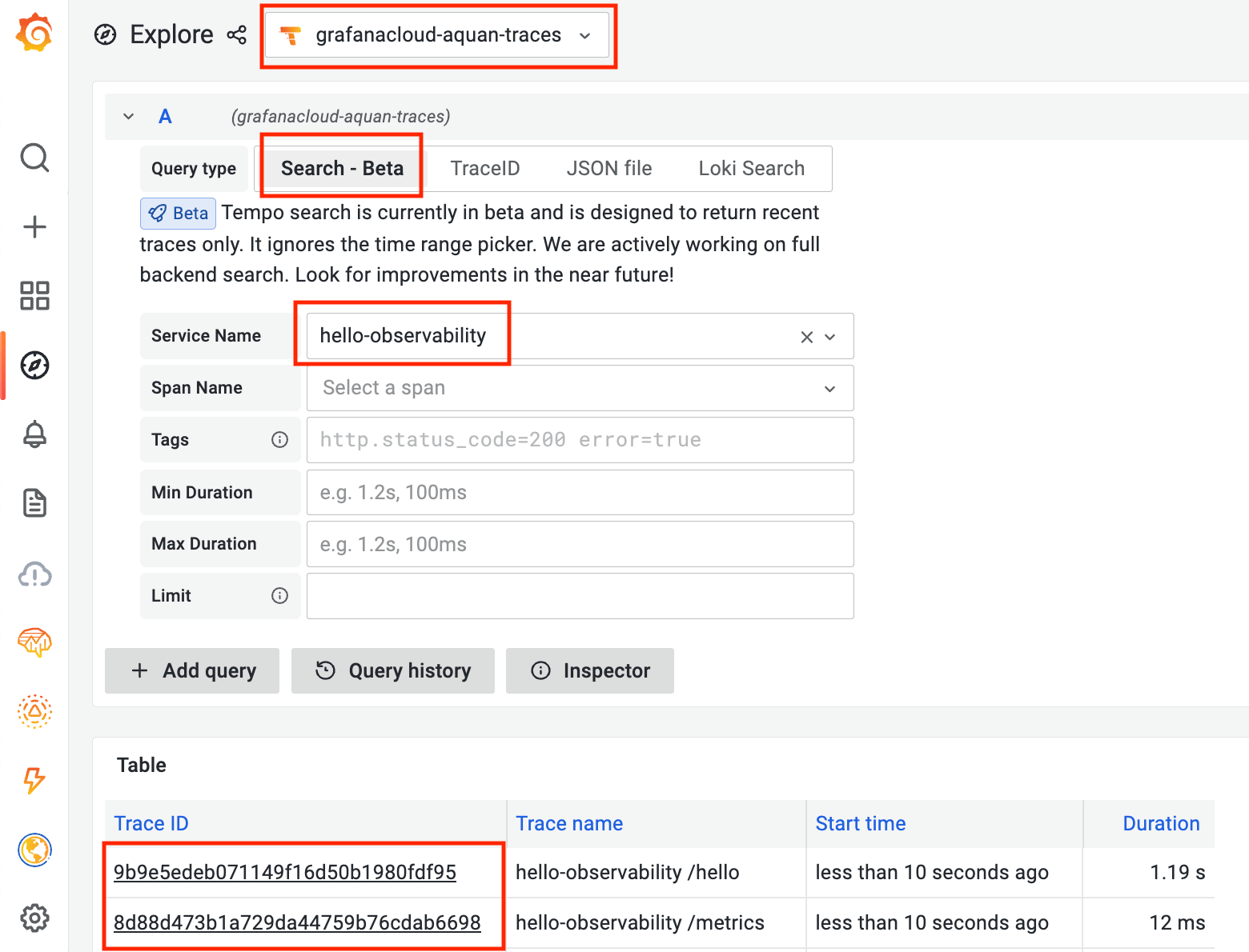

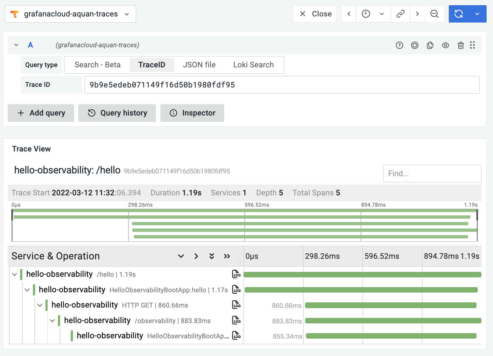

While the application is running, log into your Grafana Cloud account. Select your Tempo data source from Explore. In my case, it’s called grafanacloud-aquan-traces. See your traces by clicking on the Search button and selecting hello-observability for Service Name. Remember we set OTEL_SERVICE_NAME to hello-observability?
Spring Boot application in Grafana Cloud: UI for instrumenting Java Agent with OpenTelemetry
Click on one of them to see the waterfall visualization of the trace. Later, once we have logs and metrics shipped to Grafana Cloud too, you will be able to correlate logs, metrics, and traces together! The power of a unified observability platform!

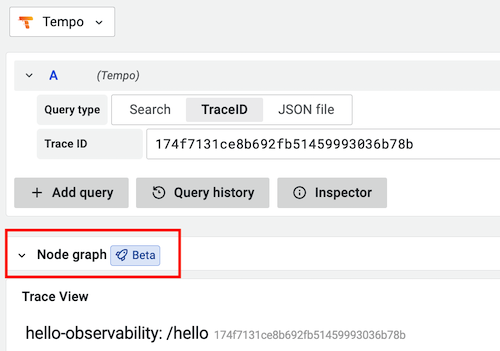

If you are running everything locally, you will also be able to see the bonus Node Graph, which is still in beta, as of writing.
Spring Boot application in Grafana Cloud: UI for Node Graph in Grafana Cloud
This is what the node graph for the trace above looks like:
Spring Boot application for Grafana Cloud: node graph of a trace in Grafana Cloud

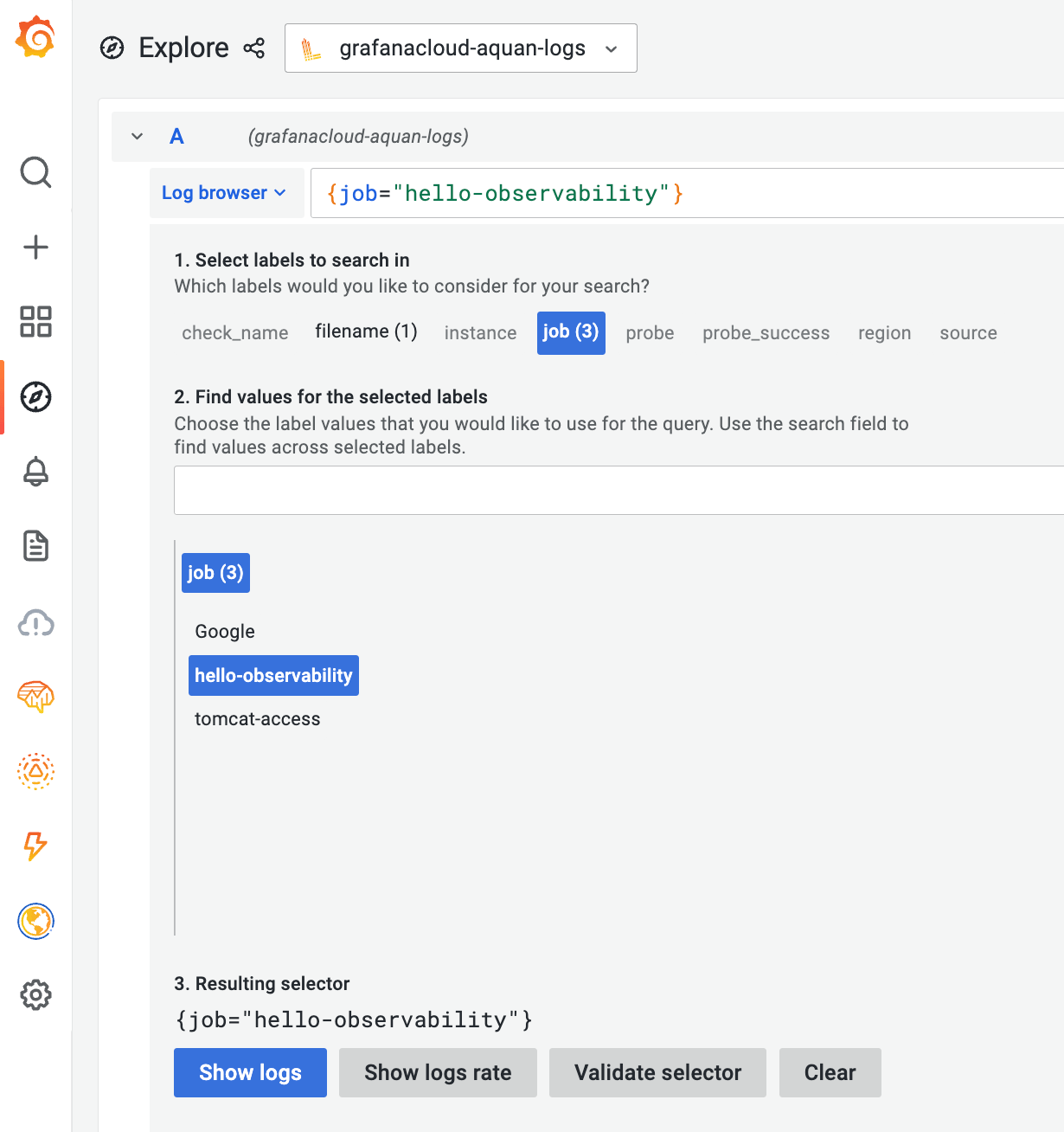

If you look at the hello-observability.log log file, you should see log lines like these. Notice the trace ID?
2022-03-11 18:15:56 - After request [GET /hello, client=192.168.80.2, headers=[host:"hello-observability:8080", user-agent:"curl/7.81.0-DEV", accept:"*/*"]] traceID=f179e69bd5f342233b9bc66728901f7f
Sending the logs to Grafana Cloud using the Grafana Agent is super simple. Please refer to the documentation Collect logs with Grafana Agent for details. Here is the scrape_configs section inside the agent.yaml file for logs:

Go to Grafana Cloud, then Explore, and select the Loki data source. In my case, it’s called grafanacloud-aquan-logs. Use the Log browser to select the hello-observability job. Then click on Show logs.
Spring Boot application in Grafana Cloud: UI for instrumenting logs in Spring Boot app
You should see some log lines. Expand one of the log lines and click on grafanacloud-quan-traces, you should see something like this below. The magical correlation between the logs and traces all done automatically because of the trace ID!
Spring Boot application in Grafana Cloud: UI for correlating logs and traces

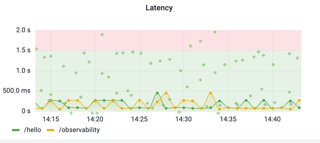

Make sure the application is running. Go to Grafana Cloud, and the Hello Observability dashboard. The Requests per Minute visualization shows Prometheus metrics with exemplars, which are the green dots.
Spring Boot application in Grafana Cloud: Grafana dashboard for Prometheus metrics

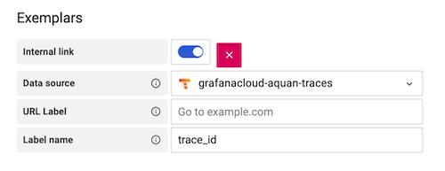

For the exemplar pop-up dialog to show a link to Tempo, you do have to configure the Label name to be trace_id in the Prometheus data source configuration. The default is traceID. Otherwise, you will not see the link. You cannot edit the pre-configured Prometheus data source in your cloud account. You will have to create another Prometheus data source with the same connection information, then add the exemplar configuration.
Spring Boot application in Grafana Cloud: configuring exemplars

  1. Find traces using logs with trace ID. As you have seen, you can pivot from logs to traces easily following the trace ID link. Using logs, you can search by path, status code, latency, user, IP, or anything else you can add onto the same log line as a trace ID. For example, you can easily filter the logs down to see only the traces that failed, exceeded latency SLAs, etc. This makes it much easier to troubleshoot issues when they do occur.
  2. Find all the logs for a given span. Spans contain links to associated logs. You can explore relevant logs associated with spans with just one click.
  3. Find traces from metrics using exemplars. When traces, logs, and metrics are decorated with consistent metadata, you can create correlations that were not previously possible. As you have seen from the Latency panel, Prometheus metrics are decorated with trace ID when OpenTelemetry is also used for tracing. When you jump from an exemplar to a trace, you are now able to go directly to the logs of the struggling service!
