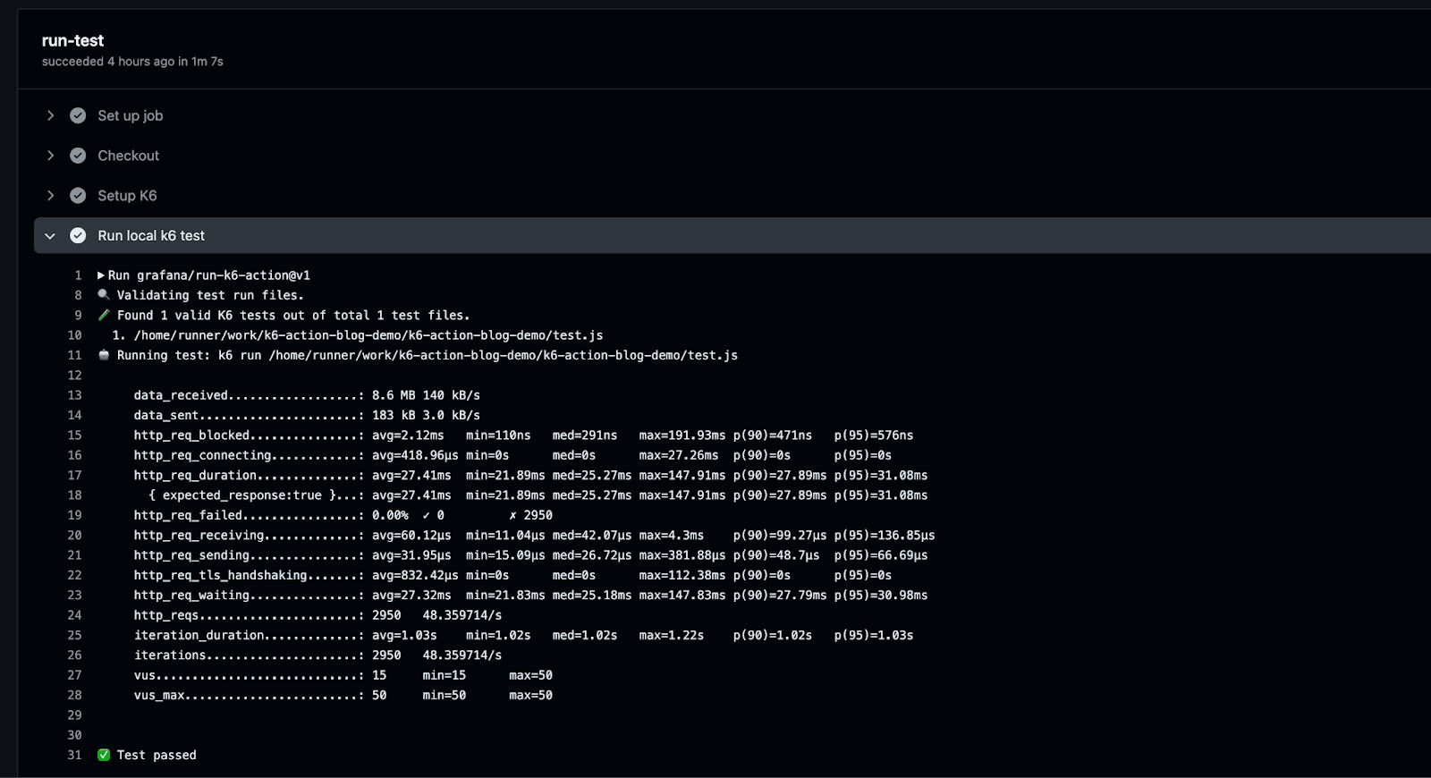

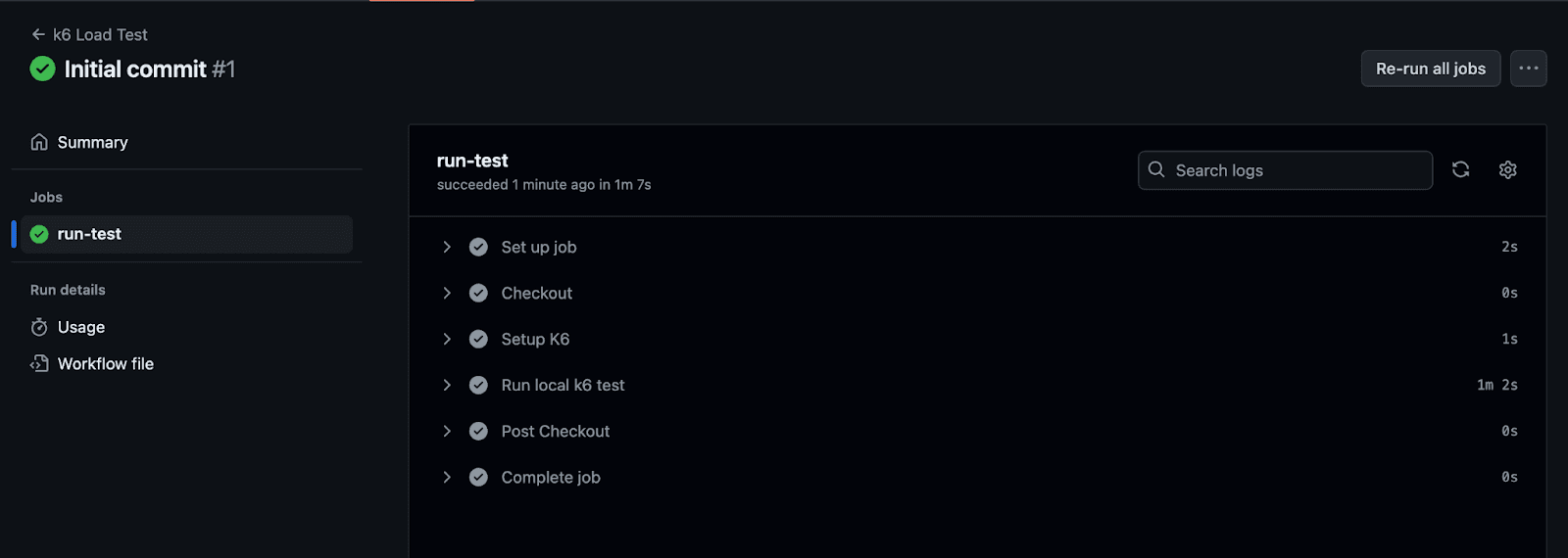

A screenshot the run-test job.
A screenshot of code for running a local k6 test.

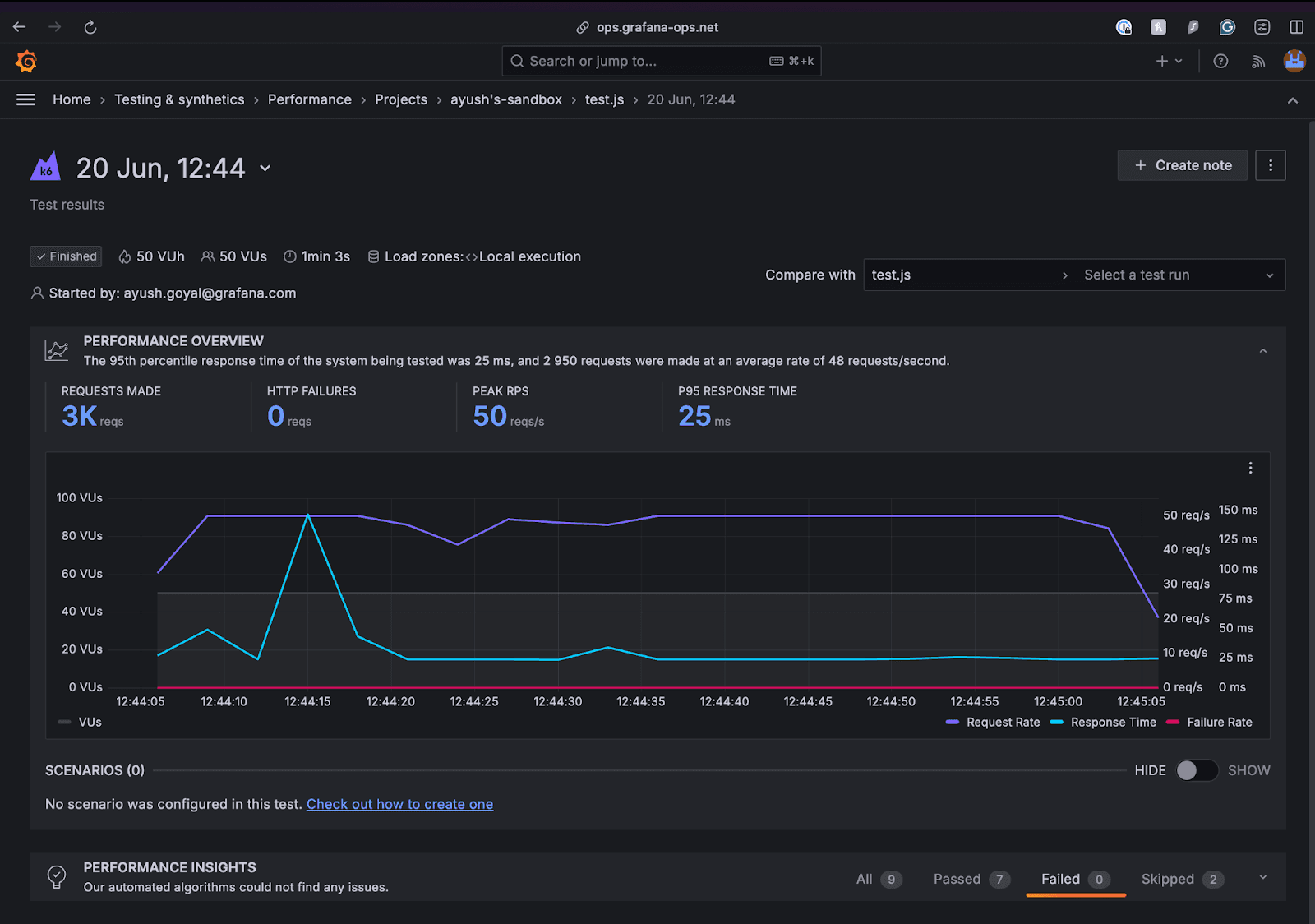

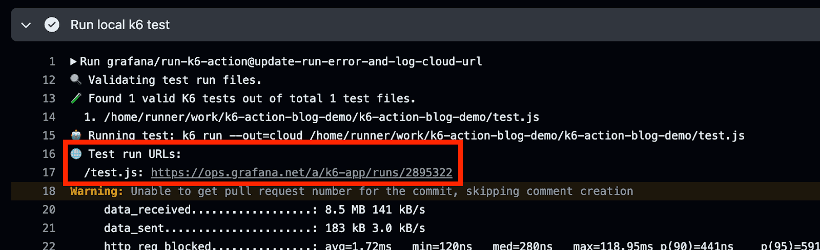

Once we commit and push these changes, k6 will run the cloud test, and output the URL to our test results as part of the workflow logs.
A screenshot of the output URL.
And if we copy the highlighted URL and navigate to it in a new tab:
A screenshot of the test results performance overview page.
