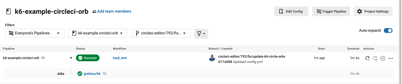

Add project and run the test
To enable a CircleCI build for your repository, use the “Add Project” button. While you have everything setup, head over to your dashboard to watch the build that was just triggered by pushing the changes to GitHub. You might see the build at the top of the pipeline page:
CircleCI successful execution of a performance test.

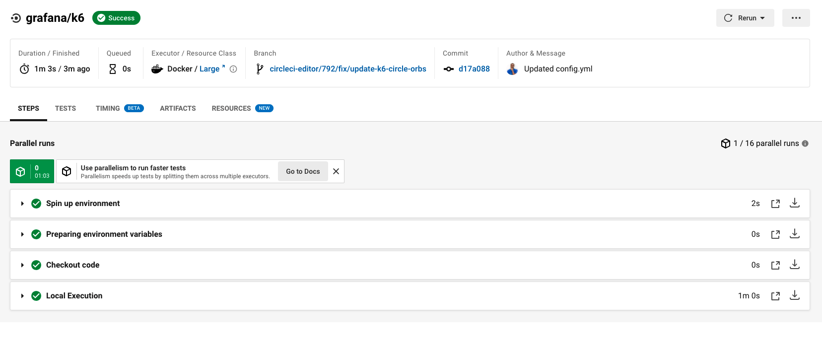

On this page, you will have your build running. Just click on the specific build step, i,e., the highlighted grafana/k6, to watch the test run and see the results when it has finished. Below is the build page for a successful build:
CircleCI successful build with a performance test.

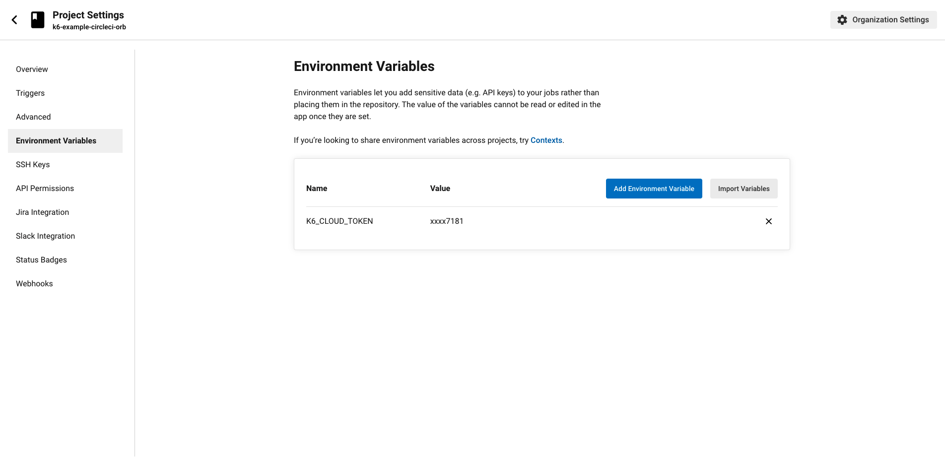

We will now show how to trigger cloud tests from CircleCI. If you do not have an account with Grafana Cloud k6 already, register for a trial account. After that, go to the token page and copy your API token.
Next, navigate to the project’s settings in CircleCI and select the Environment Variables page. Add a new environment variable:
  • K6_CLOUD_TOKEN: its value is the API token we got from Grafana Cloud k6.
CircleCI Environment Variable for k6 API token and k6 project ID.
If you need to run the cloud test in a particular project, you need your project ID to be set as an environment variable or on the k6 script. The project ID is visible under the project name in the project page.

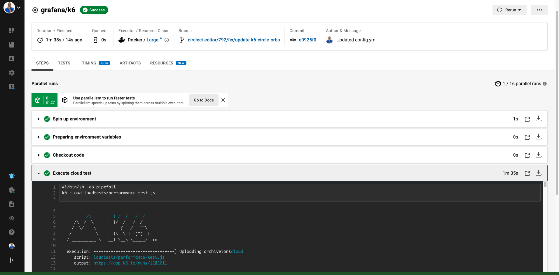

Again, due to the power of orbs, since we already have an existing written configuration, all we need to do is to pass in the configuration cloud: true and CircleCI will be able to use our K6_CLOUD_TOKEN that we configured in our environment variables and to send our k6 run output to Grafana Cloud k6.
Note: It is mandatory to set the K6_CLOUD_TOKEN for the cloud configuration on Circleci to work with the k6 orb. This is because, once we have a cloud:true option in our configuration, CircleCI expects to also have a valid token that can be used to run our tests on Grafana Cloud k6.
With that done, we can now go ahead and push the changes we’ve made in .circleci/config.yml to our GitHub repository. This subsequently triggers CircleCI to build our new pipeline using the new config file. Just keep in mind that for keeping things tidy, we’ve created a directory named cloud-example which contains the CircleCI config file to run our cloud tests in the cloned repository.
CircleCI job running a k6 cloud test.

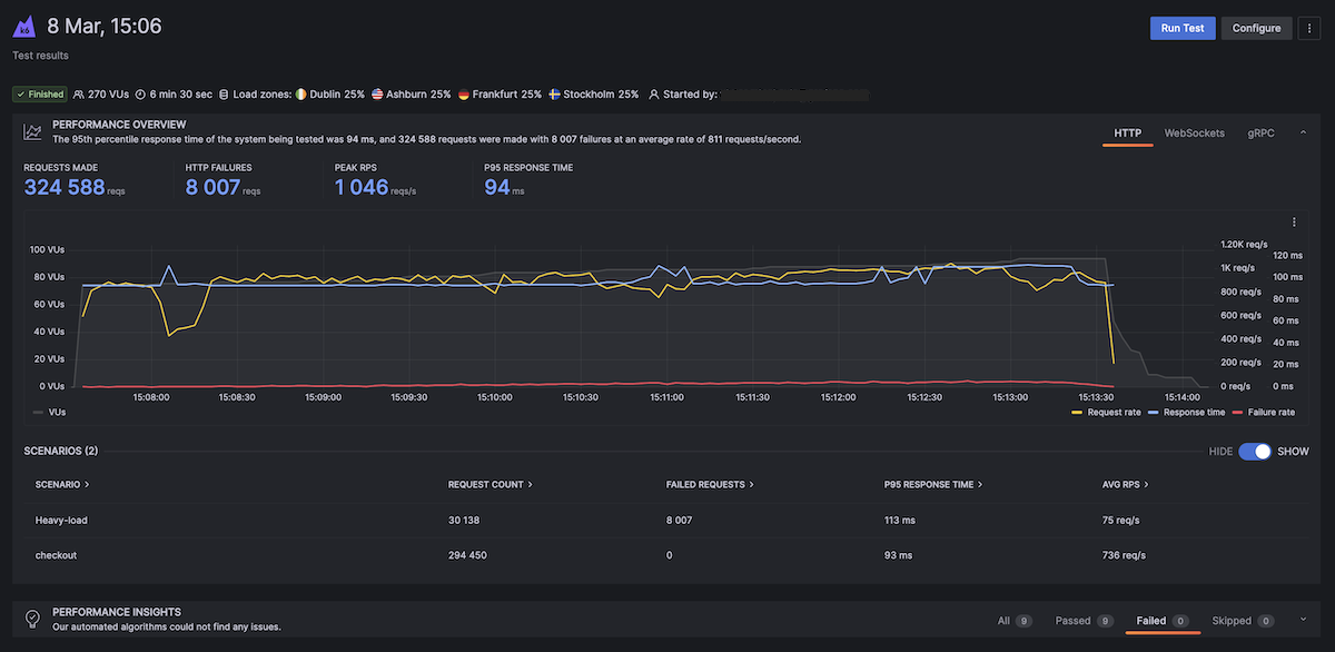

It is essential to know that CircleCI prints the output of the k6 command, and when running cloud tests, k6 prints the URL of the test result in Grafana Cloud k6, which is highlighted in the above screenshot. You could navigate to this URL to see the result of your cloud test.
We recommend that you define your performance thresholds in the k6 tests in a previous step. If you have configured your thresholds properly and your test passes, there should be nothing to worry about. But when the test fails, you want to understand why. In this case, navigate to the URL of the cloud test to analyze the test result. The result of the cloud service will help you quickly find the cause of the failure.
Grafana Cloud k6 results.

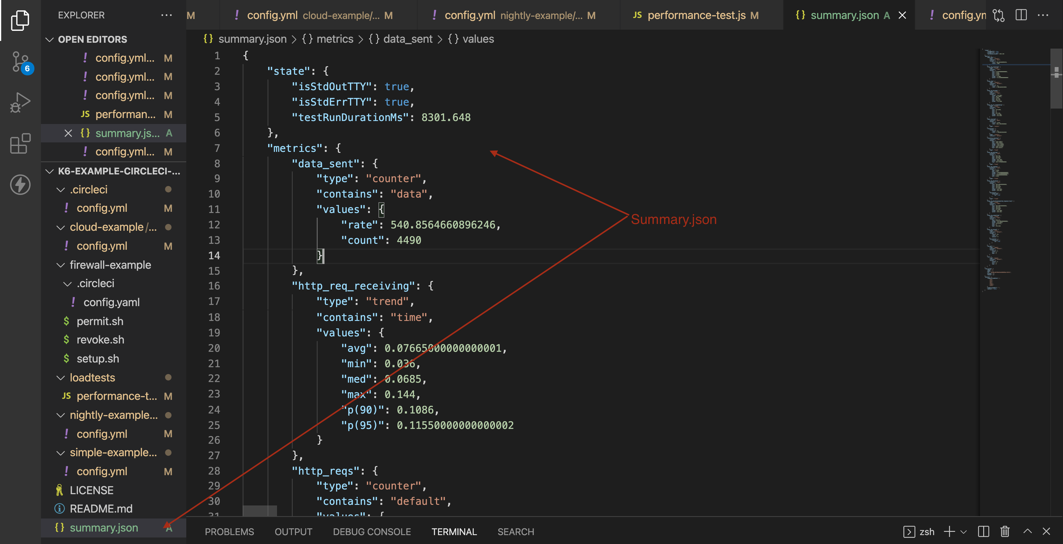

Using handleSummary callback for test summary
k6 can also report the general overview of the test results (end of the test summary) in a custom file. To achieve this, we will need to export a handleSummary function, as in the code snippet below of our performance-test.js script file:
import { sleep } from 'k6';
import http from 'k6/http';
import { textSummary } from 'https://jslib.k6.io/k6-summary/0.0.1/index.js';
export const options = {
  duration: '.5m',
  vus: 5,
  iterations: 10,
  thresholds: {
    http_req_failed: ['rate<0.01'], // http errors should be less than 1%
    http_req_duration: ['p(95)<500'], // 95 percent of response times must be below 500ms
export default function () {
  http.get('http://test.k6.io/contacts.php');
  sleep(3);
export function handleSummary(data) {
  console.log('Finished executing performance tests');
  return {
    'stdout': textSummary(data, { indent: ' ', enableColors: true }), // Show the text summary to stdout...
    'summary.json': JSON.stringify(data), // and a JSON with all the details...
In the handleSummary callback, we have specified the summary.json file to save the results. To store the summary result as a CircleCI artifact, we use the same running command as our testing command but define an output path where CircleCI will store our output file as shown below:
version: 2.1
orbs:
grafana: grafana/k6@1.1.3
workflows:
load_test:
  jobs:
   - grafana/k6:
        script: loadtests/performance-test.js > /tmp/artifacts
Looking at the execution, we can observe that our console statement appeared as an INFO message. We can also verify that a summary.json file was created after we finished executing our test as shown below. For additional information, you can read about the handleSummary callback function here.

CircleCI integration with performance testing reports.
On observation, we can verify that the summary.json is an overview of all the data that k6 uses to curate the end of the test summary report, including the metrics gathered, test execution state, and also test configuration.
