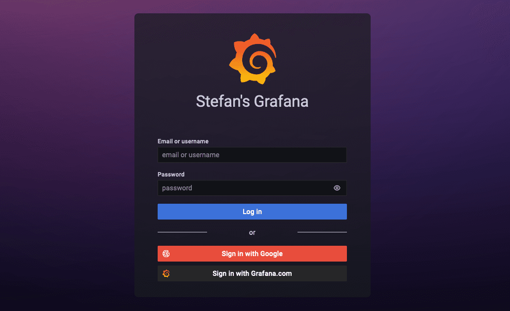

Embedded image
In the login screen above, you can see that multiple options are configured to authenticate yourself upon login: username and password potentially from an LDAP source, a Google OAuth2 provider, and another OAuth option using your Grafana.com account.

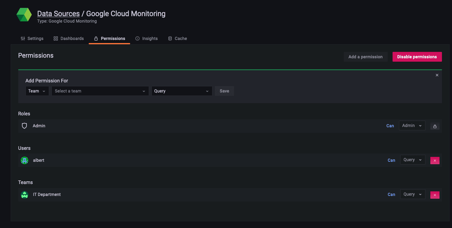

Embedded image
In this data source permissions example above, only a user with the name “albert” as well as the users in the team “IT Department” have read access to data from the Google Cloud Monitoring data source.

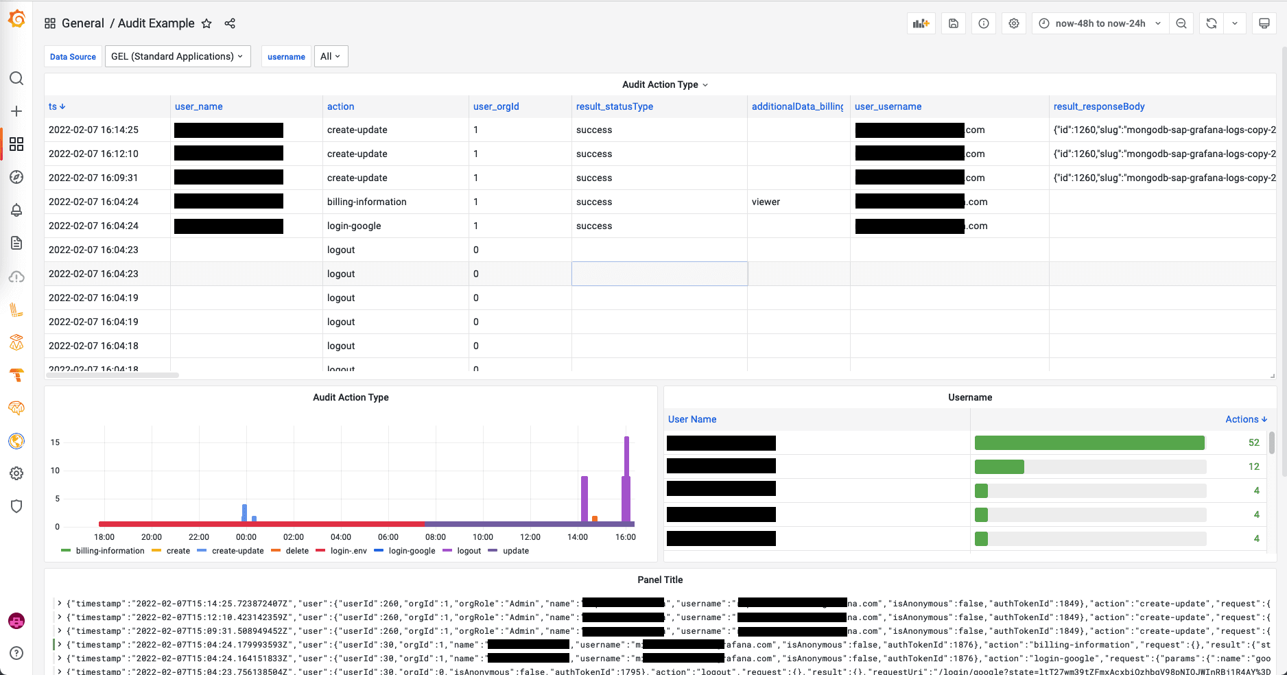

Embedded image
This picture shows an example of an audit dashboard with entries that show that some users were logging in and out, gained access to billing information, or updated data sources.
With this setup, you have endless options and can use the full power of Grafana to manage, aggregate, and visualize its own audit logs.
For example, you could display the number of failed login attempts per user. You could track down who created or deleted certain data sources or who changed the permissions on certain dashboards. A full list of supported actions can be found in the documentation.

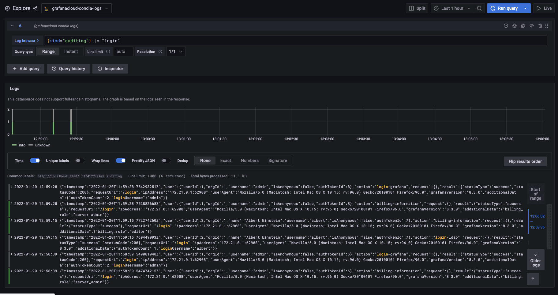

Embedded image
The audit capabilities are well integrated into Grafana itself. Here, you can see a simple Loki query to show the login events to the Grafana instance in the last hour.
