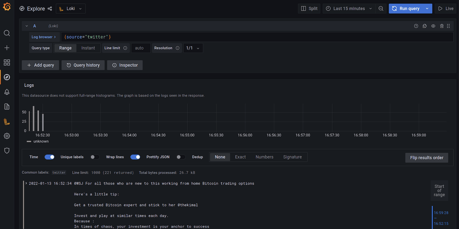

To get started, you just have to open up Grafana and click on the “Explore” icon on the left (it’s the compass). Pick your Loki datasource from the drop-down at the top of the page, and then you can start using LogQL to analyze the tweets.
All LogQL queries are made up of two parts: the log stream selector and the log pipeline. When you push data to Loki, you must also push metadata to describe the data. That metadata is defined as key-value pairs called labels. The Python code used in this post only uses one label, source=twitter. Any querying you do will always use that same label selector:{source="twitter"}
Embedded image
Explore mode with the log stream selector needed to analyze tweets

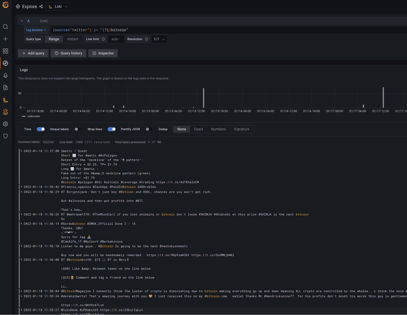

You can also use the full RE2 regex engine (explore the rules here). You can use “flags” for queries that require special rules. The “i” flag makes a query case insensitive. So if you wanted to do a case insensitive search for bitcoin or Bitcoin or BITCOIN, etc,  you would use:
{source="twitter"} |~ "(?i)bitcoin"
Embedded image
A case insensitive query for the word “bitcoin”

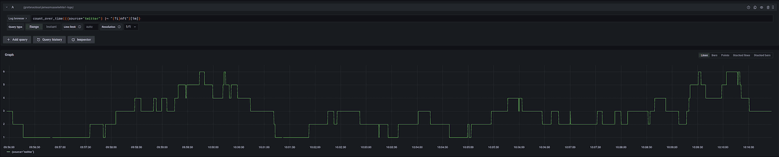

Grafana Loki allows you to create metrics from your LogQL queries. For instance, instead of just looking for particular content in the tweets, we can count the number of times that particular content shows up.
You can use the count_over_time function to count the number of instances of a word over a certain time period. If you were curious how often people are saying “NFT” in one minute intervals (spoiler: it’s way more often that “bitcoin”), then you could use:
count_over_time(({source="twitter"} |~ "(?i)nft")[1m])
Embedded image
The number of times that the case-insensitive phrase “nft” was found in one-minute intervals

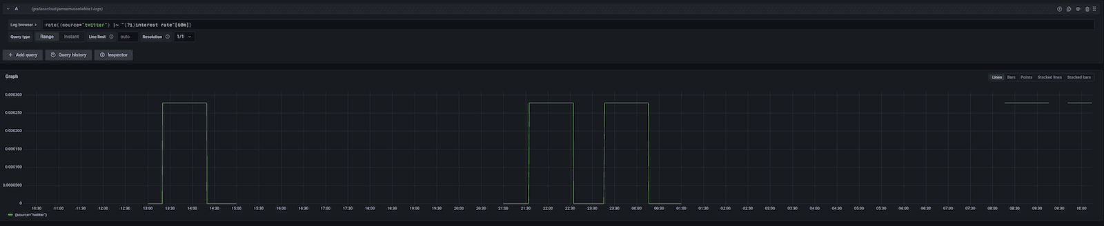

Most of the time it’s more interesting to understand the rate of something happening, as opposed to the absolute number of times something happens. Grafana Loki makes that just as easy. If you wanted the rate of incidence of the phrase “interest rate” over one-hour intervals, you could find out quickly with:
rate({source="twitter"} |~ "(?i)interest rate"[60m])
Embedded image
How often are people saying “interest rate” over 60-minute periods
