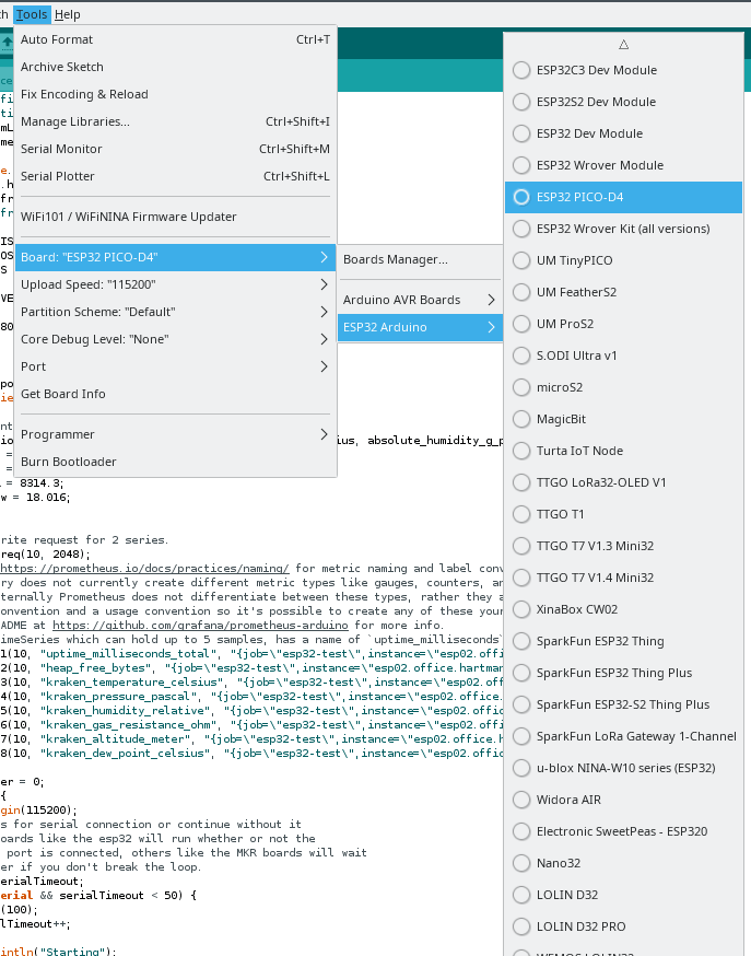

Once that’s done, it’s time to flash the ESP32. I have been using Arduino IDE for this project. While the IDE is admittedly somewhat cumbersome in some regards, it offers the widest range of libraries for this type of project. In a future blog post, I might be able to share a more integrated workflow for deploying lots of sensors at once.
Clone https://github.com/RichiH/kraken/ and open bme_680 with Arduino IDE.
Set up Arduino IDE
  1. Add local support for ESP32 boards: Open “File” -> “Preferences” and copy https://raw.githubusercontent.com/espressif/arduino-esp32/gh-pages/package_esp32_dev_index.json into “Additional Board Manager URLs.”
  1. Select the correct board from “Tools” -> “Board” -> “ESP32 Arduino”:
  1. Select the serial speed from “Tools” -> “Upload Speed” -> “115200”:
  1. Select the correct port from “Tools” -> “Port.” On Linux, the correct port should look like /dev/ttyUSB?. dmesg can help you find the right one. On some systems, you may need to add your user to usergroups like modem; if all else fails, on a single user system, you can simply use chmod 777 /dev/ttyUSB*. Not recommended, but it works, and a reboot or device reconnect will reset it.
