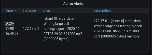

Embedded image
This is what an alert looks like. You can see that a user can find all the relevant details in the description.
