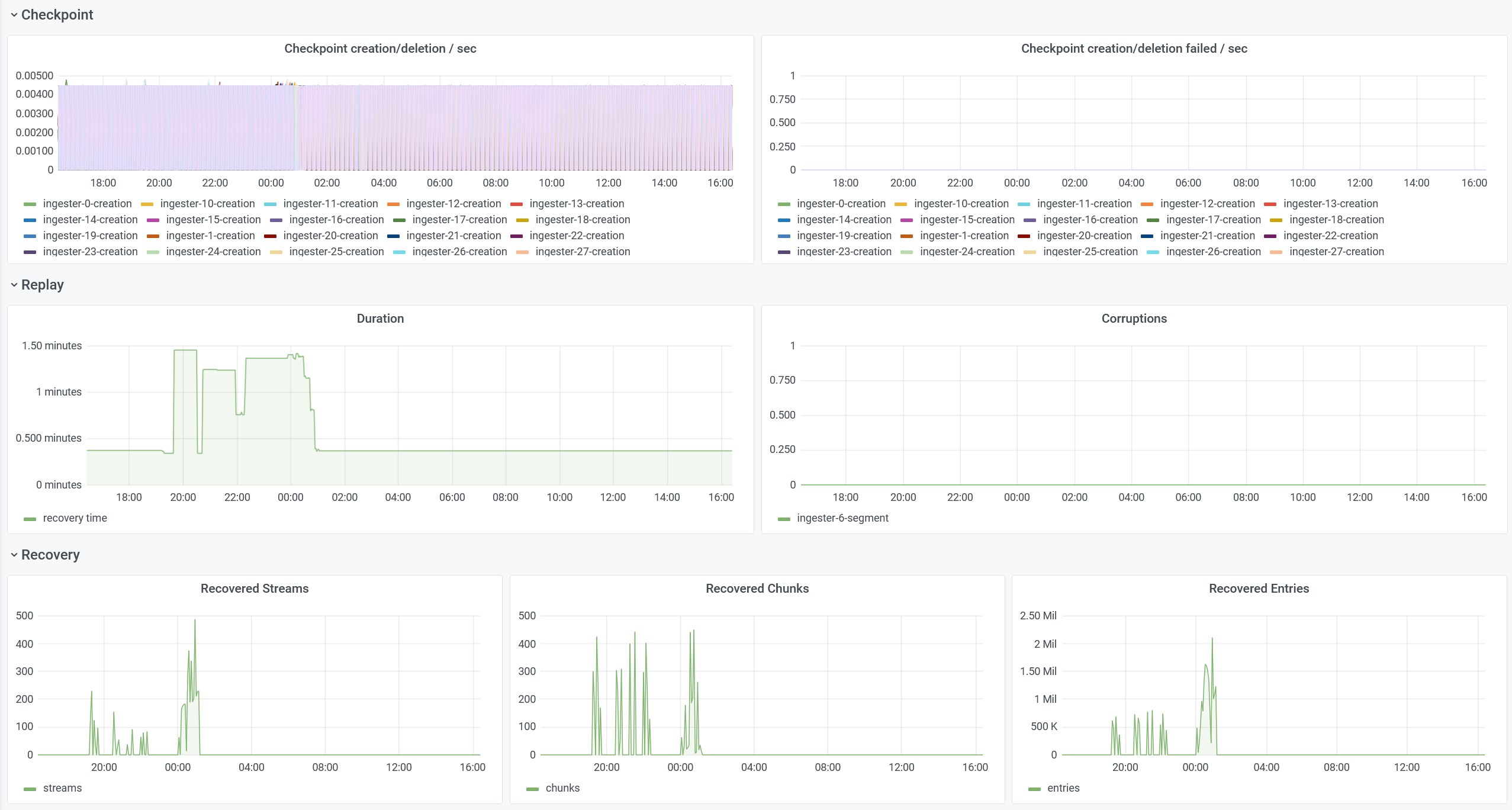

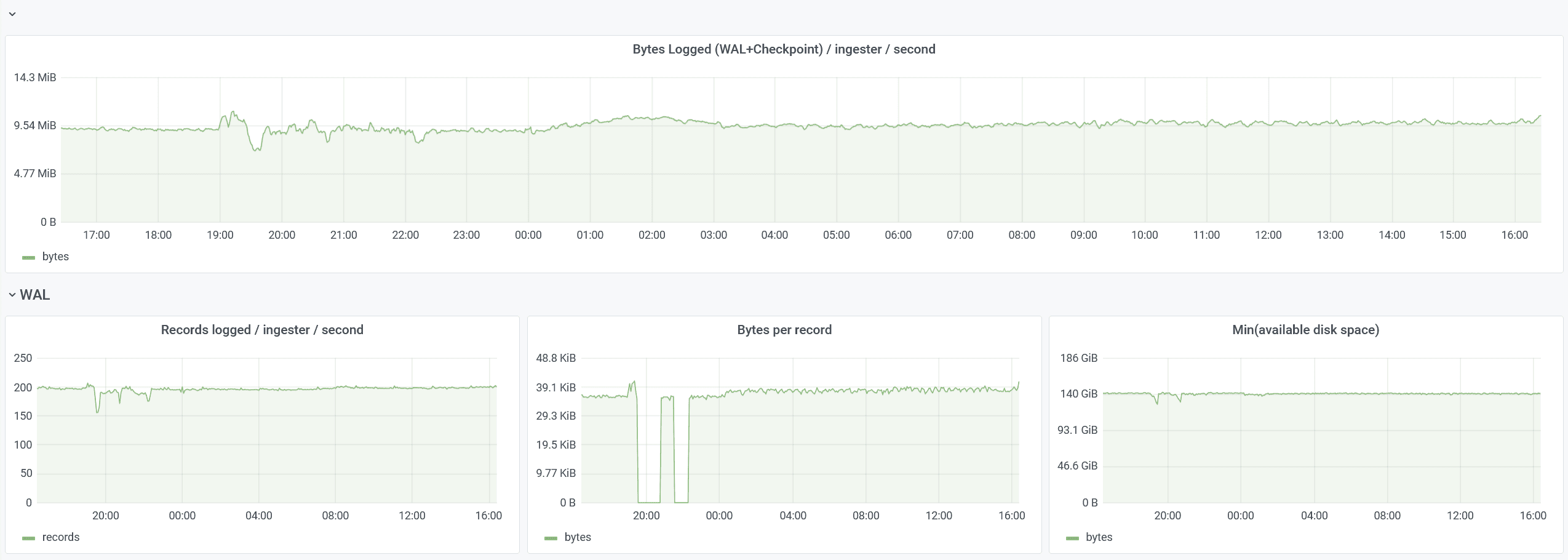

WAL
The second technique we’ll talk about is the Write Ahead Log (WAL). This is a new feature, available starting in the 2.2 release, which helps ensure Loki doesn’t drop logs by writing all incoming data to disk before acknowledging the write. If an ingester dies for some reason, it will replay this log upon startup, safely ensuring all the data it previously had in memory has been recovered.
Pro tip: When using the WAL, we suggest giving it an isolated disk if possible. Doing so can help prevent the WAL from being adversely affected by unrelated disk pressure, noisy neighbors, etc. Also make sure the disk write performance can handle the rate of incoming data into an ingester. Loki can be scaled horizontally to reduce this pressure.
Essential configuration settings
Here are a few WAL configurations we suggest that reside in a subsection of the ingester_config:
  1. enabled We suggest enabling the WAL as a second layer of protection against data loss.
  2. dir We suggest specifying a directory on an isolated disk for the WAL to use.
  3. replay_memory_ceiling It’s possible that after an outage scenario, a WAL is larger than the available memory of an ingester. Fortunately, the WAL implements a form of backpressure, allowing large replays even when memory is constrained. This replay_memory_ceiling config is the threshold at which the WAL will pause replaying and signal the ingester to flush its data before continuing. Because this is a less efficient operation, we suggest setting this threshold to a high, but reasonable, bound, or about 75% of the ingester’s normal memory limits. For our deployments, this is often around 10GB.
