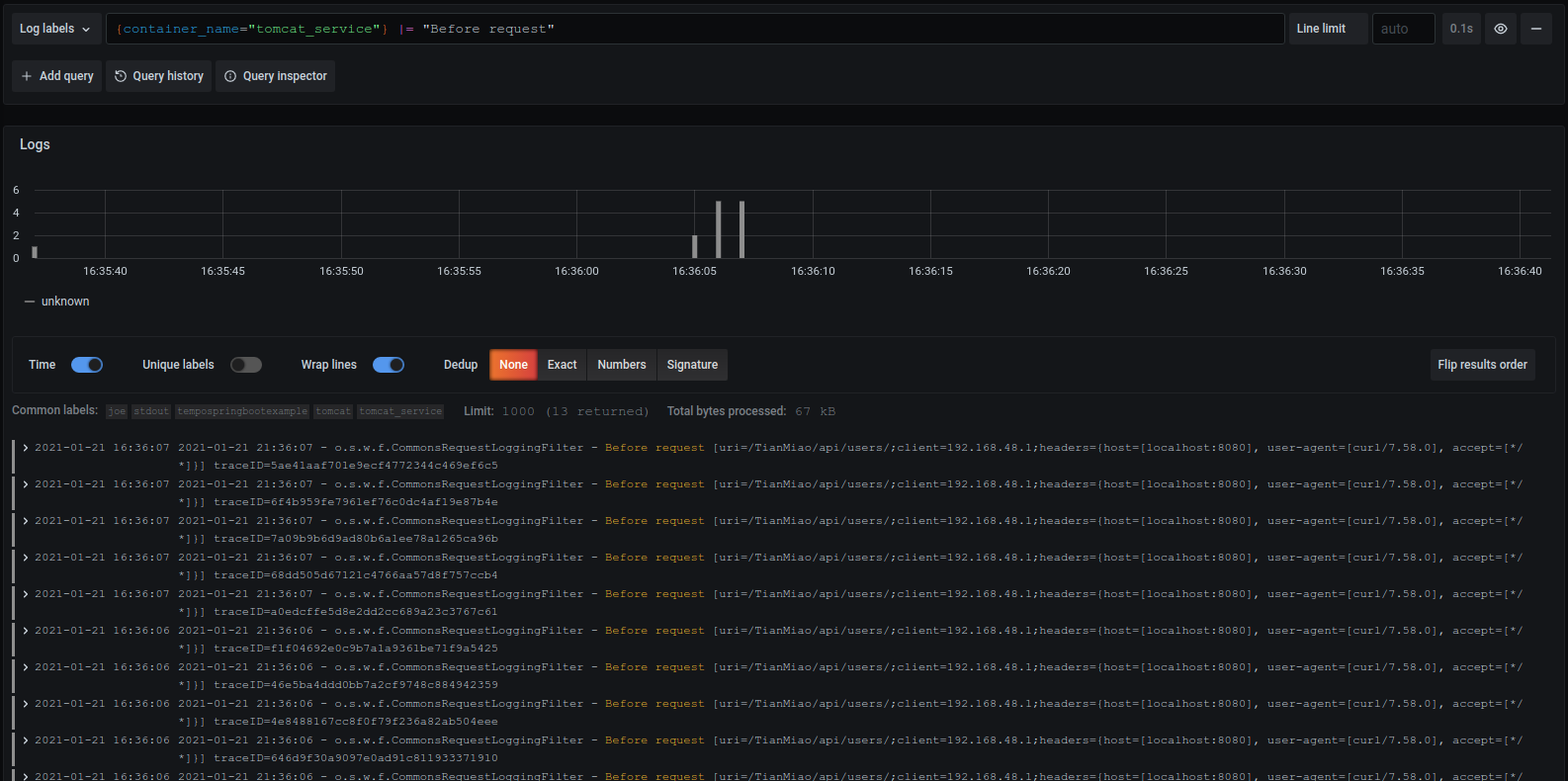

    -Dlogging.level.org.springframework.web.filter.CommonsRequestLoggingFilter=DEBUG
    '-Dlogging.pattern.console=%d{yyyy-MM-dd HH:mm:ss} - %logger{36} - %msg traceID=%X{traceId} %n'
The first gets the RequestLoggingFilter to log every request as desired, and the second formats the log line to include a trace id.

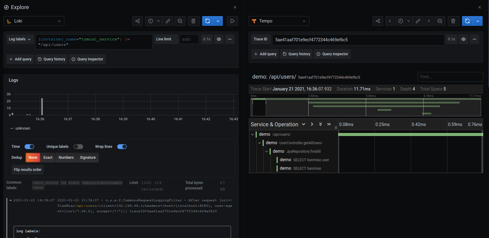

After I rebuilt the war file with maven, the following log lines began appearing in Loki:
I assume it has something to do with the @Bean or @Configuration annotation. I didn’t ask questions, and Java yielded no answers.
Putting it all together
Now that we have our logs in Loki and our traces in Tempo, we can easily search for traces and then jump directly to them via a handy link in Grafana:

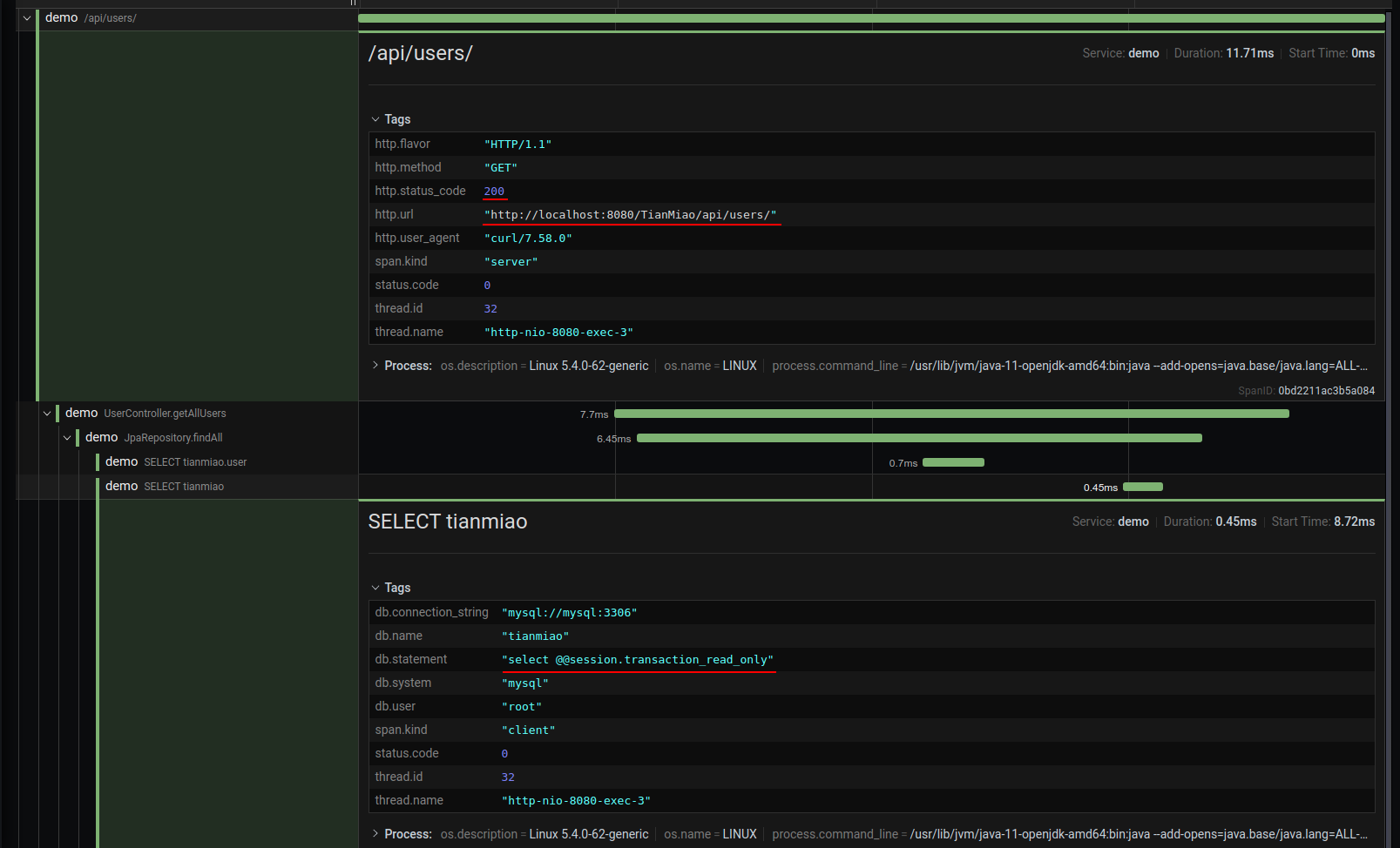

Looking closer at the trace, we can see valuable information such as the path requested and the query executed. Nice work, OTel Java folks!
