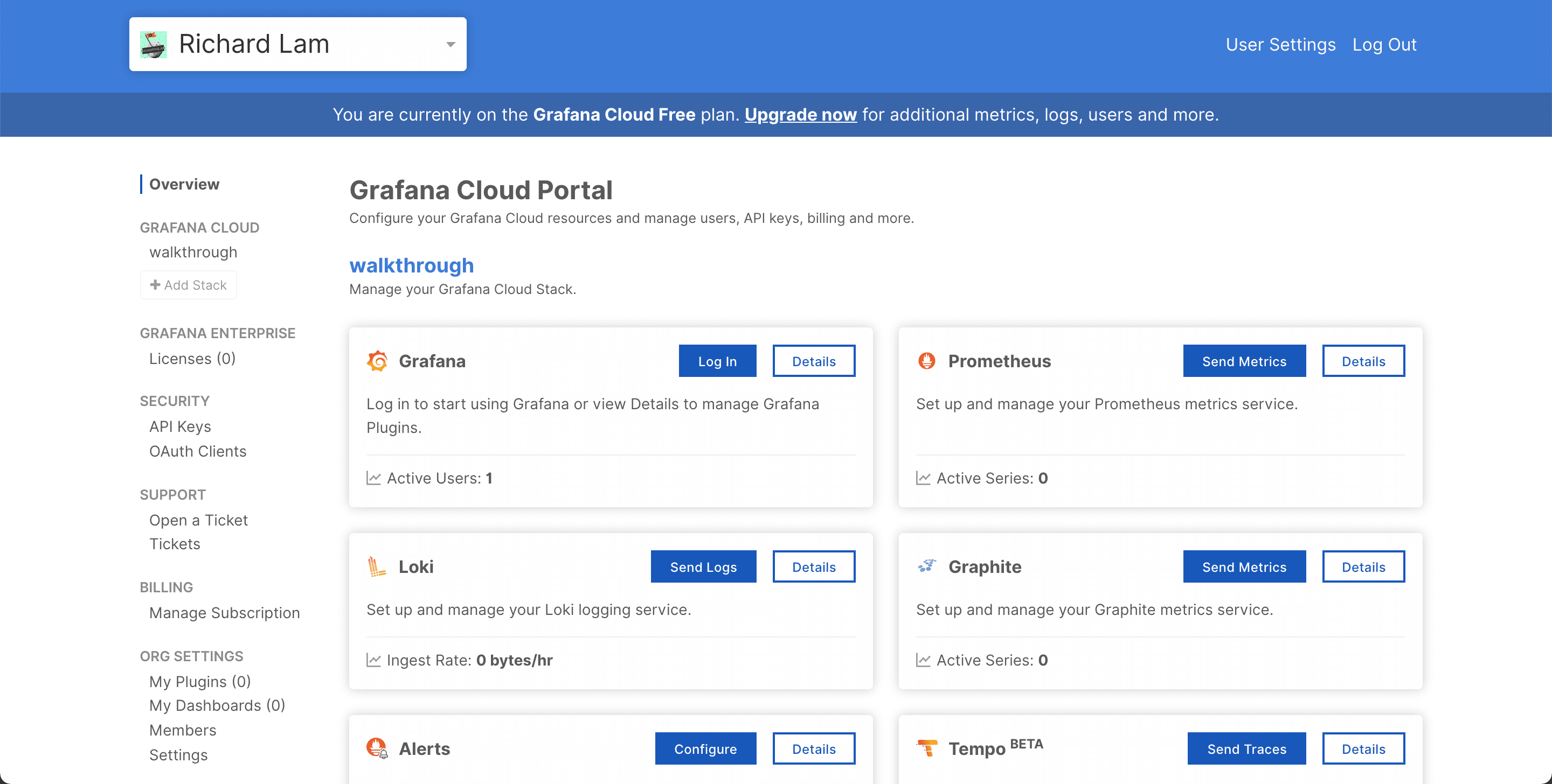

  1. Log in to Grafana.com to enter the Cloud Portal and click Log In in the Grafana box (if you are doing this at a later time than when you signed up for your account).
Embedded image

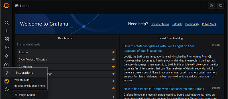

  1. The first time you log in to Grafana from the Cloud Portal you are automatically taken to the Walkthrough.
  2. If this is not your first time, hover over the Integrations logo (it looks like a lightning bolt) in the left column and click Walkthrough.

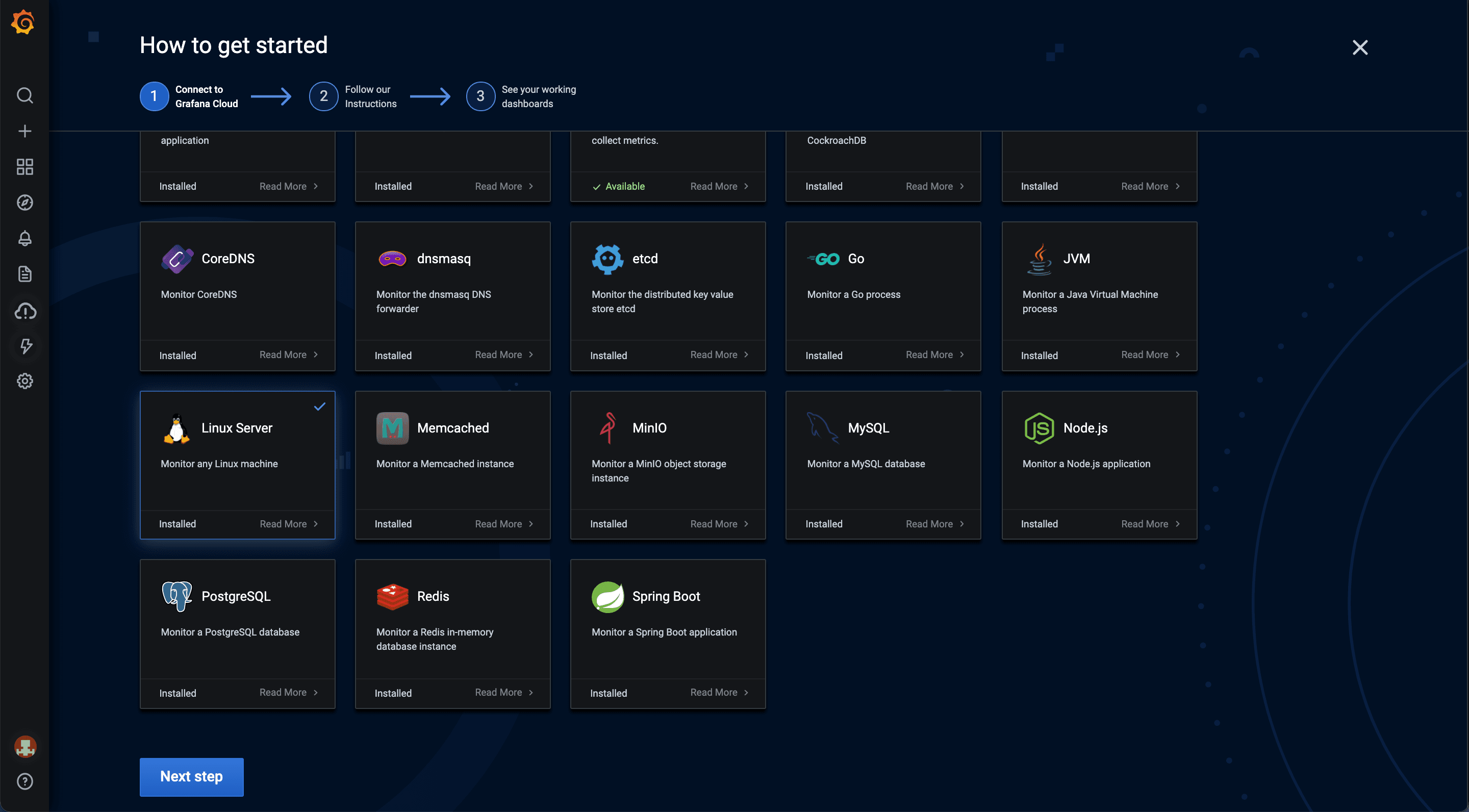

  1. You will see a list of available Integrations. Select Linux Server then scroll down to the bottom of the list and click Next step.

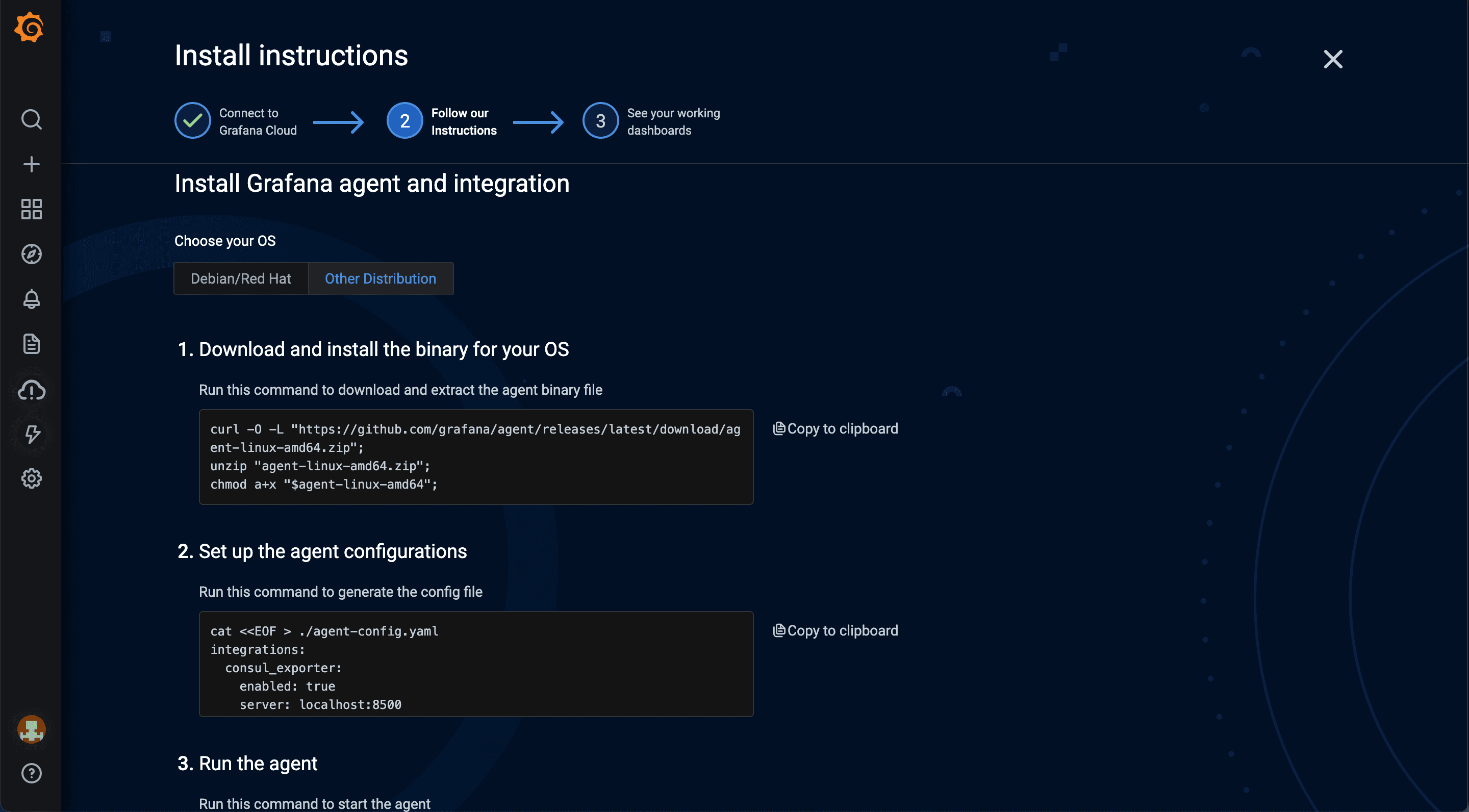

  1. In order to install the Linux integration, you must first install and configure the Grafana Agent on your Raspberry Pi. Click Other Distribution under Choose your OS, and follow the instructions you are provided. These will also help you generate the agent config file.
Note:For the Raspberry Pi, you may need to replace amd64 in any commands where it appears with armv6, armv7, or arm64 depending on which Raspberry Pi you are using and whether you are using a 32-bit or 64-bit operating system. Generally the 64-bit can use amd64. See this wikipedia page for a list of Raspberry Pi hardware versions and which Arm architecture each uses.

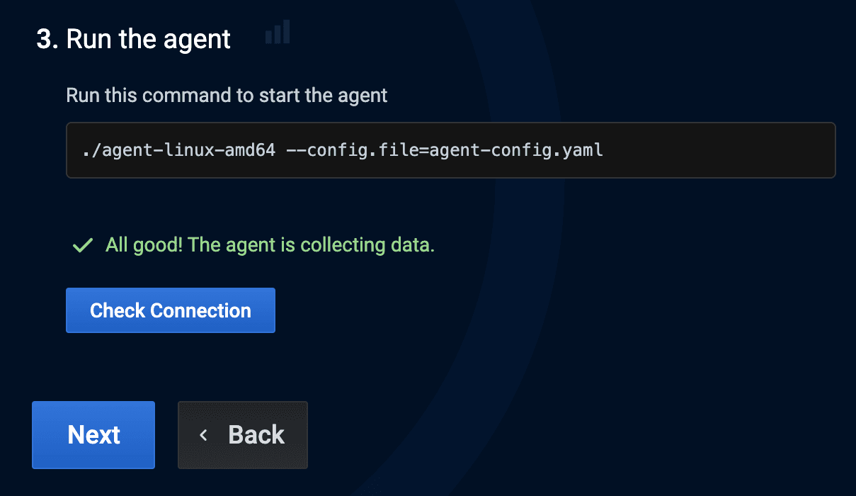

  1. The final command you enter will start the agent running on your Raspberry Pi.
  2. When you are done installing the agent and it is running, click Check Connection to confirm the agent is properly sending metrics to Grafana Cloud. Later, after you get everything up and running, you may want to make the agent run as a service, so you don’t have to start it from the command line every time your system boots up.
  3. If metrics are being received, you will receive a notification. Click Next.

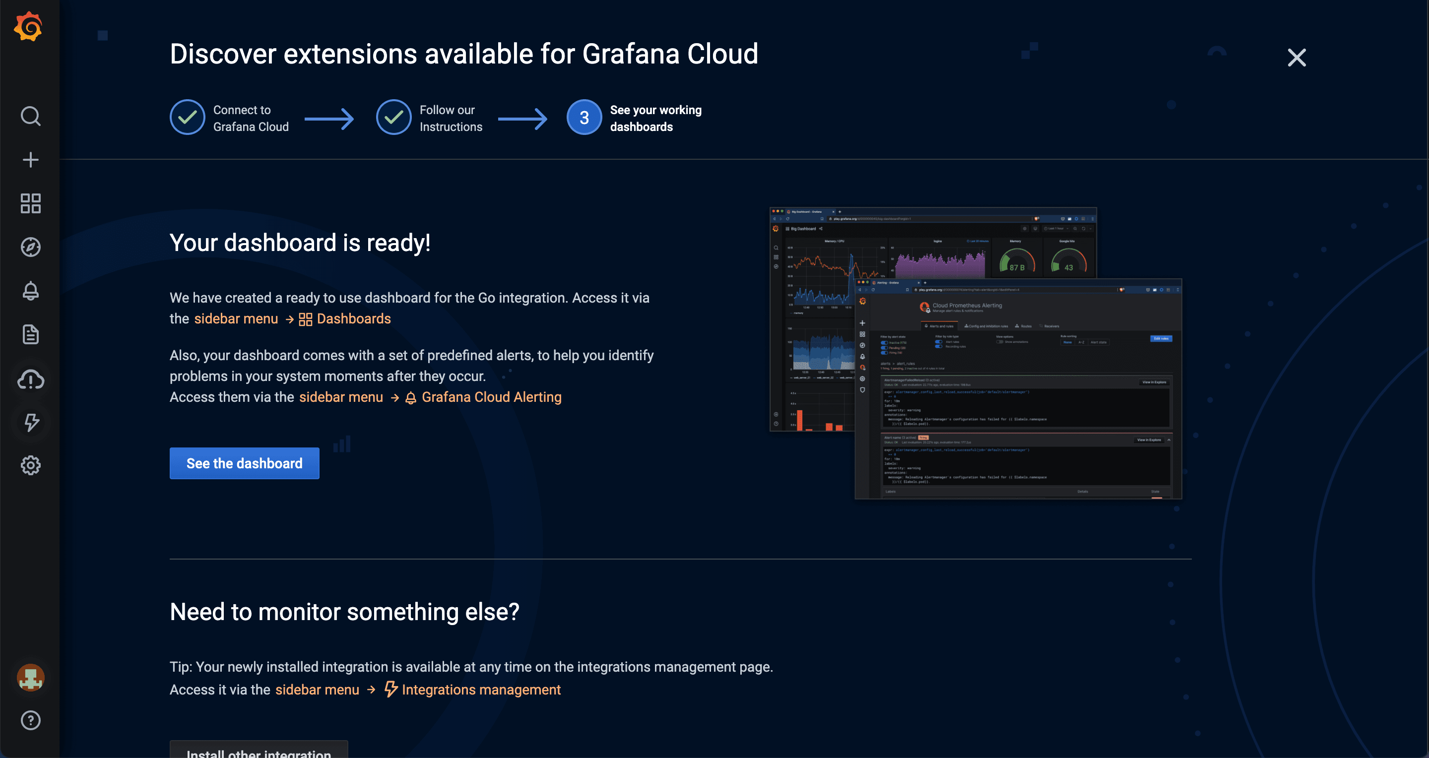

  1. Click See the dashboard to view the list of your dashboards.
Embedded image
