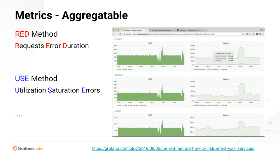

The great strength of metrics? They’re aggregatable. They are aggregations of the behavior of our systems. Therefore, they are easy to query, and they are cheap to store. They are often stored as time series data, which is just a timestamp and a value. And that compresses very nicely, which makes it very easy to store and query them very quickly.
Embedded image
Cardinality, however, plays a major factor when discussing metrics, especially when there is too much of it. Cardinality explosions occur when too many metrics or labels are added, which, in turn, increases the cost of storage, the size of the index, and the query speed. In short, you’ve defeated the point of metrics.
Metrics are meant to be simple. We have small indexes that cover enormous amounts of data, and small amounts of data that cover an enormous range of behavior in our applications. For that reason, we want metrics to be aggregated. That is the point of metrics; that is why we store them and query them.

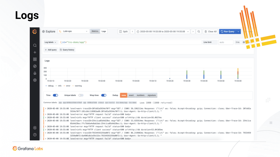

Grafana Labs uses Grafana Loki, a horizontally scalable, highly available, multi-tenant log aggregation system inspired by Prometheus. It is designed to be very cost-effective and easy to operate. It does not index the contents of the logs, but rather a set of labels for each log stream.
The query and logs shown above are from one of Grafana Labs’ applications. Users can look at a single service and query all the logs that are occurring within the service. They can also see a series’ “events.” Or they could query across a lot of services and sometimes grab a whole set of services, looking for specific errors or errors in general.
But in all cases, logs are a series of events that occur sequentially in time.
One of the most common patterns is that someone gets an alert or someone may notice something is wrong with a metric on a dashboard at an overview aggregation level. Often the next steps would be to write some queries to roughly find out what’s wrong in the metrics engine and what services are having issues. Then logs can be used to retrieve more detailed information about what’s wrong with that specific service.
While metrics and logs can work together to pinpoint a problem, they both lack important elements. Metrics, though good for aggregations, lack fine-grained information. Logs are good at revealing what happened sequentially in an application, or maybe even across applications, but they don’t show how a single request perhaps behaves inside of a service.
It’s difficult to track a request to know why a request is slow. Logs will tell us why a service is having issues, but maybe not why a given request is having issues.

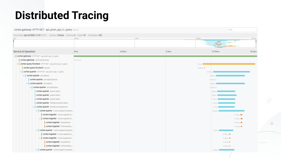

Distributed tracing is a way to track a single request and log a single request as it crosses through all of the services in your infrastructure.
The slide above highlights a Prometheus query that’s hitting Cortex, the scalable Prometheus project that has advanced to incubation within CNCF. The request was passed down through four different services in about 18 milliseconds, and there is a lot of detail about how the request is handled. If this request took 5 seconds or 10 seconds or something awful, then the trace could tell us exactly where it spent those 10 seconds — and perhaps why it spent time in certain areas — to help us understand what’s going on in an infrastructure or how to fix a problem.
In tracing, a span is a representation of a unit of work in a given application, and they are represented by all the horizontal bars in the query above. If we made a query to a backend, to a database, or to a caching server, we could wrap those in spans to get information about how long each of those pieces took.
Spans are related to each other in a handful of different ways, but primarily by a parent-child relationship. So in the Cortex query, there are two related spans in which promqlEval is the parent and promqlPrepare is a child. This relationship is how our tracing backend is able to take all these spans and actually rebuild them into a single trace and return that trace when we ask for it.

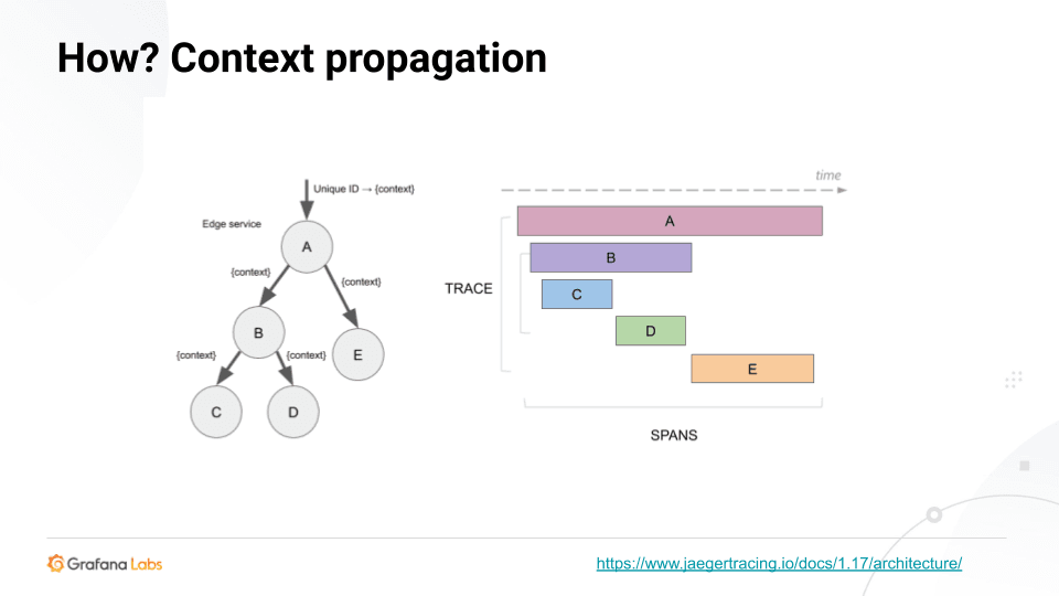

Whether there are 10 services or 100 services, they’re all receiving requests, and they’re all building spans that describe what the request is doing. All these spans are then sent or streamed to the backend independently. So the question becomes, how do we rebuild those?
That’s where context propagation comes in.
Developers can purposefully propagate context through an HTTP request to perform functions such as tracing. That context is passed down through all the functions as you execute your request and then should also be passed to the next set of services.
This context is where tracing information is buried, such as the trace ID or the parent span ID, which help rebuild the spans when we send them to the backend. So every time you create a span, it’s going to check the context, and it’s going to see if there’s an existing span or any existing trace. If there is, it will become a part of that trace. It will use that trace ID, and that will allow the backend to rebuild.
Between services, the context will be attached to HTTP headers or gRPC headers and metadata about our query to the backend. Then that metadata will propagate the trace across services. So in-service we’re using an in-memory context object. Cross-service, we’re using headers or other metadata associated with our query.
