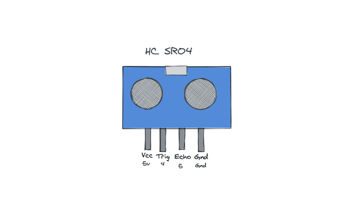

The HC-SR04 ultrasonic distance sensor This sensor provides 2cm to 4m of measurement function, with accuracy around 3mm. This will be used to measure how far your sourdough starter is from the lid and calculate its rise and/or fall.
The HC-SR04 has four pins that you’re going to connect to development board like this:
HC-SR04 sensor
HC-SR04 sensor
  • Vcc pin to 5V on board
  • Trig pin that sends the signal to pin 4 on board
  • Echo pin that receives signal to pin 5on board
  • Gnd pin to Gnd on board

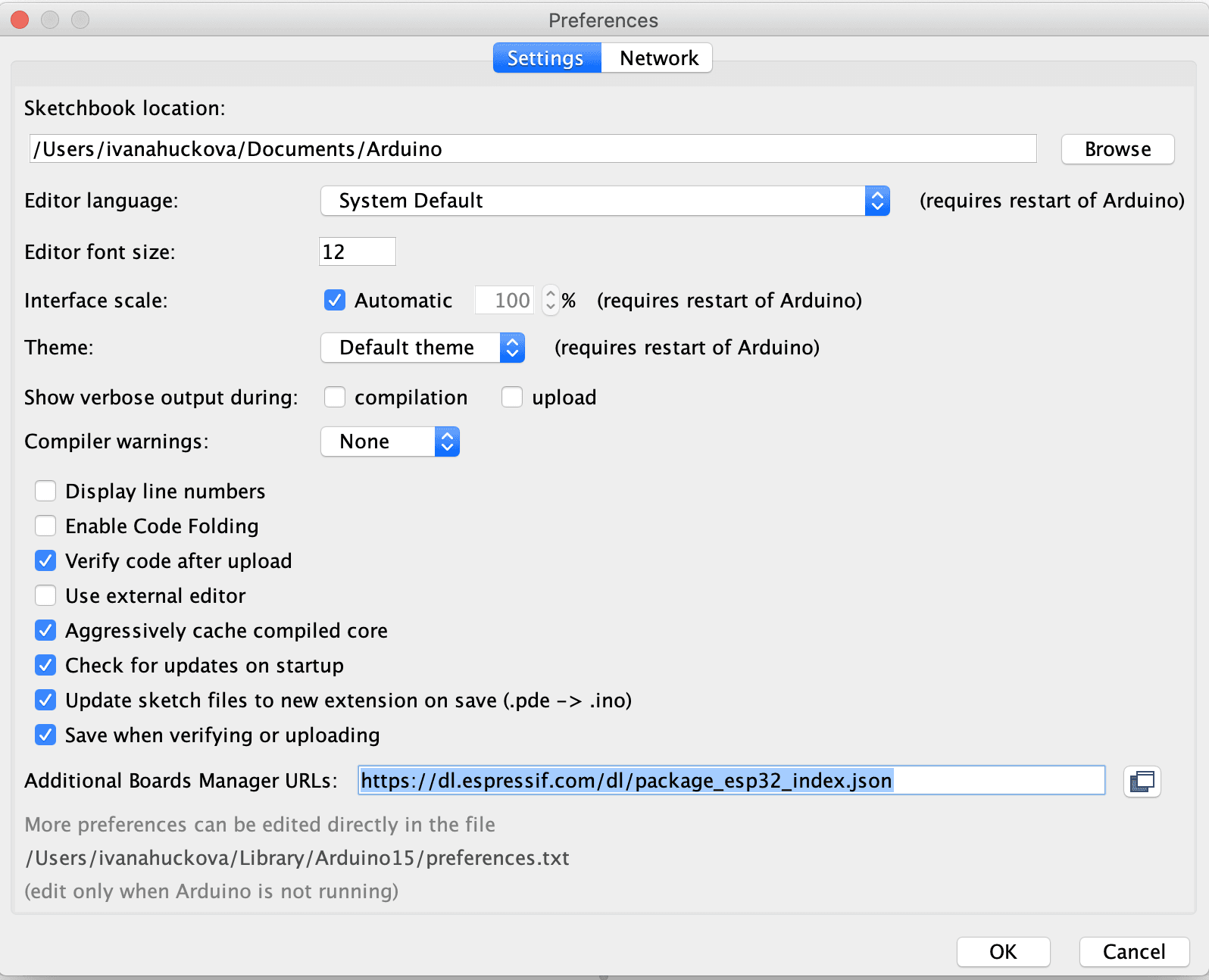

Open your Arduino IDE. If you are using an ESP32 board as I have recommended (and not an Arduino board), you need to add a board definition that adds support for your EP32 board. Go to Arduino > Preferences and add url https://dl.espressif.com/dl/package_esp32_index.json to the Additional Boards Manager URLs input. This open-source board definition adds support for programming ESP32 boards.

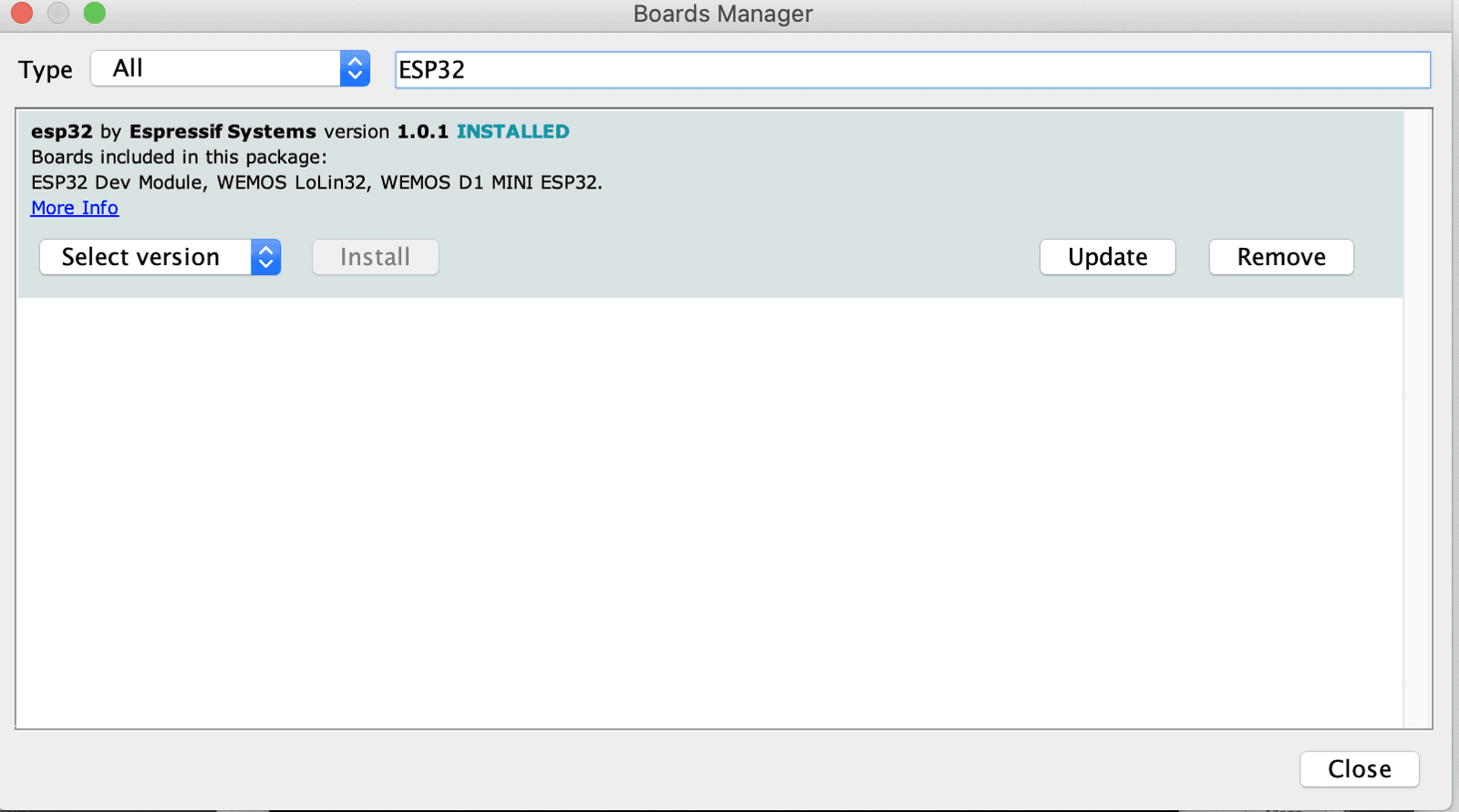

Then go to Tools > Boards > Boards Manager and add ESP32 board manager.

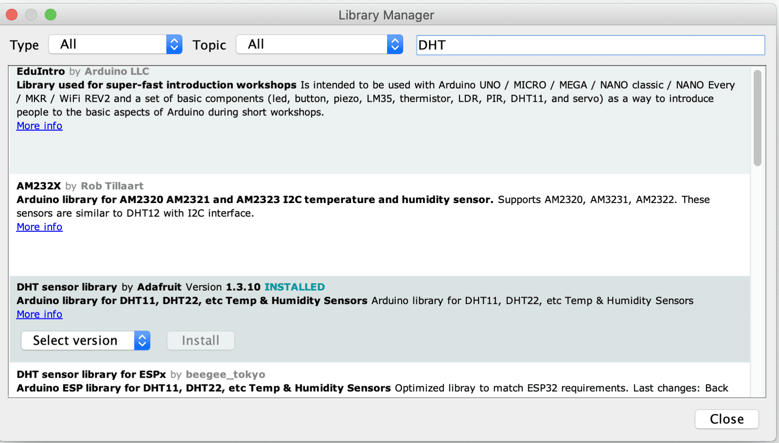

Step 2: Add libraries
For this project you’re going to use following libraries:
  • DHT sensor library by Adafruit
  • Adafruit Unified Sensor by Adafruit
  • NTP Client by Fabrice Weinberg
  • HCSR04 by Martin Sosic
Go to Sketch > Include Library > Library Manager and install all of these libraries. Make sure that you have all of them installed before moving to the next steps.

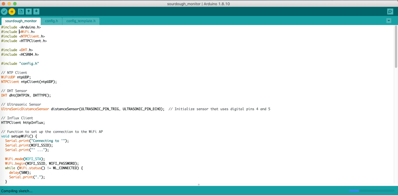

File sourdough_monitor.ino:
Below you can find the program code with the comments explaining each section.
Step 4: Uploading and running the program to ESP32
Let’s make this all come together! 💪

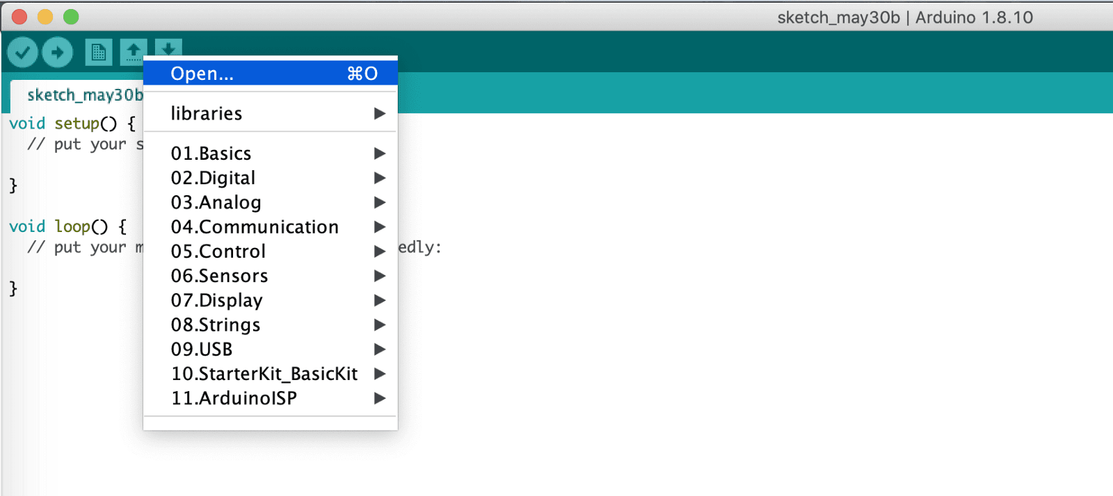

Click on the open button (arrow pointing up), choose Open, find your sourdough_monitor.ino file and open it.
Then go to Tools > Serial Monitor and open it. This will allow you to see the debug output from the board. Set the port speed on the bottom to 115200.
And finally, use the Upload button (the arrow pointing to the right) in the UI to build and upload the program to the ESP32.

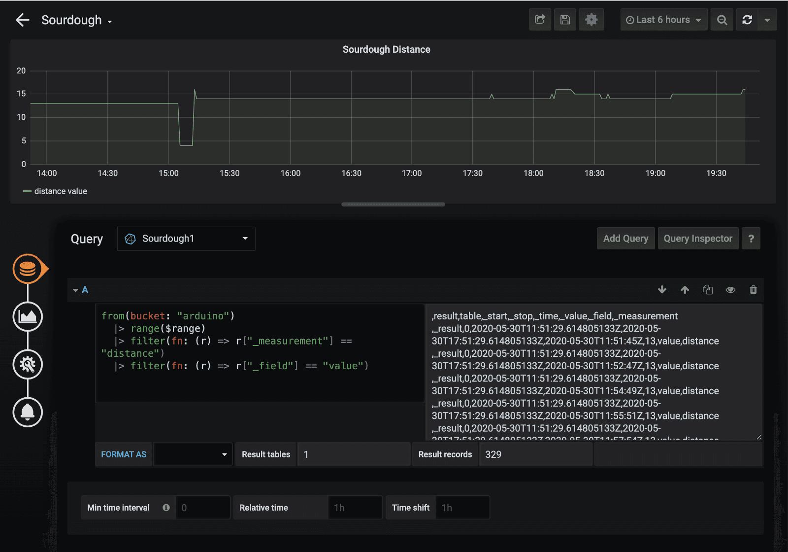

Unfortunately, Influx data source doesn’t provide authentication with a token, so you’ll need to add the Flux [BETA] data source plugin. Fill out your organization I.D., bucket and token, and save the data source.
Next, create dashboards. Flux data source has a query editor compatible with its cloud interface, and you can just copy-paste queries from your InfluxDB query editor.

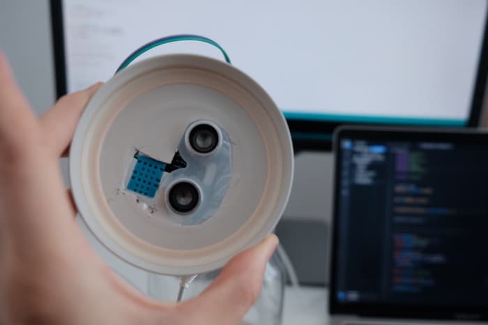

You can put the jar itself aside for the moment, because this is all about the lid. Carefully make one 2cm x 5cm hole in the middle of the lid for the HC-SR04, and a smaller one next to it for the DHT11.
Put the HC-SR04 sensor in a HC-SR04 holder then place the second holder on top of it. Glue the sensor holders with the sensors to the lid. With double-side tape, stick the DHT11 to the lid so it will be facing the inside of the jar.
Sensors in the lid
Sensors in the lid

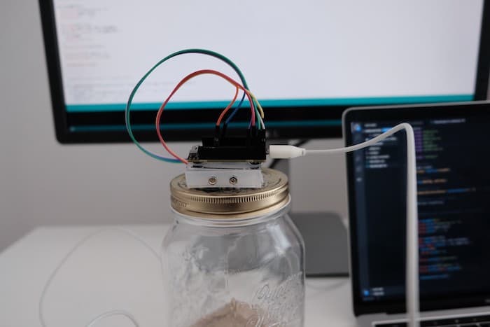

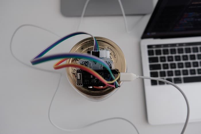

With a glue gun, carefully glue the ESP32 board to the top of the HC-SR04 holder. Make sure that you’re only gluing the extended parts on which the ESP32 board stands, and not the board itself.
Completed hookup
Completed hookup
The photo below is how it should look. (I later added a cover from a cut plastic bottle to make sure that sourdough doesn’t dry out through the holes in the lid.)

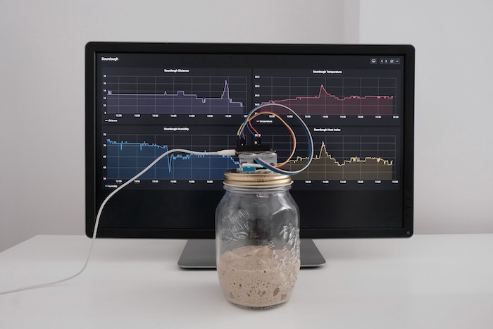

Sourdough starter with monitor
Now you’re ready to add your starter ingredients and begin monitoring the progress.
The bread I made with my monitored started was the best I’ve baked so far. I can’t say that’s connected to the monitoring system because I didn’t change how I’ve been feeding my started, but it tasted really good.
