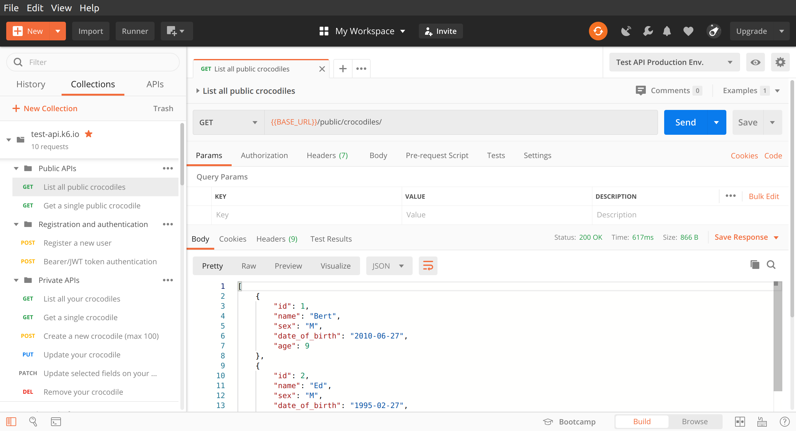

Our test API postman collection
To ease testing of our test API and demonstrate the usage of our Postman to k6 converter, I’ve created a Postman collection with almost all of our test API requests. You’ll see how you can access this Postman collection later on this load testing example.
Test API Postman collection.
This collection includes a set of collection variables, environment variables, pre-scripts, tests, authorization with two different mechanisms, and usages of the Postman Sandbox API.

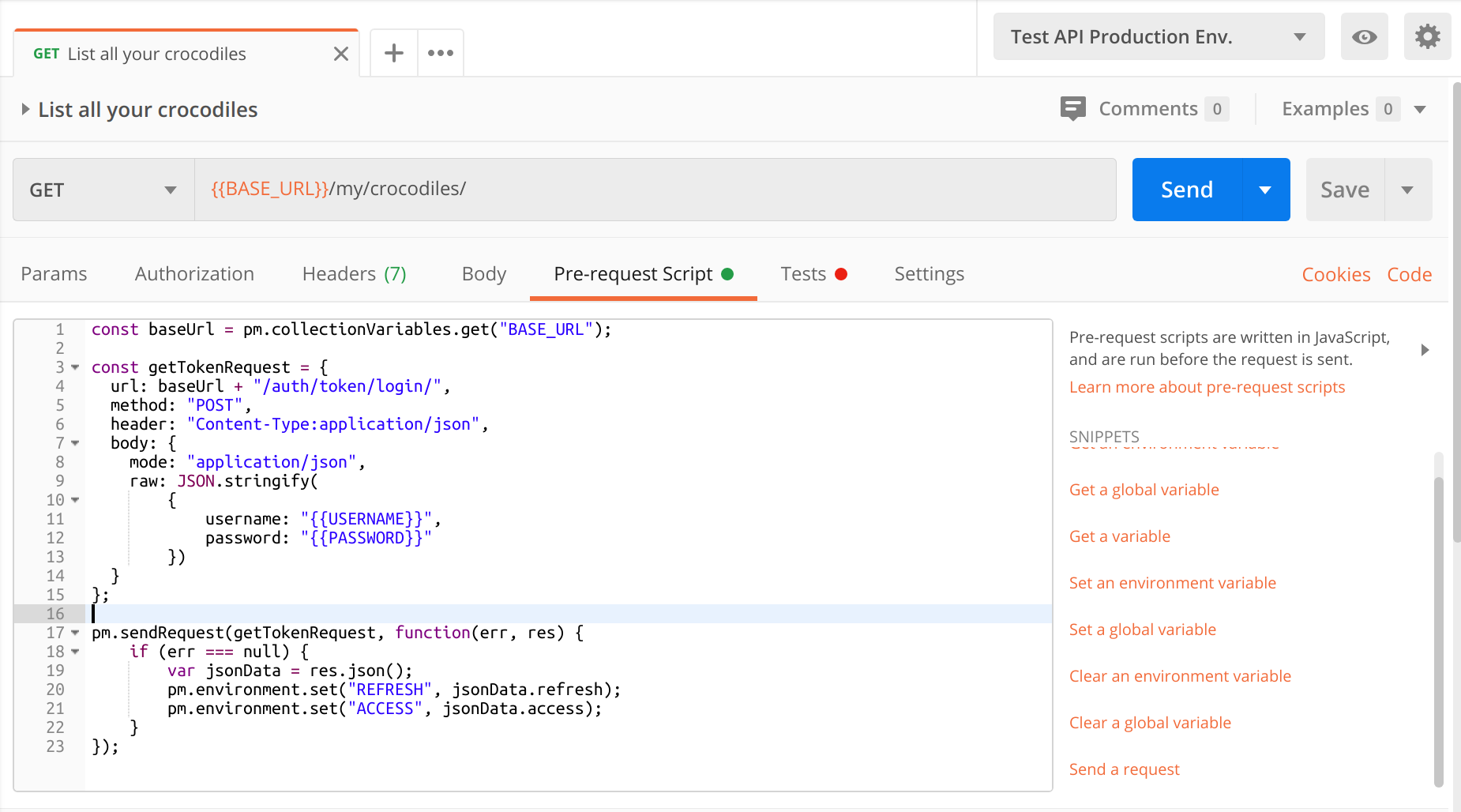

3. What adjustments did you make to the script to make it work?
First, I removed the pre-script containing pm.sendRequest, because it is not supported by the converter. Then, I replaced the jsonData.hasOwnProperty syntax with the equivalent k6 syntax for extracting JSON response informationresponse.json("selector").
Test API Postman collection pre-script.
