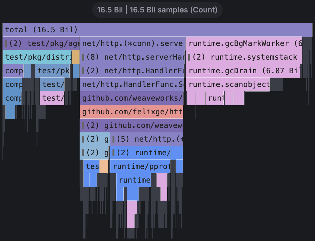

A flame graph takes advantage of the hierarchical nature of profiling data. It condenses data into a format that allows you to easily see which code paths are consuming the most system resources, such as CPU time, allocated objects, or space when measuring memory. Each block in the flame graph represents a function call in a stack and its width represents its value.
Grayed-out sections are a set of functions that represent a relatively small value and they are collapsed together into one section for performance reasons.

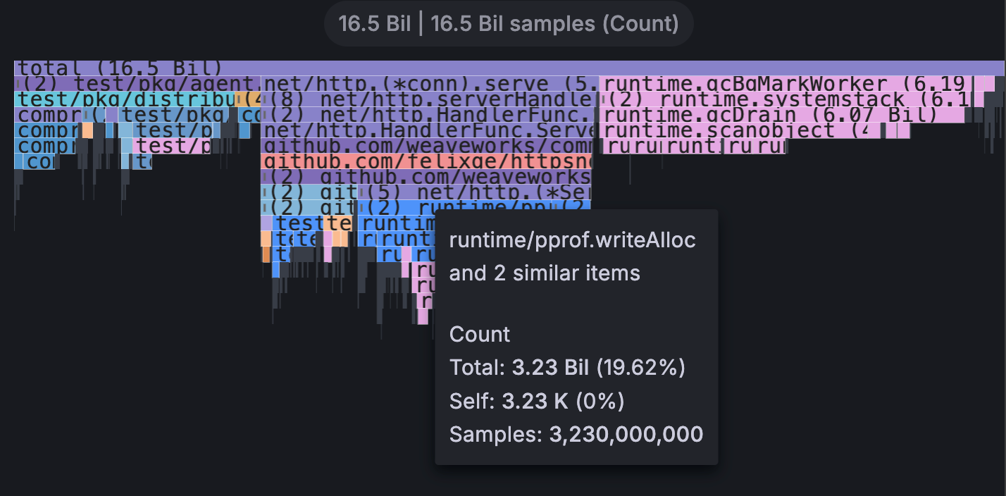

You can hover over a specific function to view a tooltip that shows you additional data about that function, like the function’s value, percentage of total value, and the number of samples with that function.

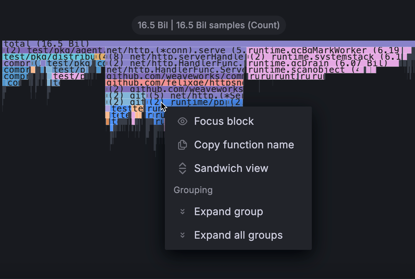

Drop-down actions
You can click a function to show a drop-down menu with additional actions:
- Focus block
- Copy function name
- Sandwich view
![A flame graph visualization with drop-down actions.](/media/docs/grafana/panels-visualizations/flamegraph/screenshot-flamegraph-10.1-dropdown.png)

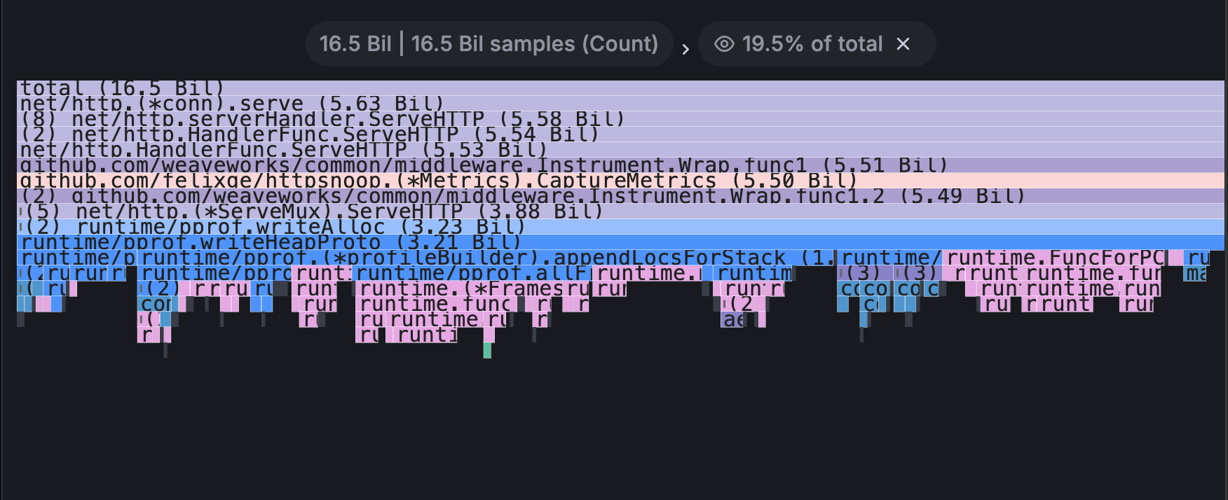

Focus block
When you click Focus block, the block, or function, is set to 100% of the flame graph’s width and all its child functions are shown with their widths updated relative to the width of the parent function. This makes it easier to drill down into smaller parts of the flame graph.
![A flame graph visualization with focus block action selected.](/media/docs/grafana/panels-visualizations/flamegraph/screenshot-flamegraph-10.1-focus.png)

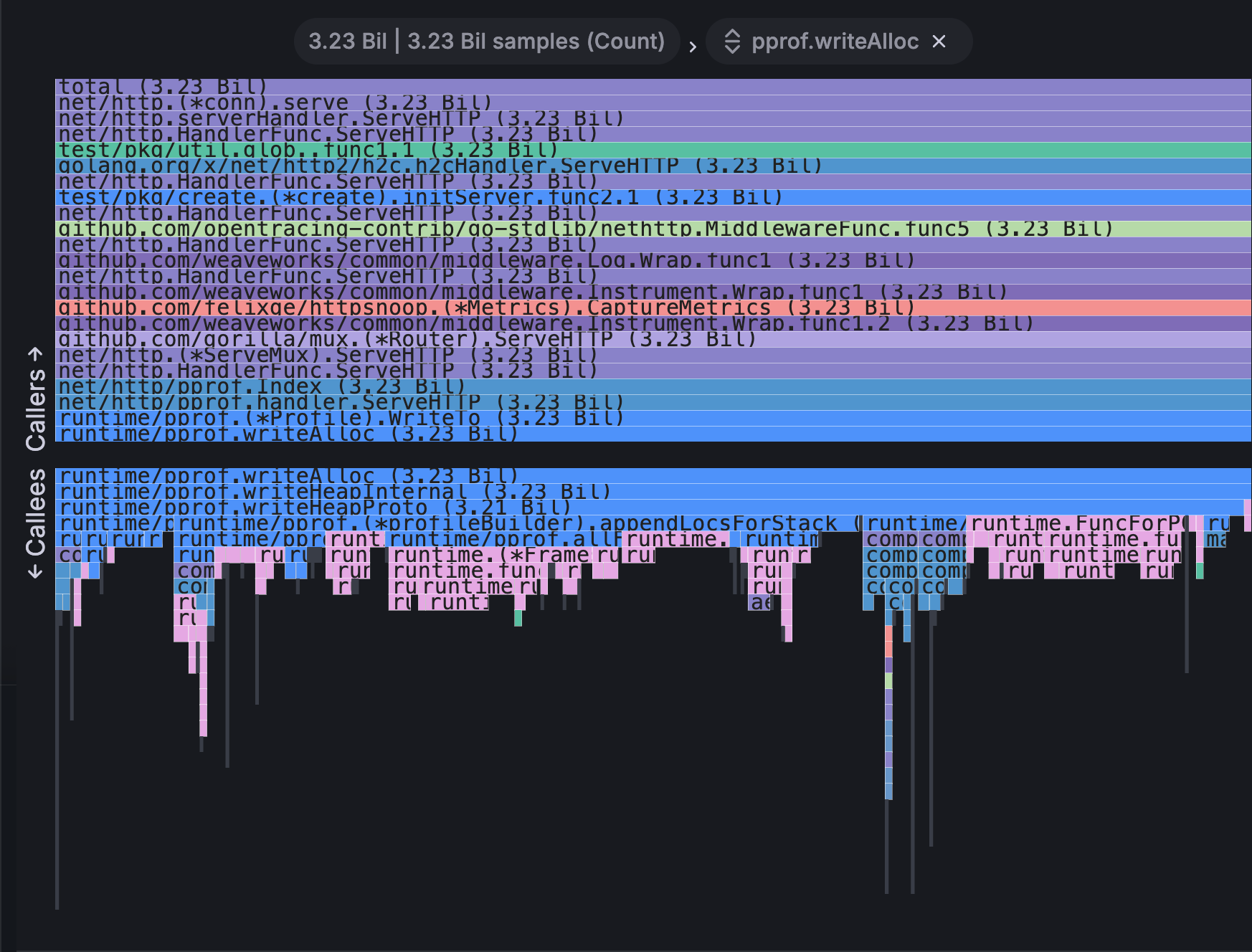

Sandwich view
The sandwich view allows you to show the context of the clicked function. It shows all the function’s callers on the top and all the callees at the bottom. This shows the aggregated context of the function so if the function exists in multiple places in the flame graph, all the contexts are shown and aggregated in the sandwich view.

Status bar
The status bar shows metadata about the flame graph and currently applied modifications, like what part of the graph is in focus or what function is shown in sandwich view. Click the X in the status bar pill to remove that modification.

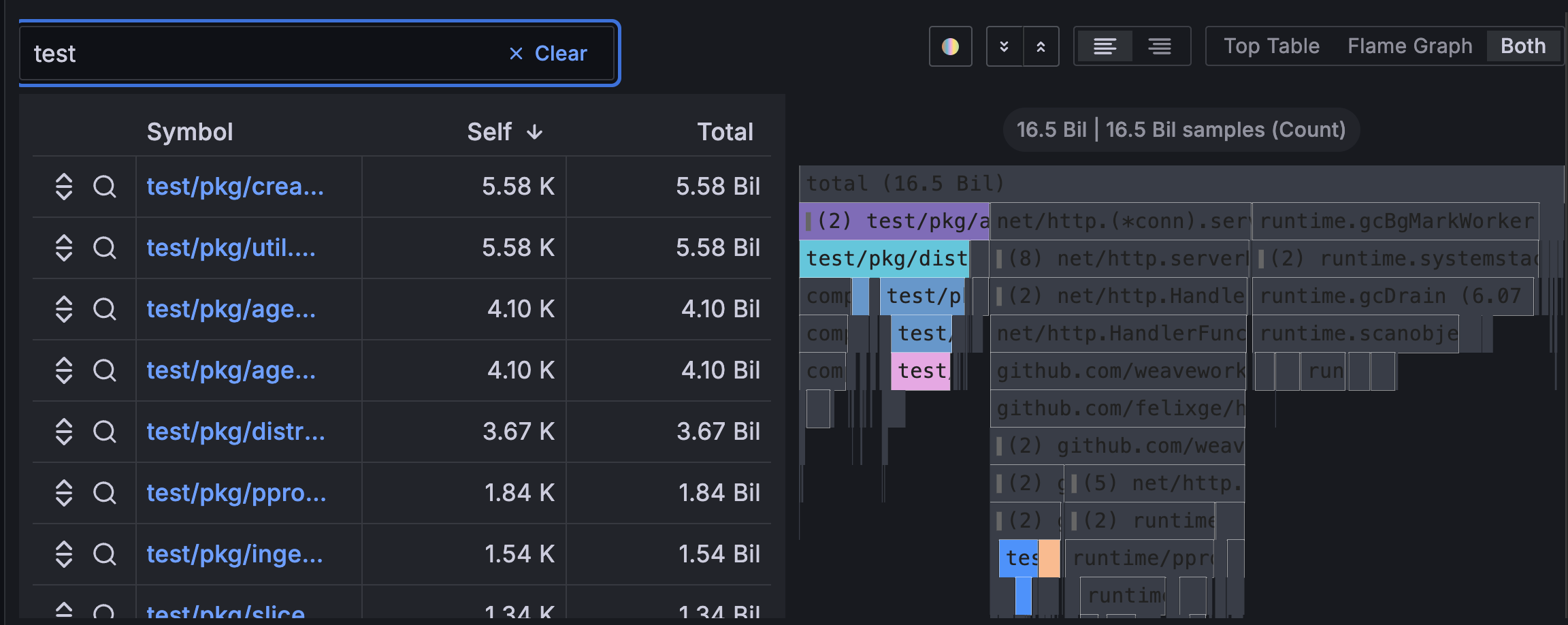

Top table mode

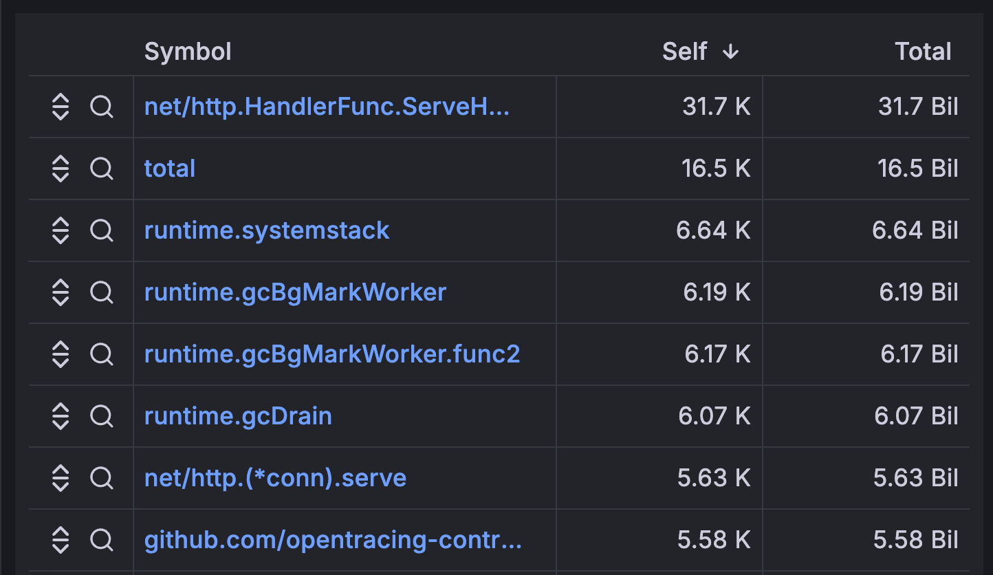

The top table shows the functions from the profile in table format. The table has three columns: symbols, self, and total. The table is sorted by self time by default, but can be reordered by total time or symbol name by clicking the column headers. Each row represents aggregated values for the given function if the function appears in multiple places in the profile.
![Table view](/media/docs/grafana/panels-visualizations/flamegraph/screenshot-flamegraph-10.1-table.png)
There are also action buttons on the left-most side of each row. The first button searches for the function name while second button shows the sandwich view of the function.

Search
You can use the search field to find functions with a particular name. All the functions in the flame graph that match the search will remain colored while the rest of the functions are grayed-out.
![Searching for a function name in a flame graph visualization.](/static/img/docs/flame-graph-panel/flame-graph-search-dark.png)

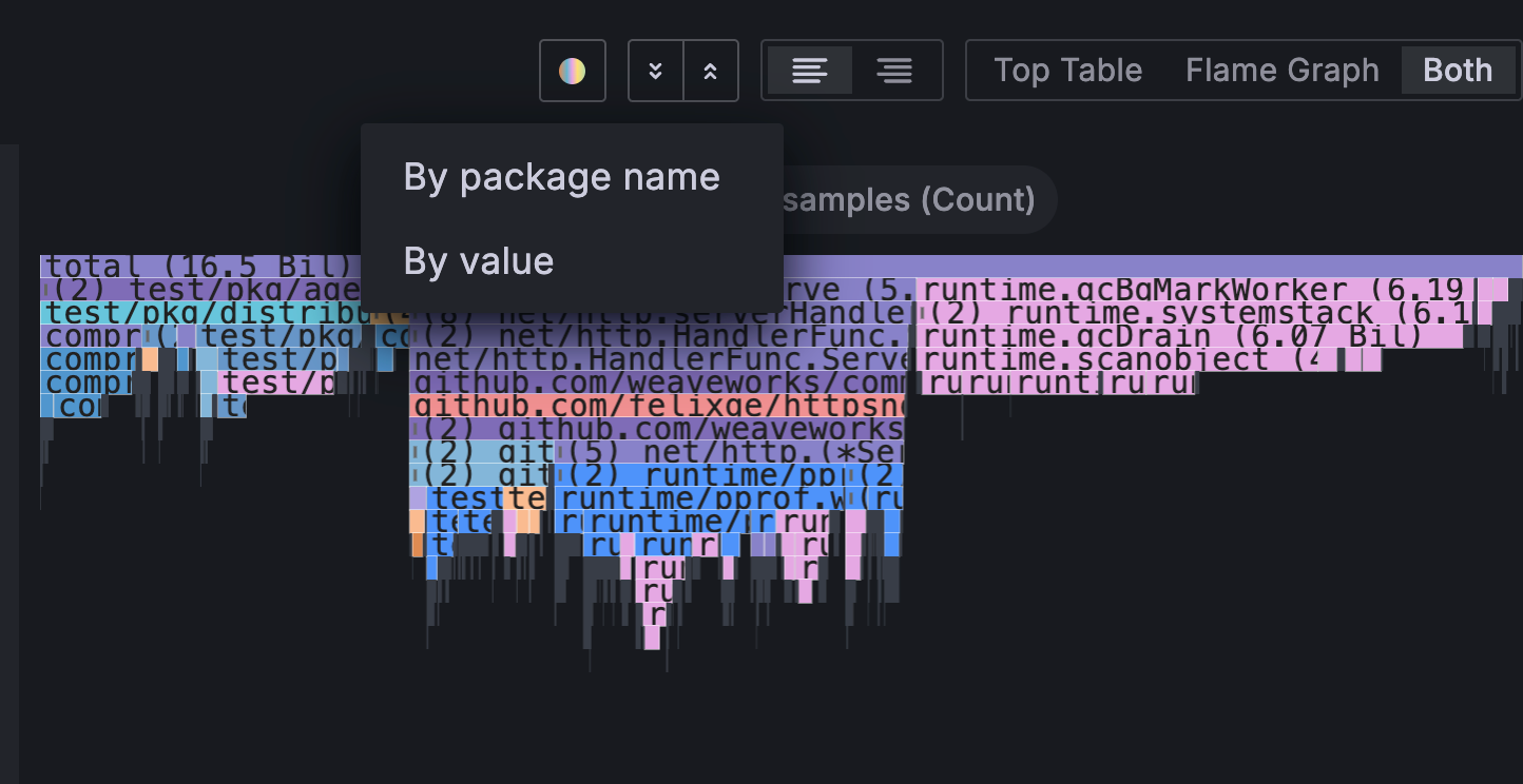

Color schema picker
You can switch between coloring functions by their value or by their package name to visually tie functions from the same package together.

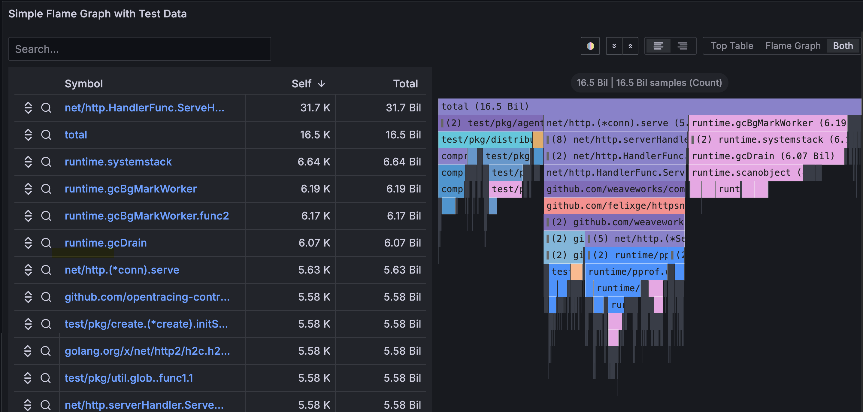

Visualization picker
You can choose to show only the flame graph, only table, or both at the same time
